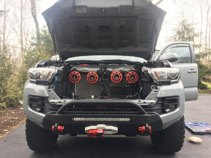

    What horns are those? They look like hellas but wrong color

    They're Hella super tones. The hella sharp tones are the yellow and blue ones like I have on the subie. The super tones are more powerful, and shouldn't be ran on stock wiring. The sharp tones are more OEM sounding, and can be on stock wiring.

    Question for Mesojdm,did you need to install an extra relay to run 4 horns or were you able to just splice into the existing 2 horn wires? Thanks in advance

    For four horns you need to run a relay since your stock horn wiring can't handle four horns. Depending if you do super or sharp tones, that would range between 168-264 watts, and your stock is only wired to handle 120 watts.
