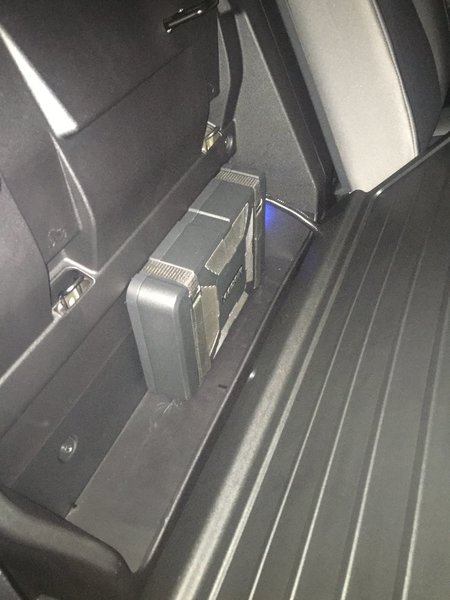

    The unit takes speaker level input so no line out converter needed and it came with like a 16 gauge power wire which is connected to better. Not even close to satisfactory but def better then stock obviously. I didn't post pic cuz I didn't think it was worth posting.

    Why not mount your amp under the seat.

    When I make this move next year to change out speakers an add amp. Imma see about mounting the kicker speaker under the seat.

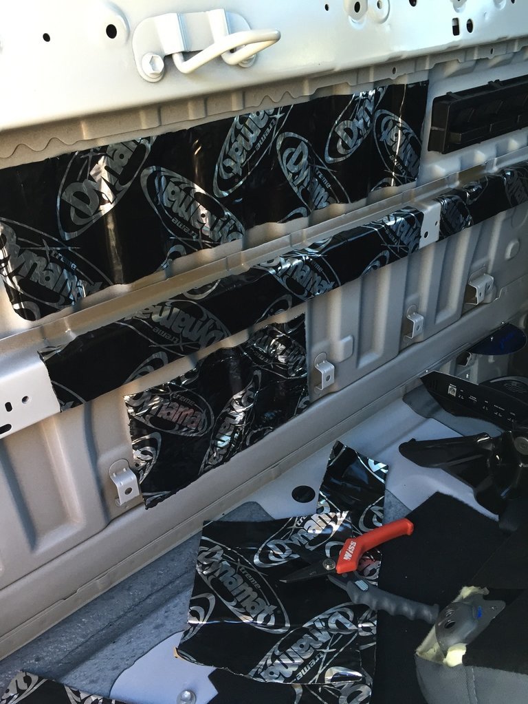

    Started laying down the Dynamat and prepping for the ********* box. There is a change with the back cab wall from 2015 and you can see it on the right side of the picture. There's actually 2 of these long vents on either side. It's a long vent for door closure. I'll be able to fit the box, but it will be in the middle. I drilled out the child seat safety brackets and filled the back wall with Dynamat. Will report back after I get the box and begin the install.
    I'll be upgrading the stock speakers, but holding off until after I finish the sub.

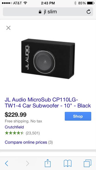

    So you'll need a line out converter. It'll splice into your stock speakers and provide rca output.
    You'll need a mono amp. Probably 300-500 rms. and a power kit to wire to the battery. 8 gauge should suffice.
    Last but not least the subwoofer itself. You'll need a slim box design to put behind the seat. Some people modify for more space to install larger set up but imma just buy one that fits and throw it in the back.
    Picture below is an example of what I may get.

    You should spend around $250+ for amp. $200+ for sub/box. $50 for good power kit for decent sound.
    I generally go with Rockford fosgate or kicker becuase they sound good and are cheap.
