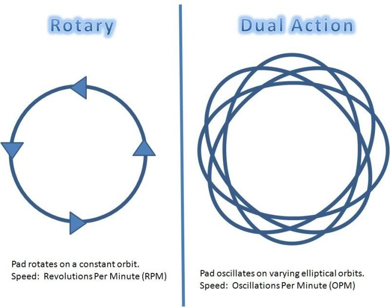

    holograms are when a buffer leaves thousands of super fine circular scratches so close together that they actually leave a holographic effect that changes with the reflection and lighting. they are also called buffer trails. you have to be careful with a rotary because it's constantly spinning in one direction and if the polishing action isn't fine enough during your final polishing step you'll end up with the images in the paint. a dual action buffer resists instilling such defects because it polishes over itself constantly using different directions.
    here is an image that shows the difference of how the two operate, albeit in a very simplified manner -
    a common place to see buffer trails is on medium to dark cars that have come from a dealership, especially a used car that has gone through their high volume detail shop. many times they will use a wool pad on a rotary buffer and a product to remove big scratches and fill in tiny ones. the problem is, that product fills in the tiny scratches the wool pad leaves too, but only temporarily. after a few washes, the fine scratch pattern is revealved and it looks like holograms all over the finish.

    Look at Tony go. I love pics and diagrams. Idiot proof.
    Thanks man.

    Great post!
