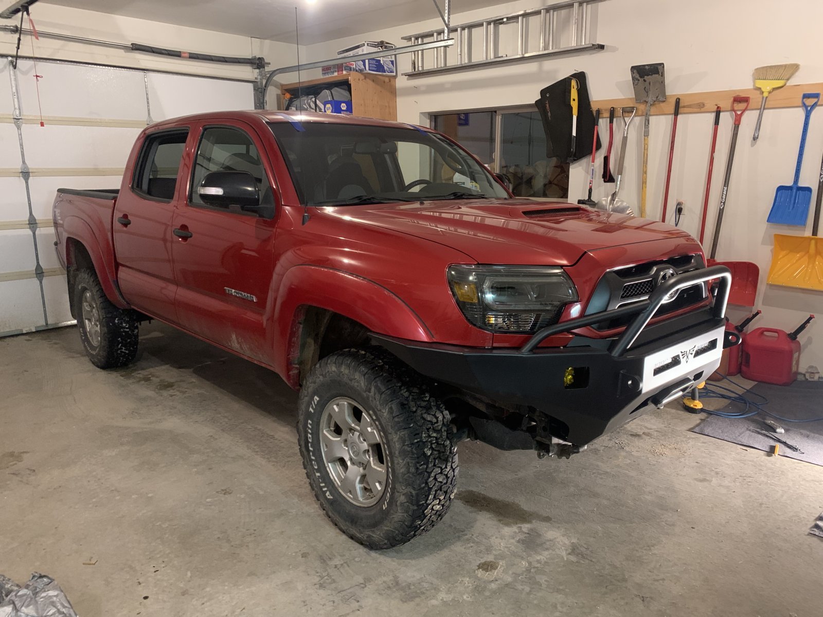

    Has anybody tried paint matching one of the Victory 4x4 bumpers? I'm considering one for my 05 but I'm not a fan of the black bumpers on certain colors including my red:

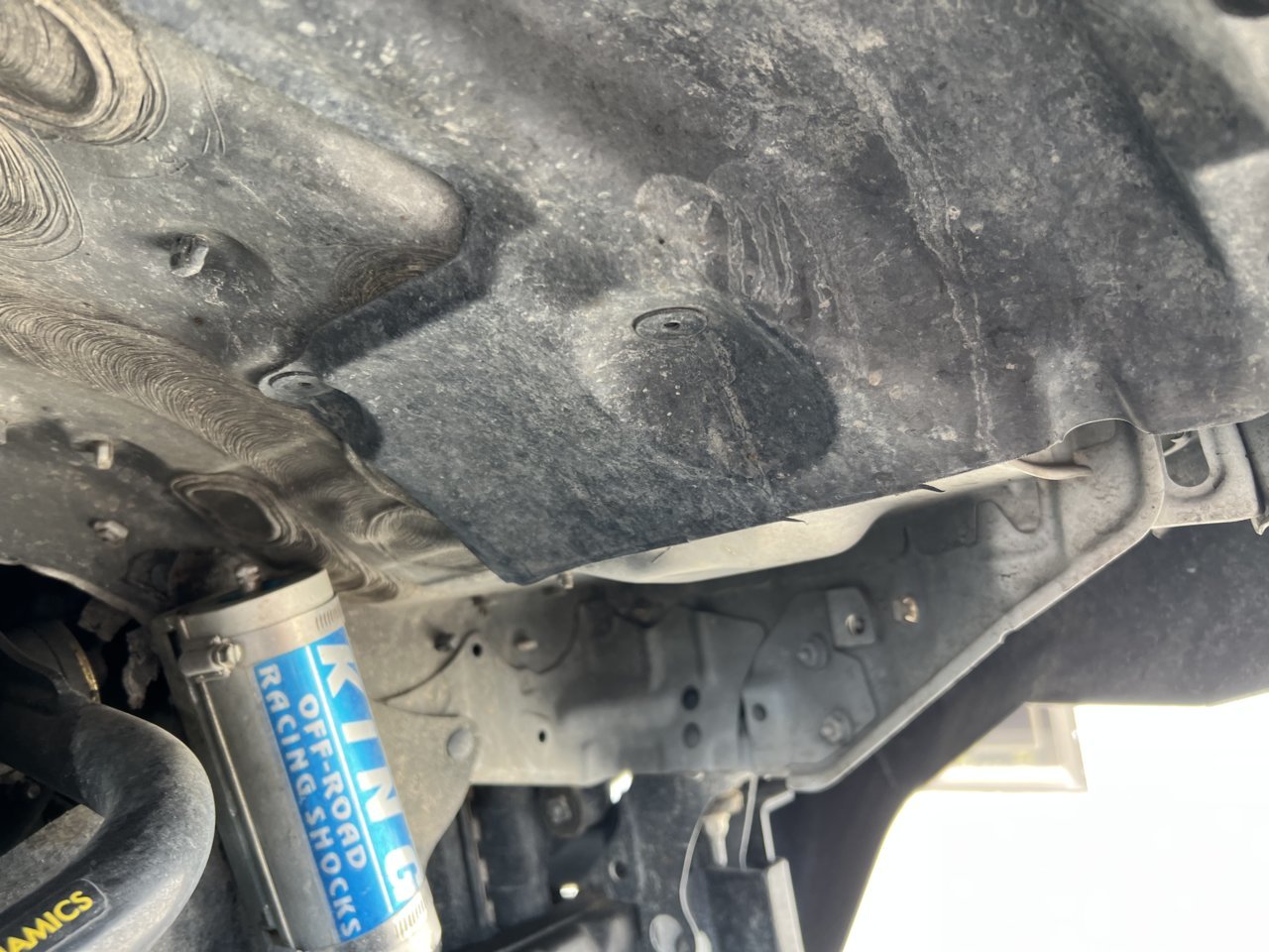

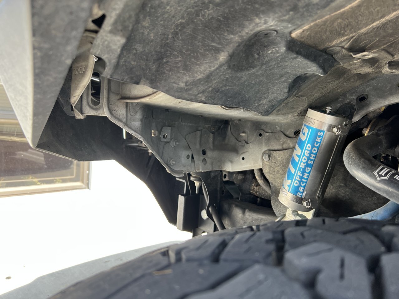

    Getting ready to pull the trigger on this bumper. Can anyone provide some insight and/or photos of what they did with the plastic inner fender.
  3. Aug 3, 2022 at 10:00 AM
    #43
    TacoTuesday94
    TacoTuesday94 Well-Known Member
    Jul 26, 2017
    #225061
    253
    Ry
    Huntington Beach CA
    Supercharged 4.0 2010
    I just took some scissors and chopped it. Easy peasy.
  4. Aug 3, 2022 at 10:04 AM
    #44
    Camby
    Camby Well-Known Member
    Sep 10, 2015
    #163939
    506
    Brian
    Denver
    2006 Tacoma TRD Off-Road
    Magnuson Supercharger TRD CAI Catch Can After market dual exhaust Heated Mirror Kit Install Aftermarket Head and Tail lights Several accessory Mods
    And then what? Does the end just hang there unsupported?
  5. Aug 3, 2022 at 10:33 AM
    #45
    TacoTuesday94
    Jul 26, 2017
    #225061
    253
    Ry
    Huntington Beach CA
    Correct, there’s some factory retaining clips that kind of hold the liner near the top where you chop it. So that’s essentially what supports it. You just need to make sure the liner is short enough to not catch the wind. The first time I hopped on the freeway after installing my bumper, I left one side a little too long and it got caught in the wind, causing the liner to rub slightly on the tire. I pulled over, cut about another inch or two off and it was all good. Haven’t had any issues, even at 90+mph since.

    Here’s some photos of either side to give you a visual of what I mean.
    Camby[QUOTED] likes this.
  7. Aug 3, 2022 at 10:54 AM
    #47
    Camby
    Sep 10, 2015
    #163939
    506
    Brian
    Denver
    Thank you! This helps
    TacoTuesday94[QUOTED] likes this.

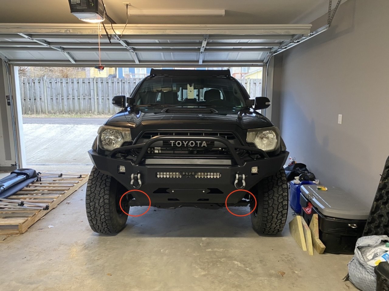

    You'll also have these little factory bumper extensions sticking out (circled in red) when you do your install. This is from a post by another TW member. These can just be unbolted and knocked out with a hammer to get a cleaner look. Best of luck! 65160D76-3E62-490A-982C-5D1D53F90A3C.jpg

    There is also a company that sells a plate to fit in place of those extensions. Ill try and find them and post here
    EDIT**. https://www.kaizendirt.com/product-page/kaizen-frame-cap

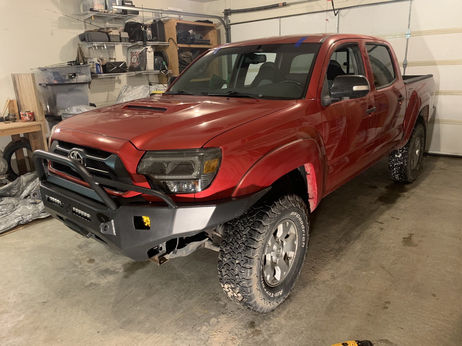

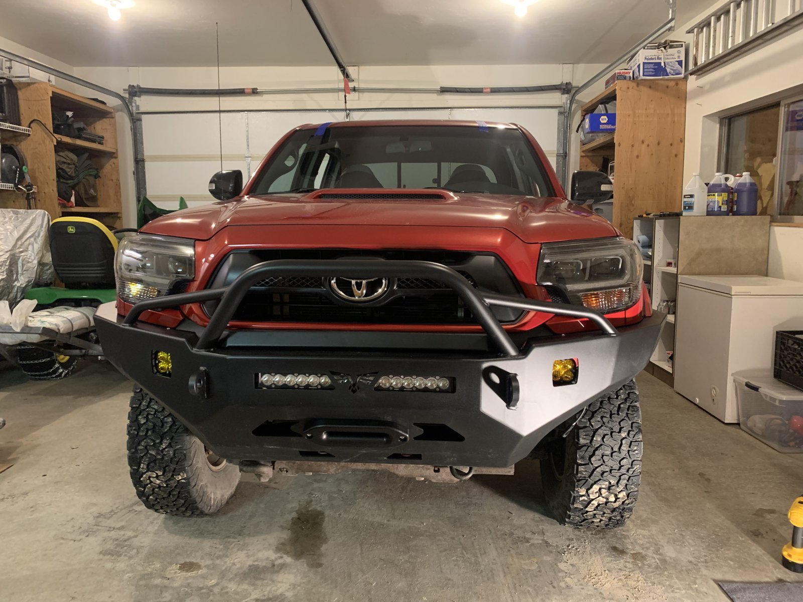

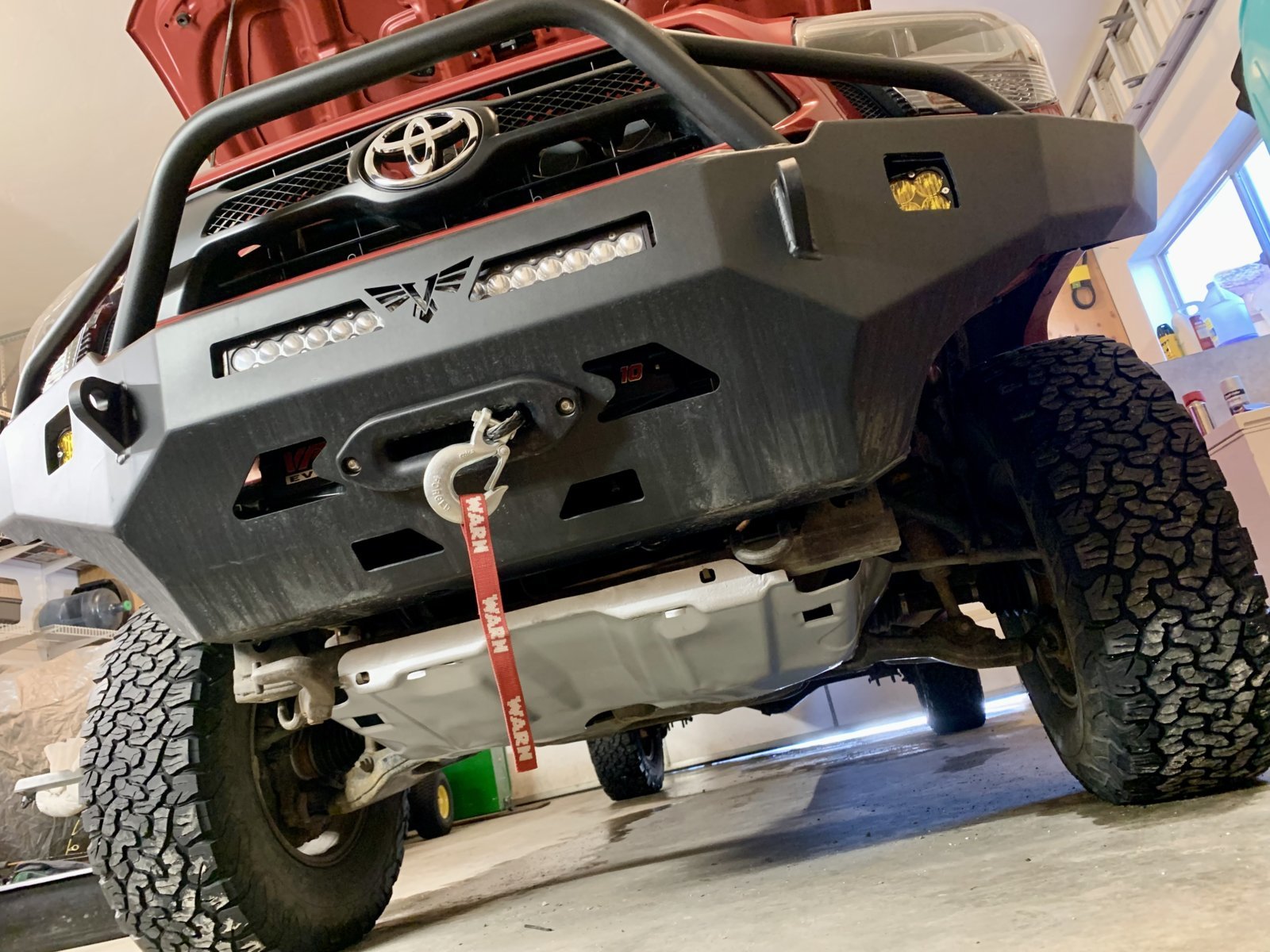

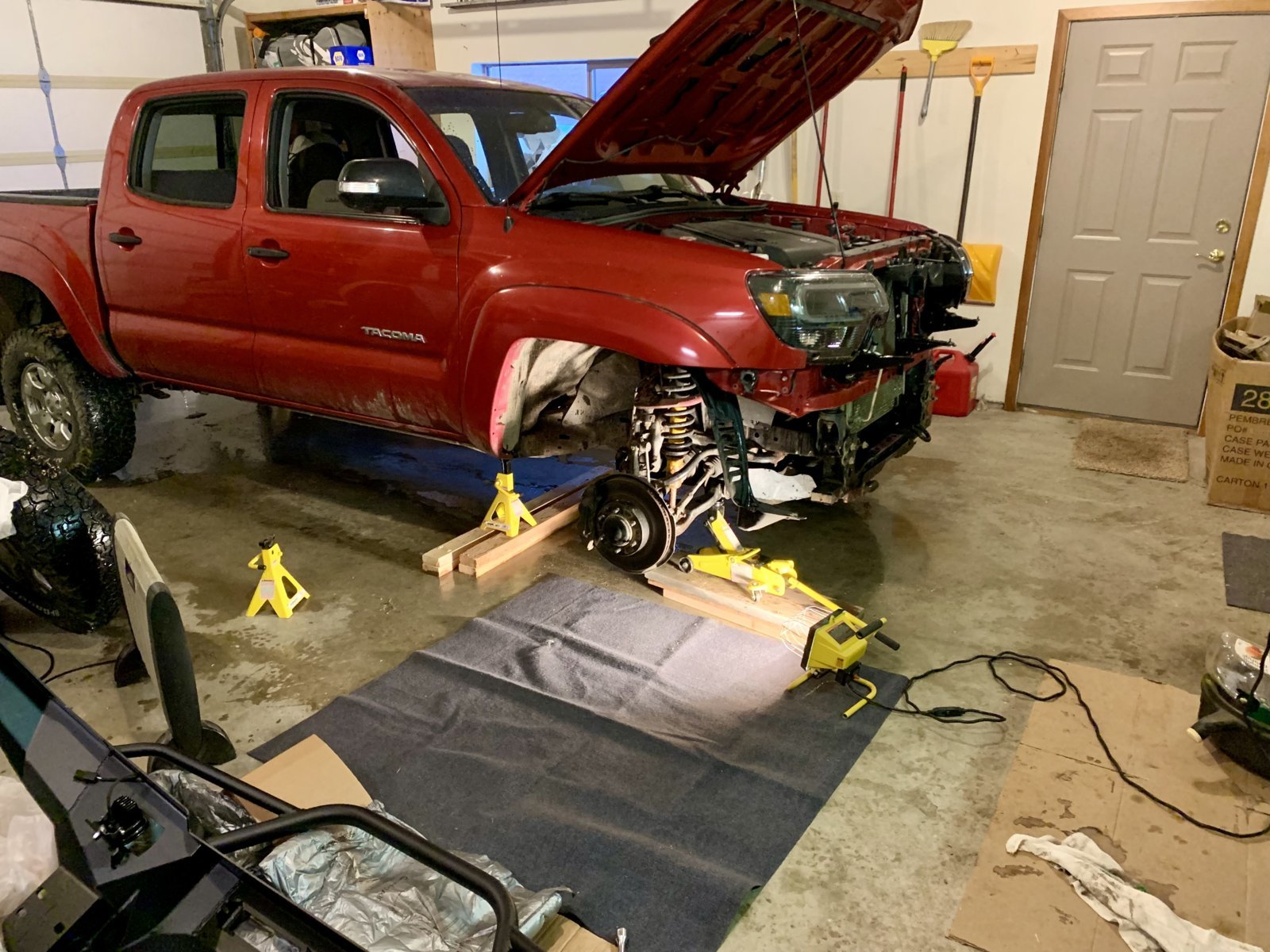

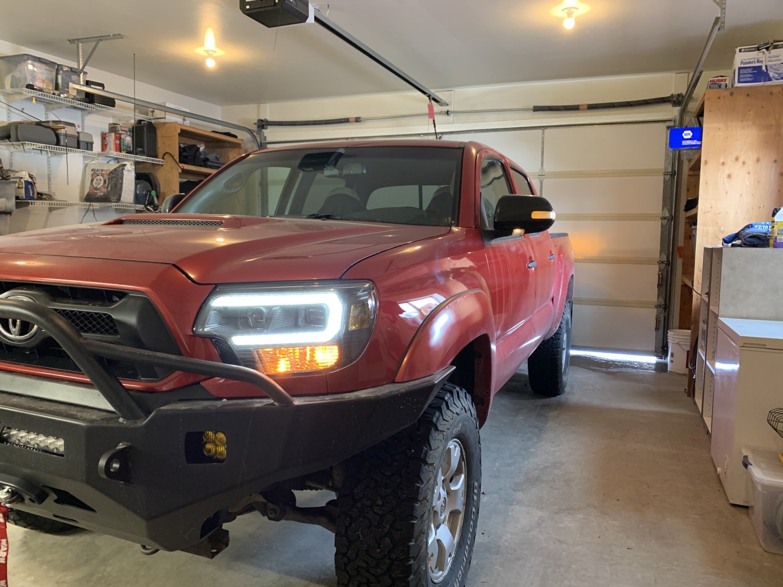

    I know you posted this years ago, but I'm going to post a few pictures of my Barcelona Red 2009 from my phone right now.
  14. Feb 28, 2024 at 12:48 PM
    #54
    Skawdee
    Skawdee SKOL Vikings!
    Aug 11, 2015
    #161553
    91
    Star Valley, Wyoming
    2009 Tacoma TRD-Offroad, 6-spd Man.
    Old Man Emu 2.5” Full Suspension Lift w/ Wheeler's Off-Road Progressive Leaf Pack JBA Upper Control Arms Moog Lower Control Arms Victory4x4 Strike Front Bumper w/ Grill Tubing Morimoto XB Headlights Baja Designs Squadron Sport Amber Fog LED’s Baja Designs 20” White LED Light Bar Over-sized BFG All-Terrain Tires K&N Stock Replacement Air Filter Pioneer AVIC-W8400 Head Unit Apple TV Wireless Phone Charging Pad Bed rail mounting with ax, shovel, MaxTrax Bed Extender

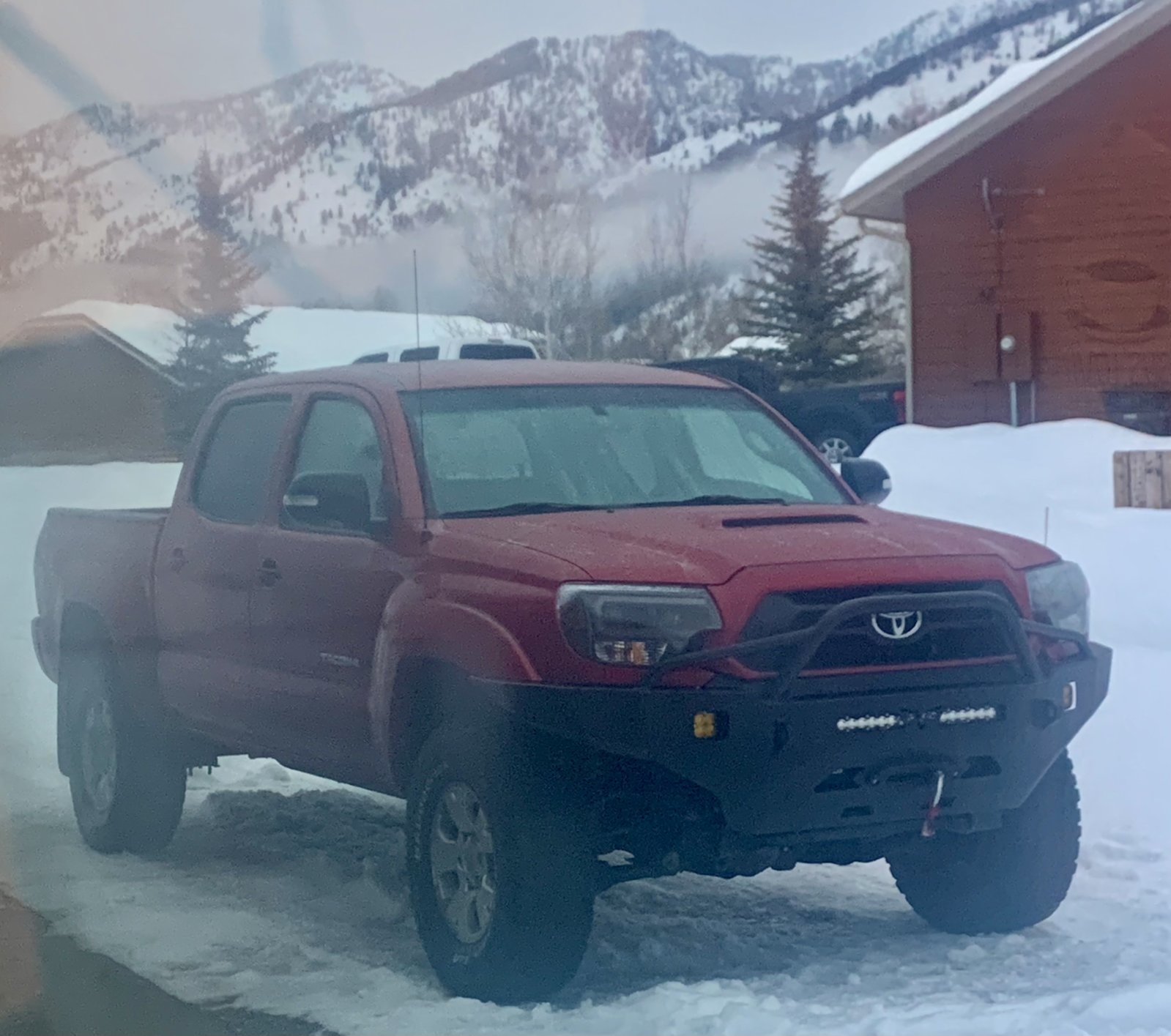

    Some pix for your viewing pleasure
    IMG_9430.jpg IMG_9429.jpg IMG_9428.jpg IMG_9508.jpg IMG_9605.jpg IMG_9675.jpg

    Can you tell me what lights you used? Just ordered my bumper, looking at what lights fit best without breaking the bank
  16. Mar 26, 2024 at 10:16 AM
    #56
    Skawdee
    Aug 11, 2015
    #161553
    91
    The bumper is designed for Baja Design. I used the 20” S8 bar and Amber Squadron fogs. Also updated the headlights with Morimoto LEDs.
