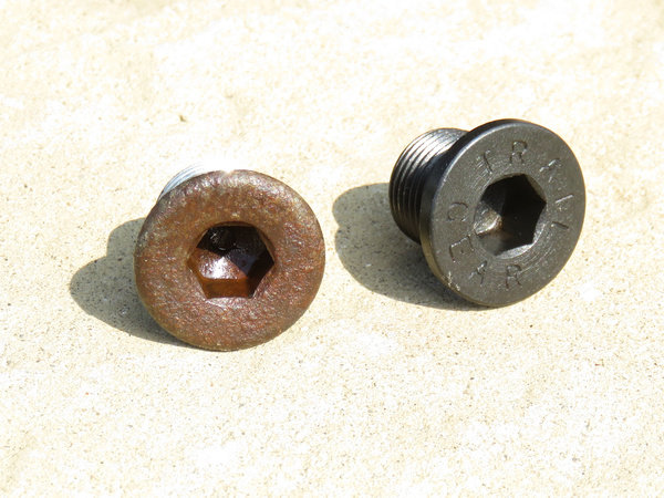

    ^In that case just get the Gold Plug because it's stainless. The Allen drive plugs require more care because they can rust (like OE) and the Allen socket can strip.
    Mine after five winters. I've decided to replace it with a new one:

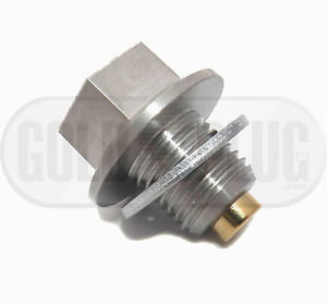

    Yea I know, after looking at the Gold Plugs link and saw those price's.
    So far it looks like the Gold Plugs are a much better deal but the real issue I have with them though is that square plug.
    At least for the one they offer for my year Tacoma.

    Well not exactly the entire plug being square but the part where one screws and unscrews (attaches the tool) the plug itself into and from the oil pan.
    This is what the website shows for my year Tacoma (2008)
    So if you go to the website ( http://goldplug.com/#plugfinder ) and start off by selecting the 2008 year, Pre-Runner, V6, then follow through, you'll then see what I mean about square.
    EDIT: Well that is "if" the square plug has a "hex" insertion for using a hex tool for removal and installation. But the picture doesn't show that?
    The more I look at it though, it could be that just the angle of the position that the picture was taken of it could just give the appearance that it looks square but probably is just a normal nut.
