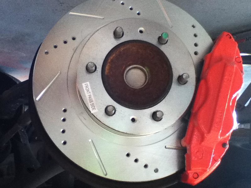

    i painted my calipers with rustoleum engine paint. nice!
