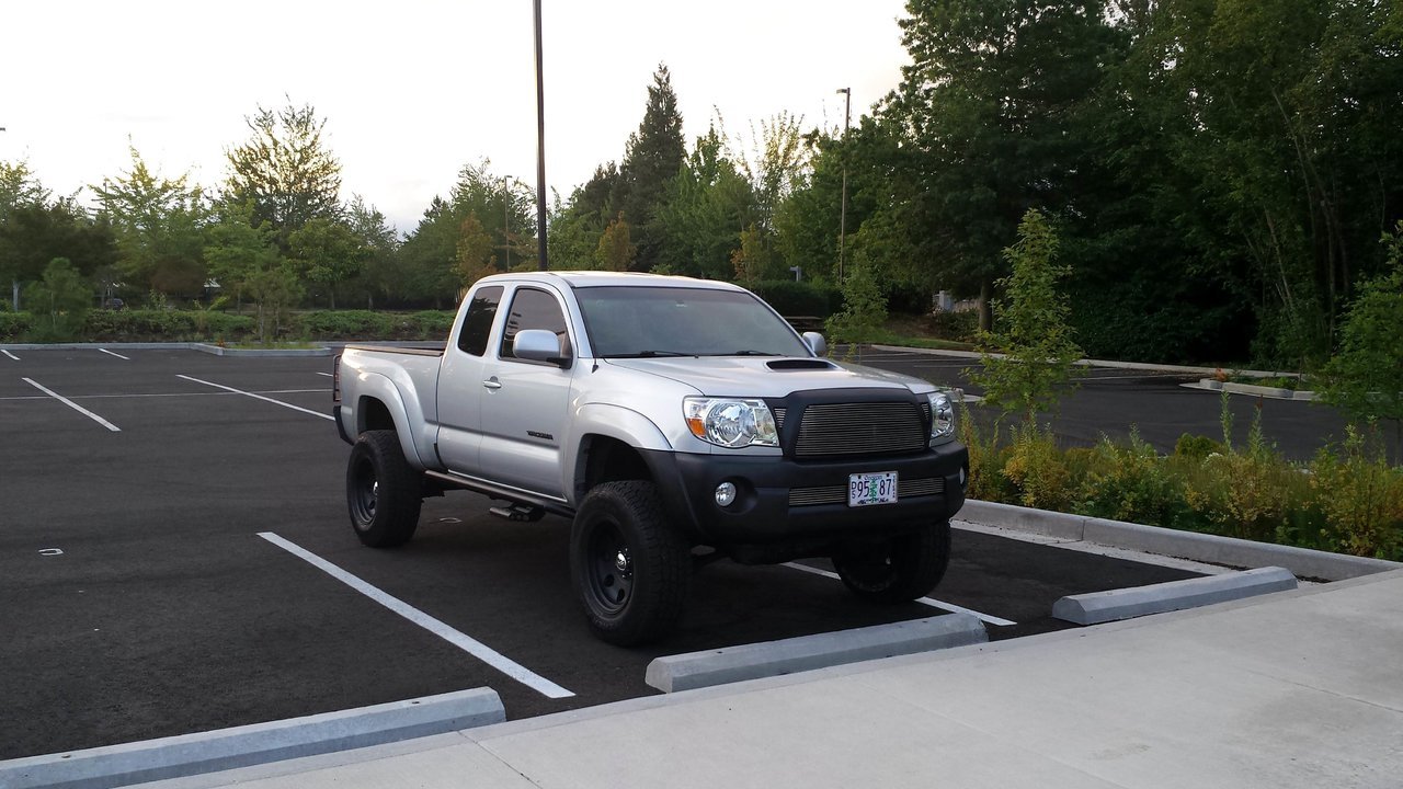

    That is spray on bedliner on the front bumper and the factory stock surround on the grill.

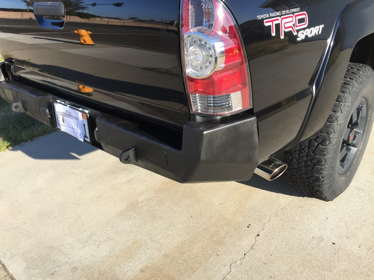

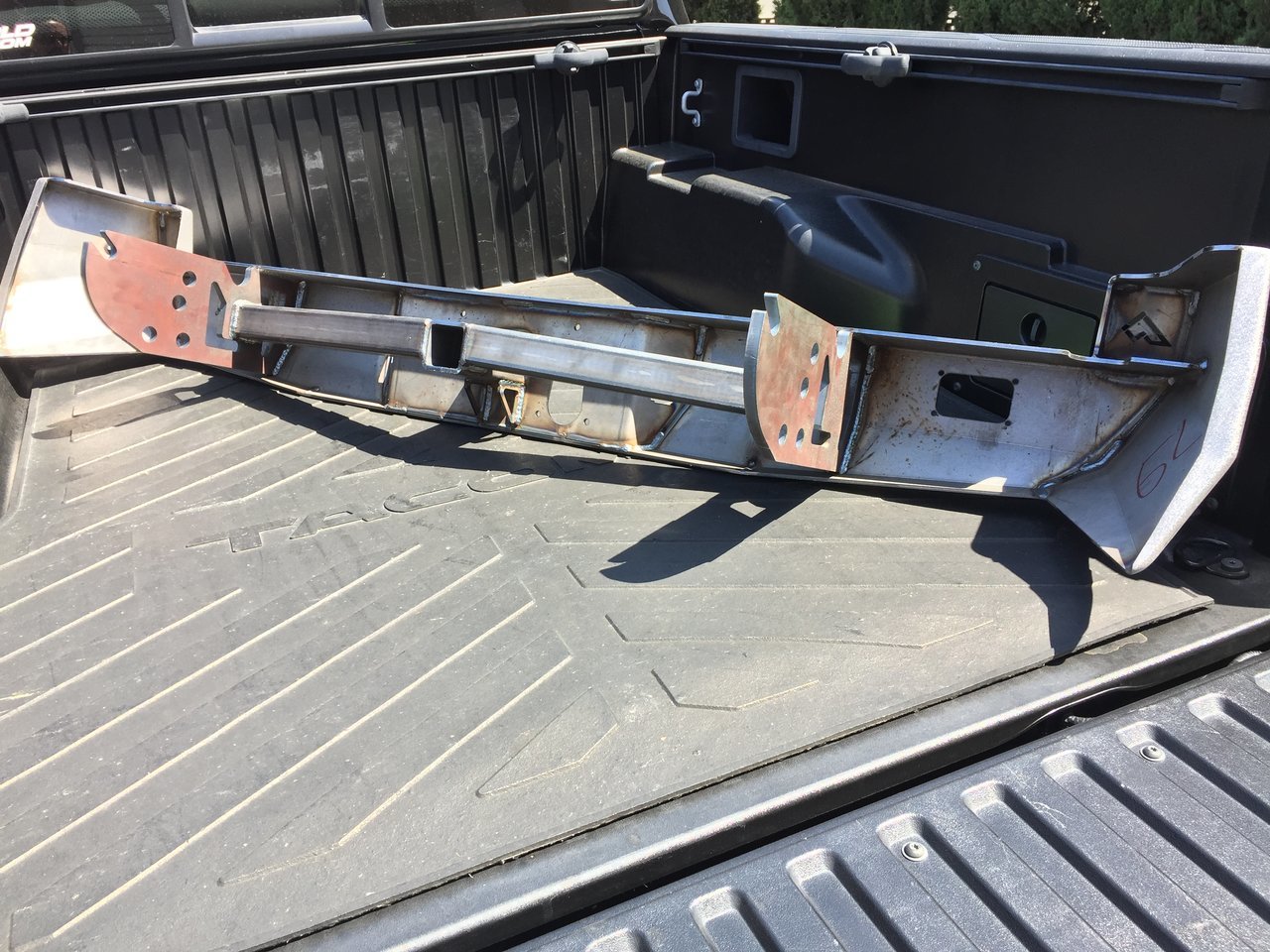

    Rust-Oleum"Truck Bed Coating/Bed Liner"rattle can.:thumbsup:Recently done my Pelfrey rear bumper and have done my Pelfrey sliders and skids in the past.
    2 spray cans of self etching primer,2 spray cans of black primer and complete with 2 spray cans of Bed liner.No sanding required and holds up great.:thumbsup:Easy to touch up as well.All products i've used are Rust-Oleum.:thumbsup:IMG_5191.jpg IMG_5315.jpg
