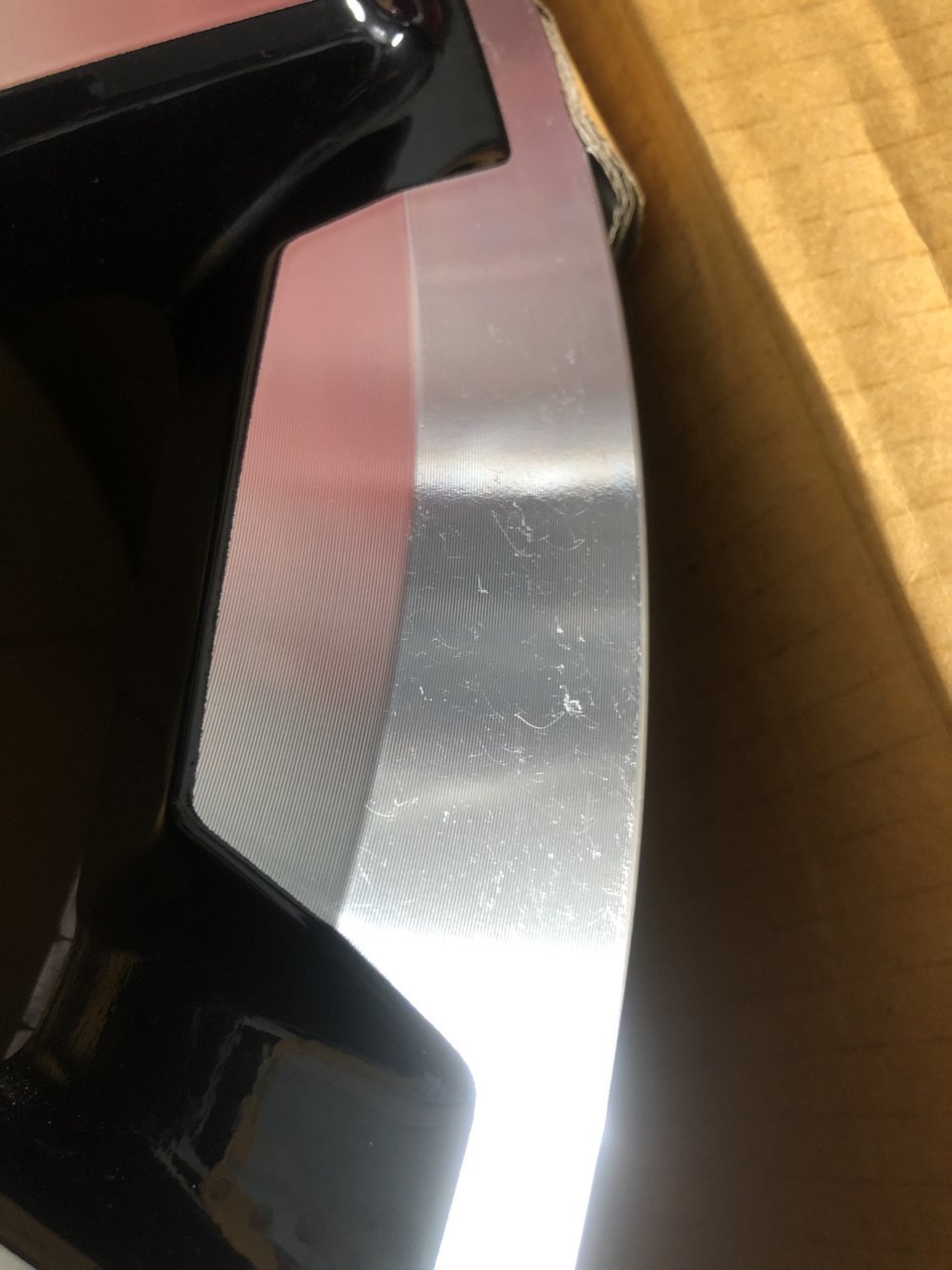

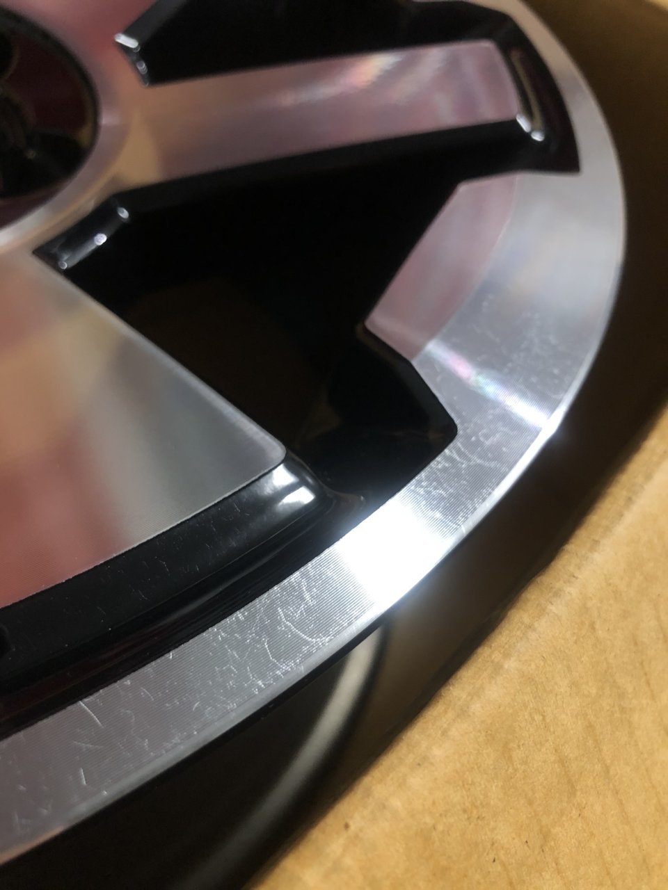

    Any advise on cleaning up the machined finish on the lip?
    It was similar to a tw express situation. They were listed as new takeoffs 0 miles no scratches and 0 miles maybe true but no scratches not so much (pictures are similar across all 4 wheels).

    Also anyone know if the machined lip/finish is coated or raw?

    coated

    Wanted to thank you for clarifying and add to my story.
    since finding out they are coated I could find the best, I could research, method on removing the scratches around the rim/lip. Treat it same as paint/cc. I started with some simple meguiars ultimate polish which did help but wasn’t quite abrasive enough. I also wasn’t doing the traditional circular motion of application. Since the lip/raw silver color is machined leaving that lined effect I rubbed with the grain. I then picked a pretty bad spot after the polish and went over it will the ultimate compound and I’d say it removed 99% of the remaining scratches. I need to get better hand applicators before I continue but at least I know now with a little bit of work they will be almost like new. Was even thinking if I should buy the professional grade compound/polish (the meg mirror stuff)?
    after seeing a f/s post here of wheels and the picture had a foam protector sheet for the face (in the trd box) I come to the theory these were more than likely new no scratches 0 miles. But when the foam sheet wasn’t saved to protect the face on these and boxed up and moved around on top of each other exchanging hands before getting to me the cardboard was just rubbing the lip (which is the highest point on these wheels) also if I’m not mistaken the trd wheels are x7 not x7.5 right? which would make these boxes technically slightly small. All of that can easily explain the current condition- so moral is save your foam sheet protectors

    4runner trails are 7.5" wide. the scratches are probably barely noticeable from afar, I bet....it bothers you because you know it's there (i have the same issue). Hand application usually just fills in the scratches with product and will likely show again after a few washes. if you really want to get the scratches out, you'll need a machine, which comes with it's own inherent risks (burning the coating, for one).

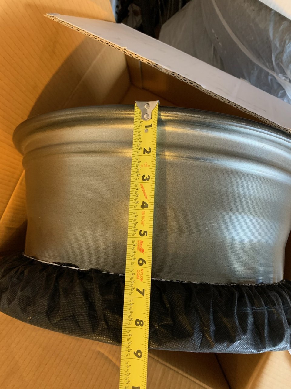

    I know the t4r are 7.5 I was thinking the pro wheels that came in the box originally was possibly 7 which explains smaller box and then my theory on the cause of the scratches- completely over analyzed this
    from a few feet away i couldn’t see them but your right I know they are there so it bothers me. I sure hope it’s not just filling in the scratches, it does look good after so hopefully it’s not just lip stick. That’s the reason I was doing by hand because I didn’t want to risk more harm with a machine. Once I get them finished by hand I’ll make the appointment to get installed and be revisiting this thread with results

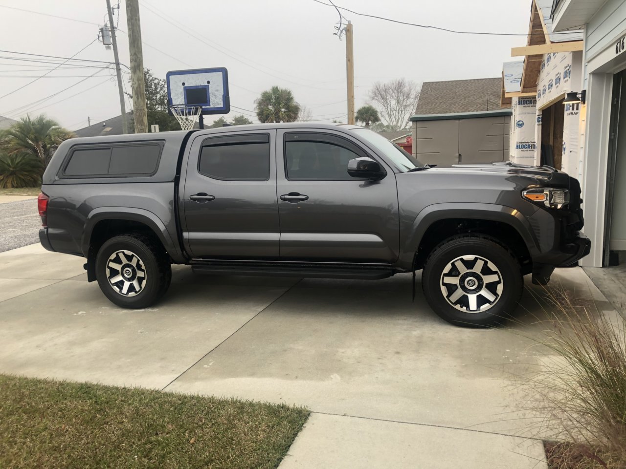

    Finished compound/polish of all the machined finish and definitely got 99% of it out (can’t even tell) just hope it lasts :fingerscrossed: @the_dau i did wash it once just today with meguiars plus because when I went to get them installed the guy I trust wasn’t working like I was told so I asked SA who’s the next he would trust (don’t trust the next in line FYI) I inspected the wheels and sure shit there are now scratches again (and yes they are new). It wasn’t nearly as bad as before or when they damaged my stock sports wheels (enough for them the replace all 4). So I said f it and I’ll do the compound/polish again. There is 1 spot that got scratched on the black paint but it’s only about a 1/4 or less. Still I should of left and rescheduled when the other guy was working. So I washed them up real good to get a better look and I should be able to get the new scratches removed… and again hope they aren’t just filling in since I am doing it by hand.
    didn’t realize how bright they are (compared to the stock sports). Definitely going to dip the lip gloss black to match the bLack there, leave the spokes for now and eventually dip the spokes this brass monkey bronze to see how it looks.
    I was worried about too much poke with this wider wheel from stock and the 1.25 spacers but it doesn’t look like much more than it was before. Picture taken at angle for effect- it really doesn’t stick out much from the fender, I personally don’t like a drastic poke (makes it look like a toy truck whereas a lil poke has that bulldog stance)
