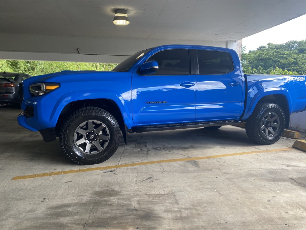

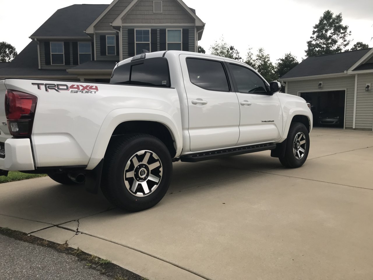

    Painted them Veloster matte gray and removed the chrome ring

    Looks awesome! Removing the chrome ring does a lot for these wheels!

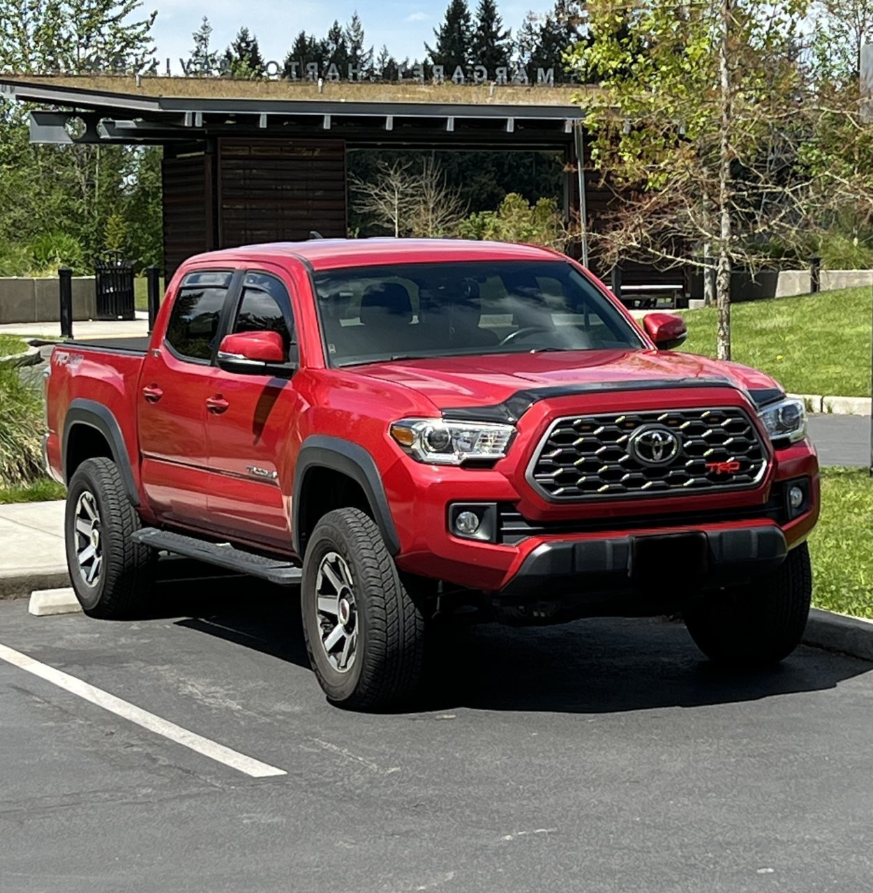

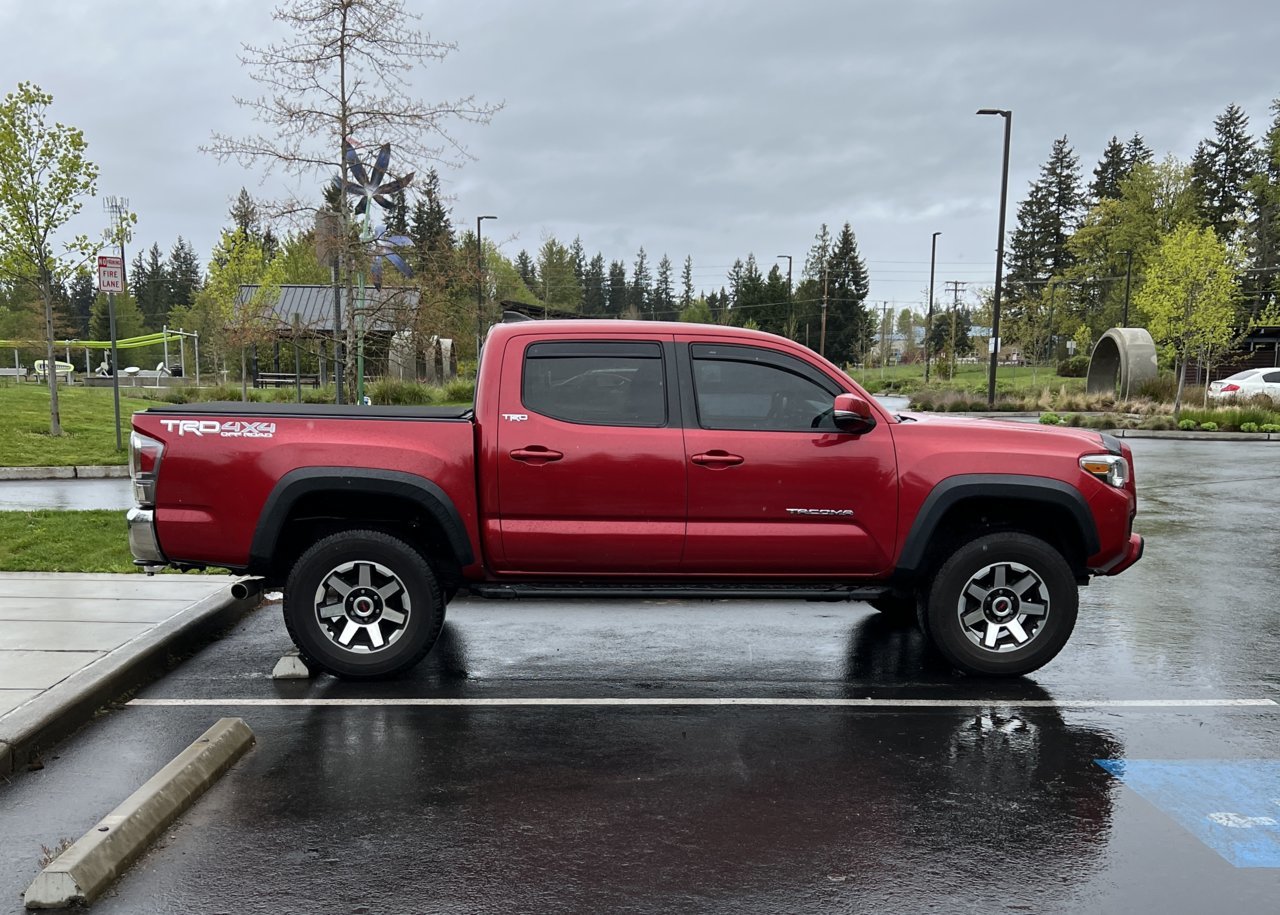

    Are those the stock grandtreks?
  10. Oct 26, 2022 at 8:44 AM
    #630
    stevetacoman
    stevetacoman Active Member
    Aug 8, 2020
    #337017
    39
    Steve
    Washington State
    2018 TRD Off-road, 4x4 3.5L, 6AT, DCSB, Barcelona Red Metallic
    Yes they are. It does good in all weather conditions for me but anxiously waiting for them to wear so I can get something a little more aggressive.

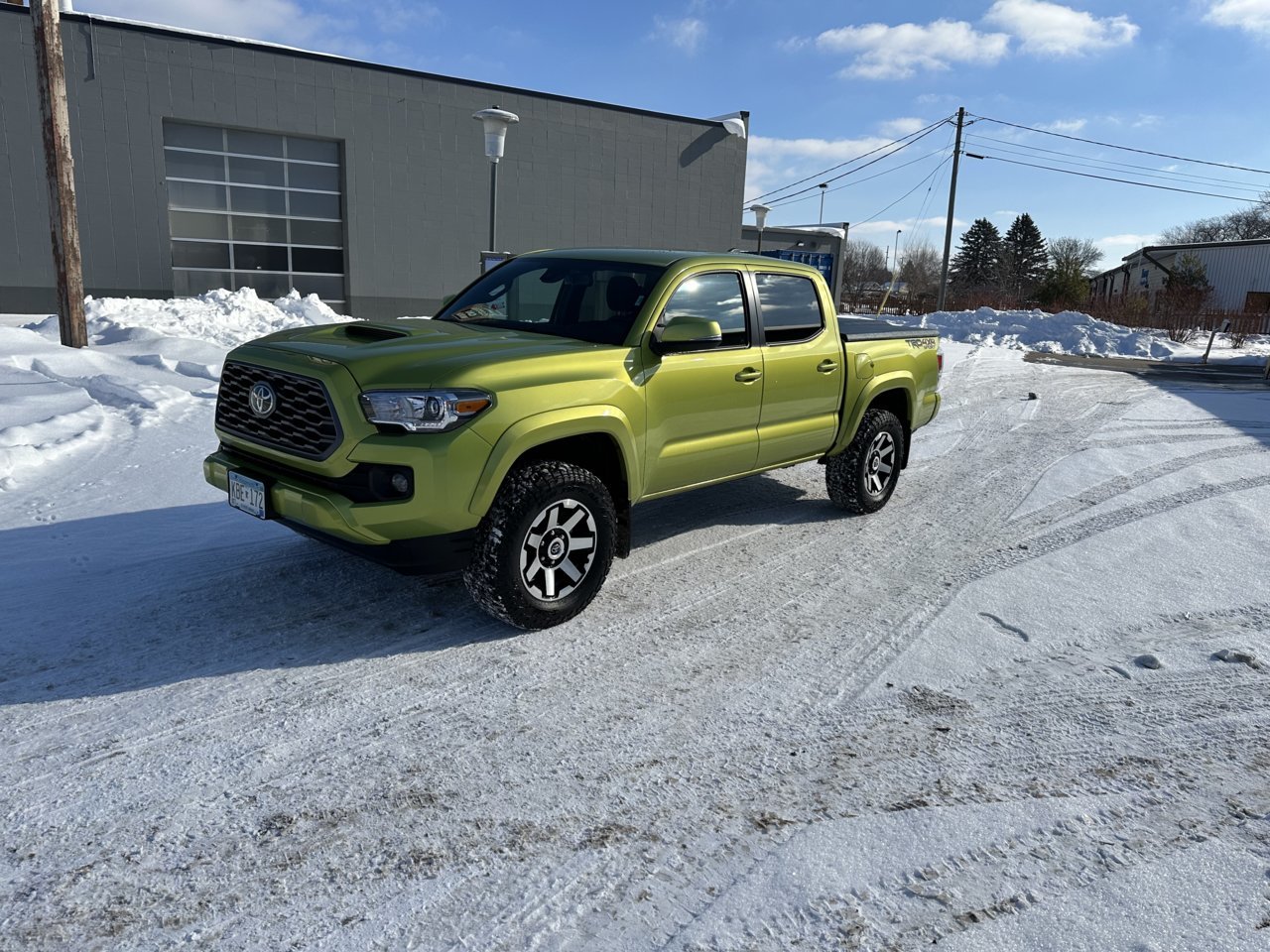

    Just put falken wildpeak AT tires and the trail wheels. It’s flashy now haha. May powder cost them darker someday but love the stance and wheel shape!

    Nice! Looks great

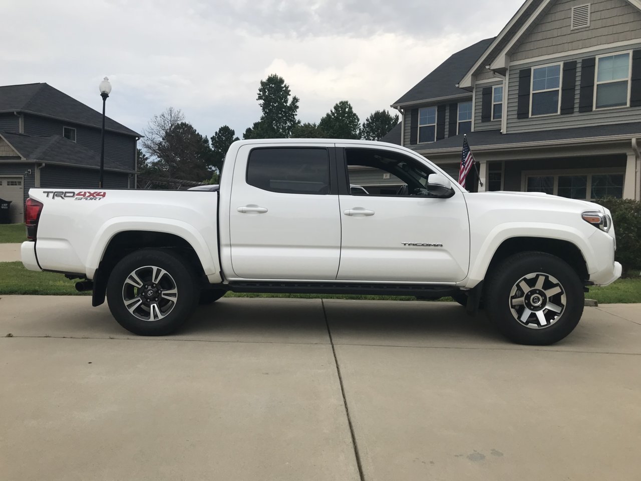

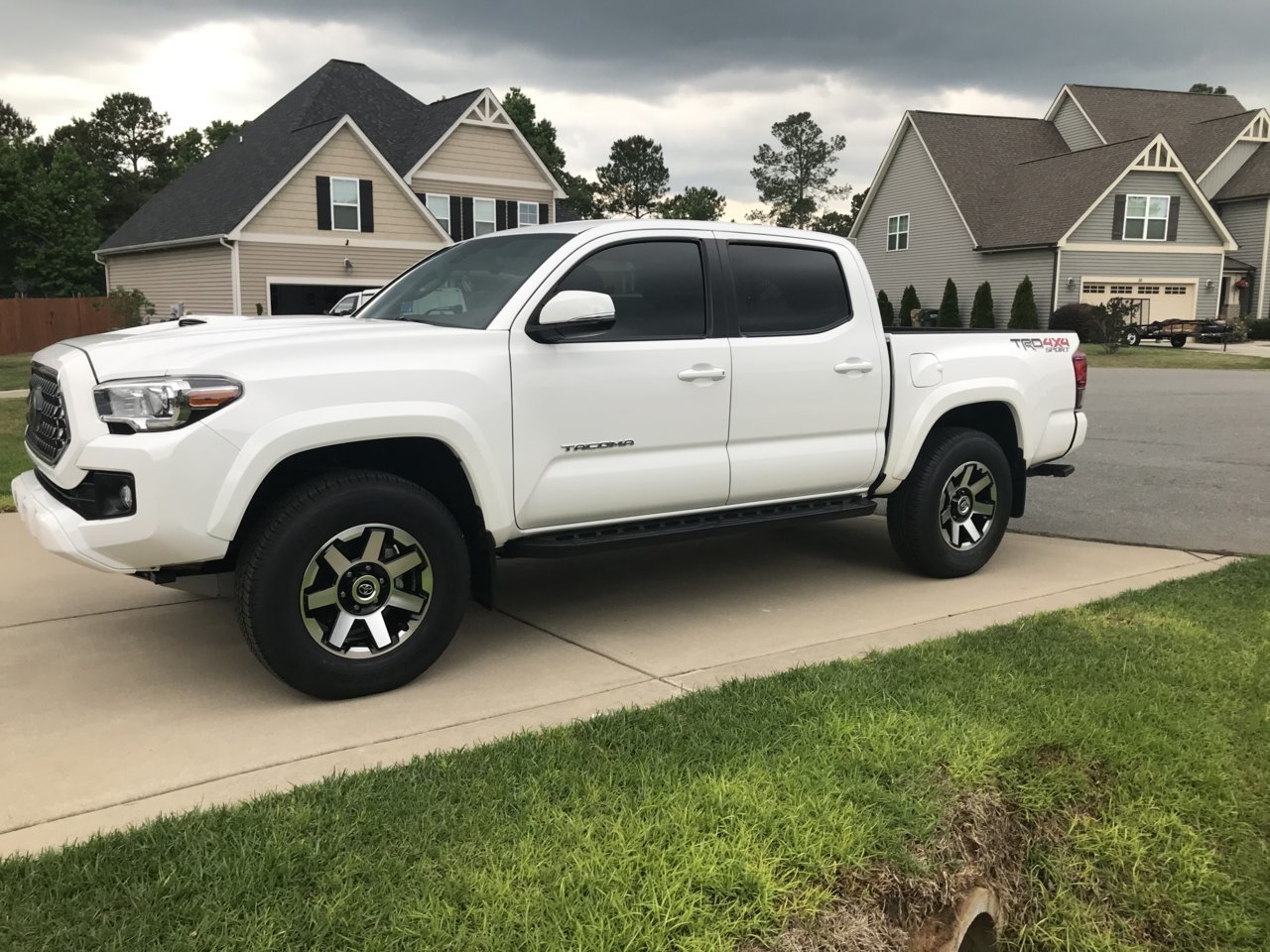

    I didn’t know I needed these until now. Thanks for the comparison photo! :spending:

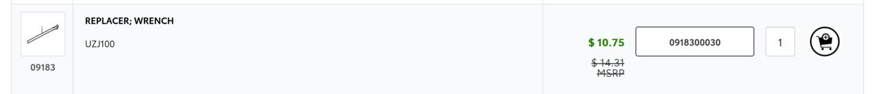

    I ordered the tool. Part # 09183-00030
    The 4Runner lug nuts are taller so I found a spacer to put between the lug and pry tool.

    I didn’t have an issue putting trail wheels from a 2022 on my 18 Taco. Only mini problem was the lug nuts on my sport wheels must be slightly bigger in diameter because they rub the center caps when screwing on so I had got the T4R center cap pry wrench. Taco lugs are also shorter so I found a spacer to use between the lug and pry wrench
    Wrench. Part # 09183-00030

    I ordered the tool also…it was only $10 and found the center caps easily pop off without it. Wheels got mounted no issues using same lugs being used for my sport wheels. Happy with end result except dealership scuffed up the wheels with some marks…it is what it is
