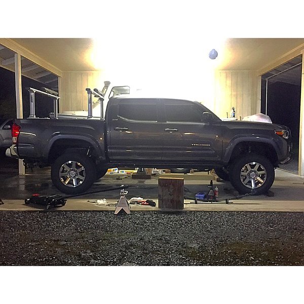

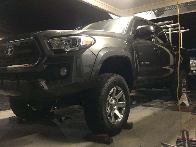

    Finally lifted.
    OME 888, HS spacer for taco lean, full OME deaver pack. Bilstein 5100 front, 5100 extended rear. Ordered all thru Headstrong. I live in Hawaii and had wonderful service, and very happy with the outcome and products. There's other stuff with the kit too but you can check that on their website.
    Stock measurements: ~21 front / 21.5 rear
    After measurements: ~ 24.25 front / 25 rear
    No vibes and rides like a dream (compared to my 1st gen with Toytec coilovers and All pro expedition pack)
    Tires are 265/70/17 on trails. I hope you enjoy it as much as I do. Better pics to follow, finished late and work tomorrow

    oh this is nice did you go with 3rd gen 5100 for the front? can you measure it once the suspension has settled?

    Thanks. Sure, I barely drive it but give me a while and I'll report back.
    Yes, 3rd gen 5100's. What I've noticed is the 3rd gen shocks come with 5, yes FIVE clips for settin the spring. My truck is on 0.
    Not sure if the 2nd gen have that much adjustablity but my 1st gen sure didn't...

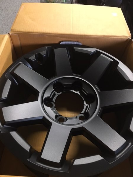

    Trail-rim.jpg I had a set powdercoated satin black now I just to mount them on something. lol

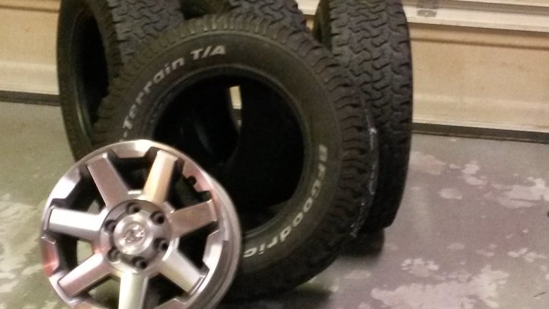

    Mounting my summer set tomorrow

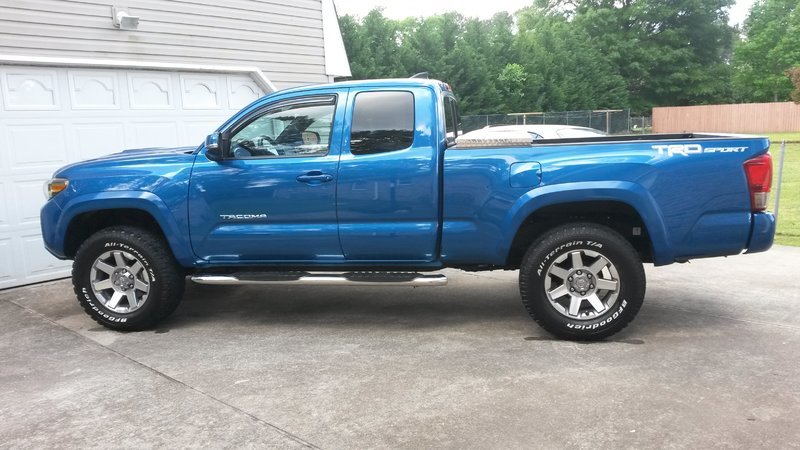

    Installed today and like the look

    Looks nice. Stock size tires?

    265/70/17

    Is the suspension stock?

    Yes stock 2 wheel drive

    Any rubbing with the 265's???
    Truck looks very nice. I have the same rims on my runner. Toyota should be ashamed of themselves for the 3rd gen Sport wheels. The 4Runner wheels are MUCH better looking.

    Zero rub and tons of clearance. The wheels are only 7.5 wide with 15 offset. Just removed 8 wide wheels with 10 offset same size tire also plenty of clearance.

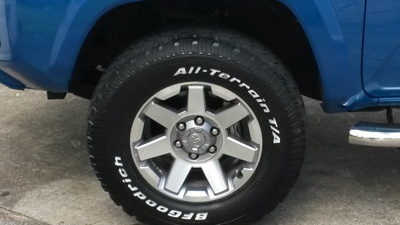

    No problem at all with 265/70r17 BFG T/A tires on mine with stock rear wheel drive suspension. That tire is bigger than an all season radial tire too. Do it and you will not regret it. Look how much clearance I have on the front tire. Should not be that much money. Use your existing tpms sensors and the tires are $825 now at 4wheelparts. Take to Walmart and mount and balance for $10 per tire. I have a great guy at WM and they have all new mounting machines.
