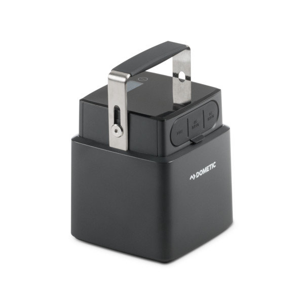

    We're curious if anyone is using one of our PLB40s in their Tacoma?
    If so, can you share some photos, and what you think of it so far?
    We'd welcome your feedback on ease of use, what you are using to power with it, problems you might have had, thoughts on product improvements for the future, etc. :thumbsup:
