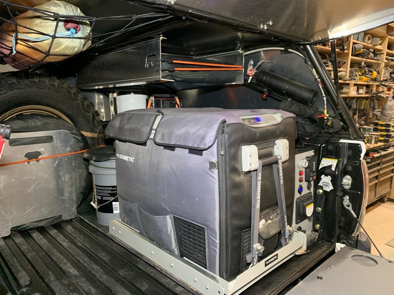

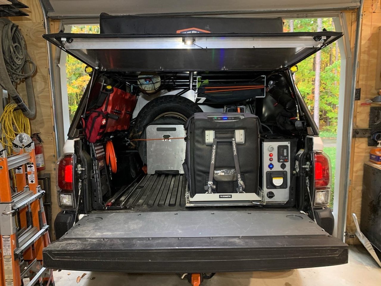

    @Dometic Here is my setup in my Tacoma (Follow New Holland Overland for more content with photos of the setup).
    I have the PLB40 hooked up to my CFX65, powered off of an aux Odyssey Group 35 which connects to a Redarc BCDC1225 and a 100W panel.
    One big thing ive struggled with the PLB40 is mounting it inside the back, I currently used some small straps which hold it ok...but in a month or so ill be creating some aluminum brackets that will tie into the existing handle mounts to give it a permanent home in the back. Another big area that the PLB40 struggles is cold weather (I dont run the fridge in the winter), but I do run accessories and lights off of the battery and warming it up to get it to turn on is difficult somedays. But other than those items its an amazing battery! Ive ran the fridge off the battery for over 50 hours a couple of times and its held up fantastic throughout the last year ive used it.

    That's a great looking build!
    As for winter use of the PLB40, cold definitely impacts most batteries. If you could remote mount it in your cab (given that your cab stays warmer longer) it would help as would insulating the battery in some type of blanket.
    Thanks for using both our PLB40 and CFX65!
