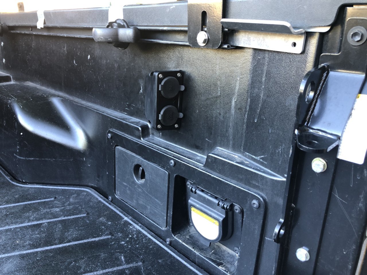

    So apparently the bed outlet while driving is 120v/100w will this be sufficient?

    The PLB40 doesn't have a built-in inverter to support 120v to 12v. That said you can use an inverter to do this.
    The most common case, and what is supported out of the box, is to use the 12v connector in your cab to connect up the PLB40 while driving to charge it. :thumbsup:

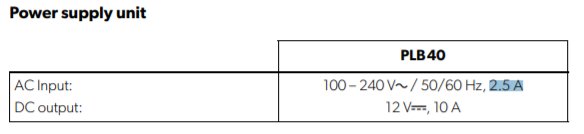

    According to the manual it draws 2.5A AC, or 300 watts, so 100 watts wouldn't be sufficient.

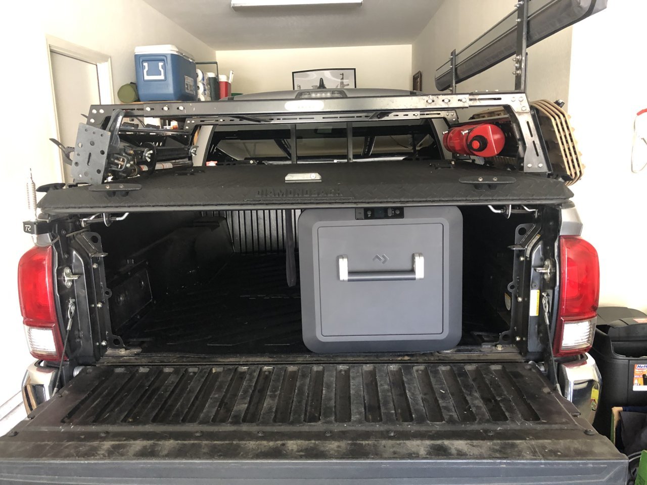

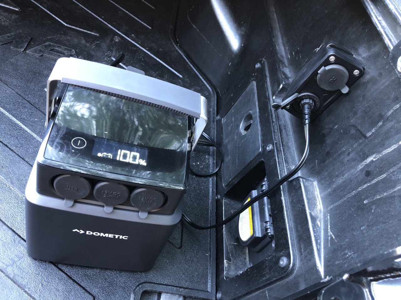

    I recently got a CFX3 55IM and a PLB40. I've been thinking about it for a long time but didn't want to spend the $$$$. Then REI had a 20% sale + my rei dividend and stimulus check made it a pretty good deal.
    I first put it in the back seat but then moved it in the bed. I did one trip where I had the battery in the back seat plugged into 12v then ran a cord through windows into the bed for the fridge. This was a little messy and temporary. I bought the dometic hardwire kit but haven't installed yet.
    Should I wire the new kit directly to the truck battery? This would mean constant power being drawn even when the engine is off? So then when I get to camp or parked for a long time I would need to unplug the battery from the dometic 12v port in the bed of the truck?

    yea the PLB40 charges off the alternator after you install the DC hardwire kit from dometic. After you stop it will continue to drain the car battery so I unplug the PLB40 at that point. If I’m over landing and driving the next day I plug the PLB40 back into the DC connector and charge it again with my alternator. If I’m camping I just recharge with a 100watt solar panel. Rockpals makes a good one.
