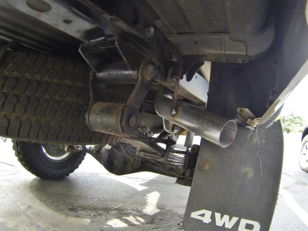

    Yeah having it dump after axle allows you to flex the rear without it being bent by the leaf springs. Some companies have brackets to "fix" that problem but cutting it is easier and offroad wise its one less thing behind the tire to get stuck on stuff.

    or, have the shop do a reroute like this on install
