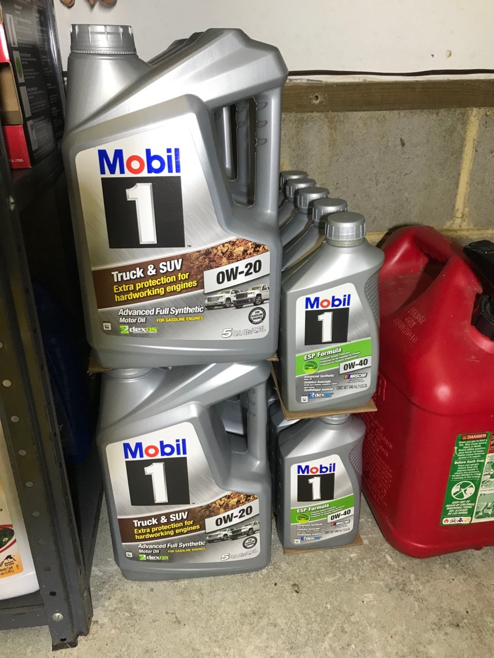

    This is what I use, don't see any reason to change:

    Hm. Never seen that "truck and suv" 0w20 over here. Only seen that "fuel saving" one.
    Kevin Jones[QUOTED] likes this.

    There may be a difference between the two, but I suspect it’s just marketing.

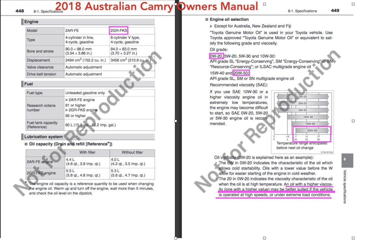

    Toyota publishes oil info for the 3.5L & they say even 10w40 will work in a hot climate.

    Let's see this oil publication.

    Might be referencing this...

  18. Jan 16, 2021 at 6:22 AM
    #58
    SRBenjamin
    SRBenjamin Well-Known Member
    Nov 14, 2019
    #310696
    1,077
    Benny
    Maybe Australian law will not permit Toyota to require a certain type of oil. i don't believe Toyota would recommend a 20/50 oil in any modern engine.
    Can't believe everything you read, at some point common sense is needed.

    I did say operating oil temp, not cold temp.
