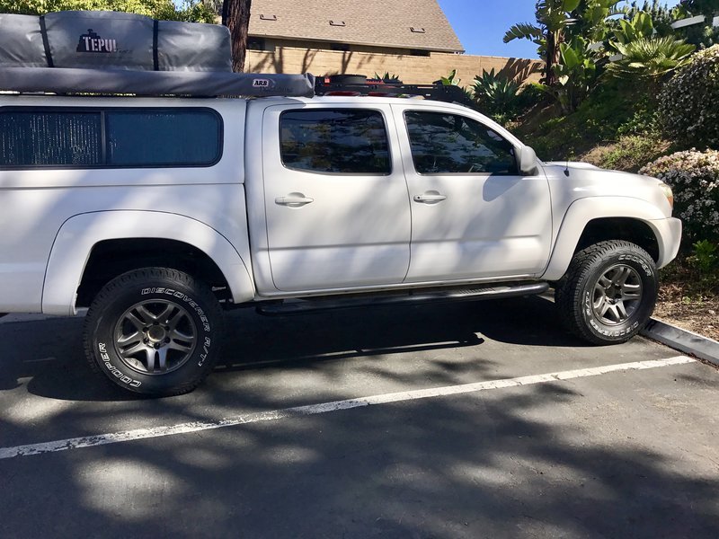

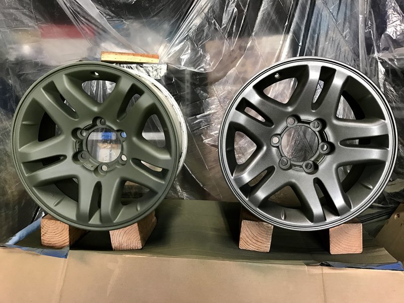

    Here are some I recently got from a Tundra, same wheel. Coopers are 275/70r17. Lift 2.5" OME front & rear, no wheel spacer, but I'm pretty close on the stock UCA when at full lock and flexed. I already had the mud flaps off and a slight trim on the lower inner fender plastic. I have no rubbing. I repainted mine graphite.

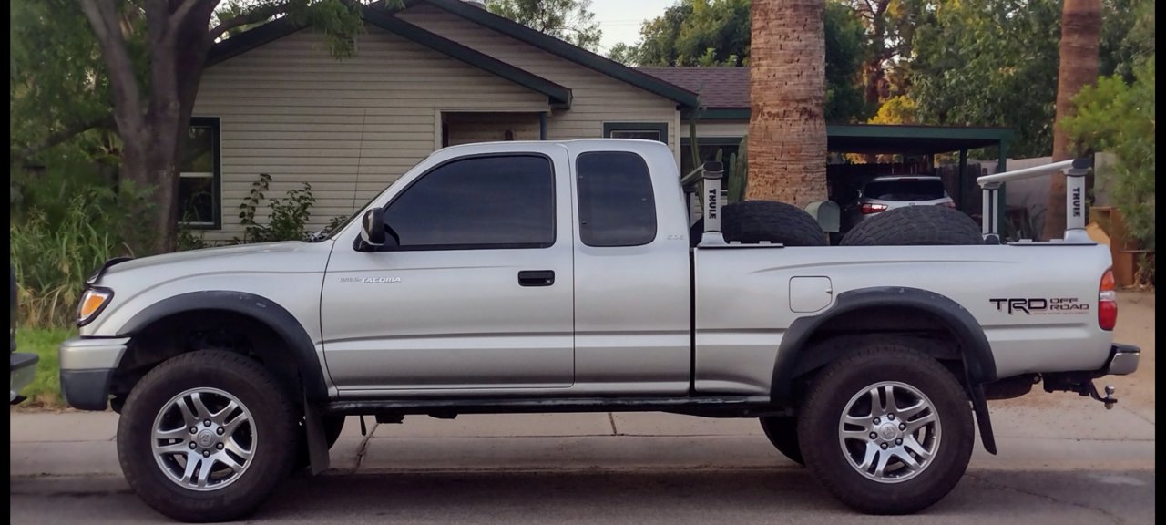

    Frnt and rear ARB lockers Old Man Emu 2.5 lift Frame reinforcments
    They fit on my 1st Gen Tacoma/2.5" lift with no issues. Saw a similar truck online and loved the look. Just found mine on offer up.
