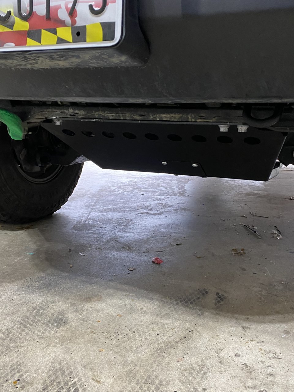

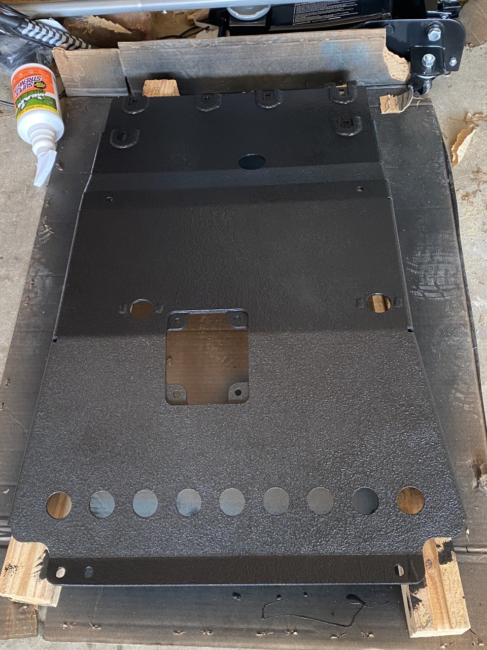

    I took a chance and went with their front skid and have been happy with it so far. I bought raw steel and prepped/painted it myself. I used self etching primer and roll on bedliner on the bottom and spray on bedliner on the inside portion. There was an issue with the first one I bought but they quickly sent a replacement out. Great customer service in that regard.
    I’ve only had it on for a few weeks but I like it. About 50 lbs and has the hole for the oil filter. Now, why did I go with them over RCI? I think I just liked how it looked a little more. The thickness is the same. I think it goes a little farther back then the RCI as well. I don’t think you’ll go wrong with either choice. I spent a few weeks debating it.
