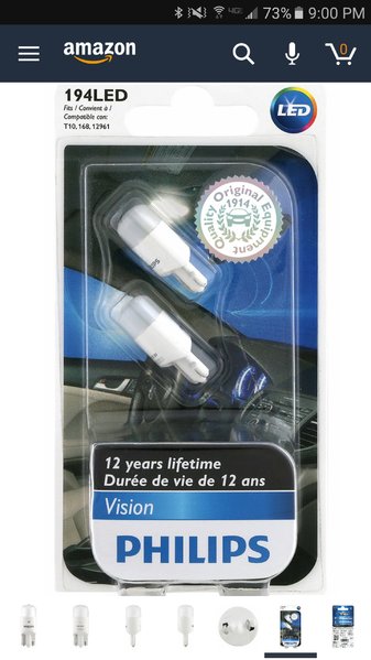

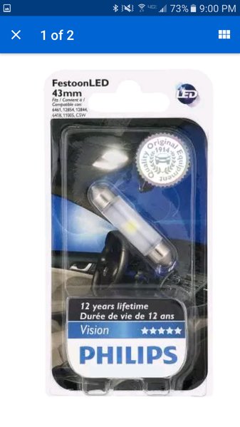

    Thinking about getting these Philips brand interior lights. But the package doesn't say they are error free.
    Is anyone using these? If so, are you getting error message for 'bulb out'?

    The dome light fades on and off just like the stock bulb. No codes for dome or map lights.

    I have yet to see a car that has bulb out error messages for interior bulbs... bulb out messages are for exterior bulbs where you can't easily see that they're out.

    Good point. I guess I was alerted to the notion because Philips on the package states they have a canbus piece sold separate to avoid the error. But perhaps that's just license plate & turn signal use...

    I put the 43mm Phillips led in the dome and it works fine, had a little issue at first installing thing it was a dud but installed it with the power going to show it working in what position. I use the Sirius led I found on Amazon for my map lights and they are way brighter than the dome light.

    I use Philips 168 (same base as 194) for my license and parking lights. Highly recommend. I'd used cheap Chinese junk before and they all flickered/died within weeks. The Philips bulbs have been solid for over a year, noting that there constantly on every time I turn my headlights on.

    I've used both of those. Philips actually makes a festoon that is slightly brighter than the one you posted. Also available on Amazon.
    For the map lights, get the sylvania version of the 168/194. It's brighter than the Philips. Unbelievably bright for map lights.
    They're all fine in our trucks. If they don't work, turn the bulb 180°. They are polarity sensitive. No codes throw.
