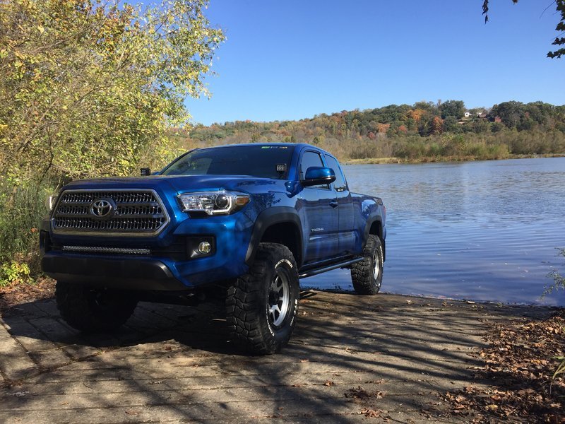

    I'm lifted 3". Part of my setup is 1/2 (or 3/4, can't remember) on both sides. Plus the OME trim packer on drivers.
    Before the lift, I had just the spacers on both sides. Here is a pic or that setup with 265/75-16's

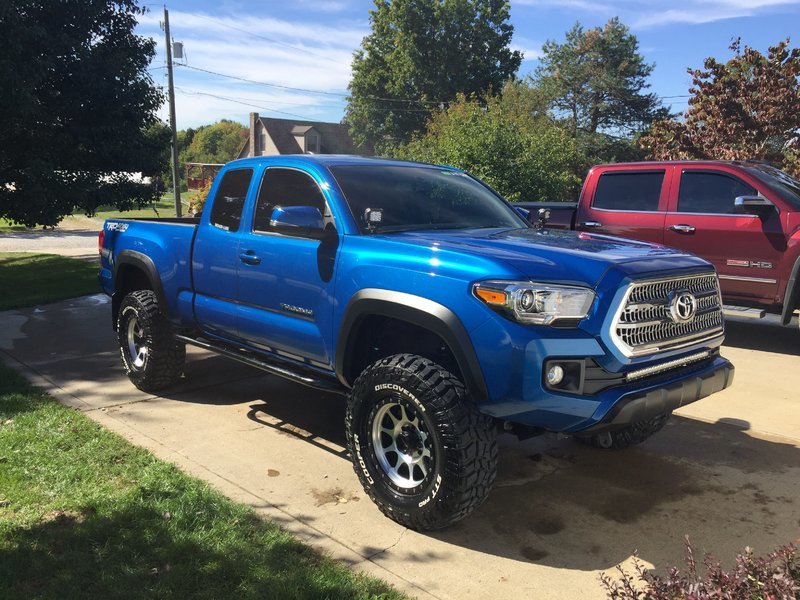

    New Truck taco world.jpg Tacoma new tires 1.jpg Before and after, I am running 5100s front and rear. Using stock OR coils 5100 set .85 with 1/2" spacer driver side, 1/4" spacer passenger side. Nothing in rear except 5100s. Running Goodyear Authority 265x75x16C on sr dark alloy oem wheels. OEM mud guards no rub at all. Check the specs of the stt.max tires, my tire specs are the same as duratracs 31.5 x10.5. Stock rims can also make a difference, I have heard from others on this forum wheel spacers on stock oem wheels can cause rubbing. Hope this helps.

    Thanks, Before measured 21" up front and 22.5" rear from center hub to top fender flare. After was 22.5" all around. We also measured from ground to top of fender flare 37". If I remember right the driver rear was 1/8 " different from the rest, didn't remember if it was +/-. Lift was done before new tires.
