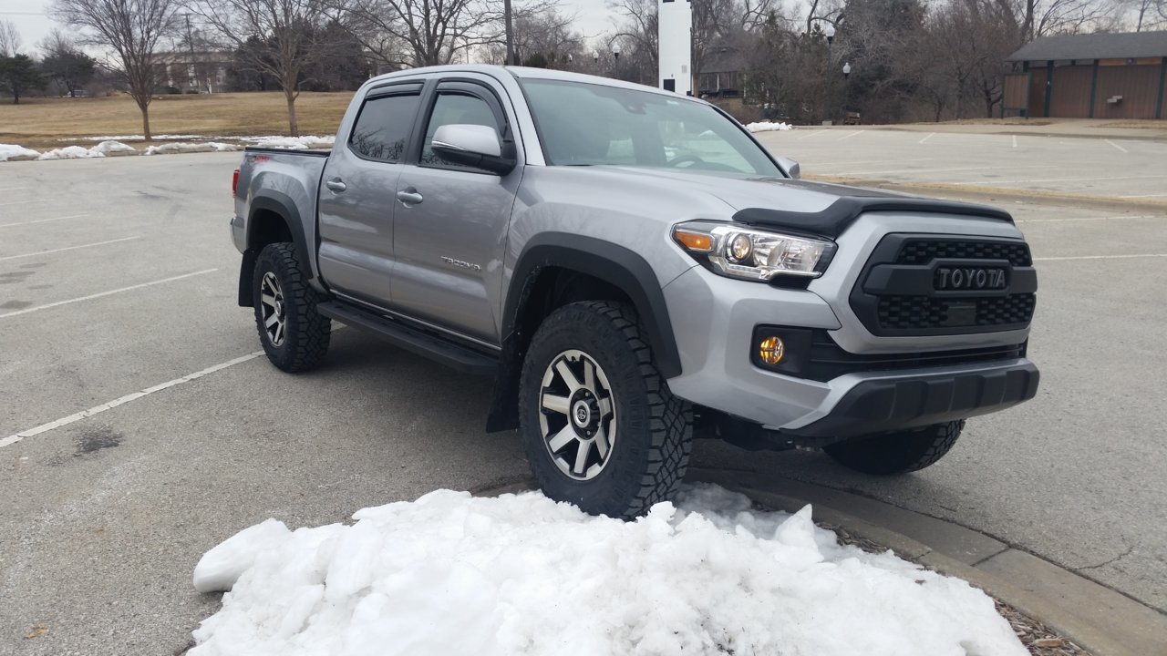

    Duratracs, no lift yet. Only had one minor rub so far. It was turning sharply into a parking lot with a deep gutter about 25 mph. No rub if I keep the speed under control.

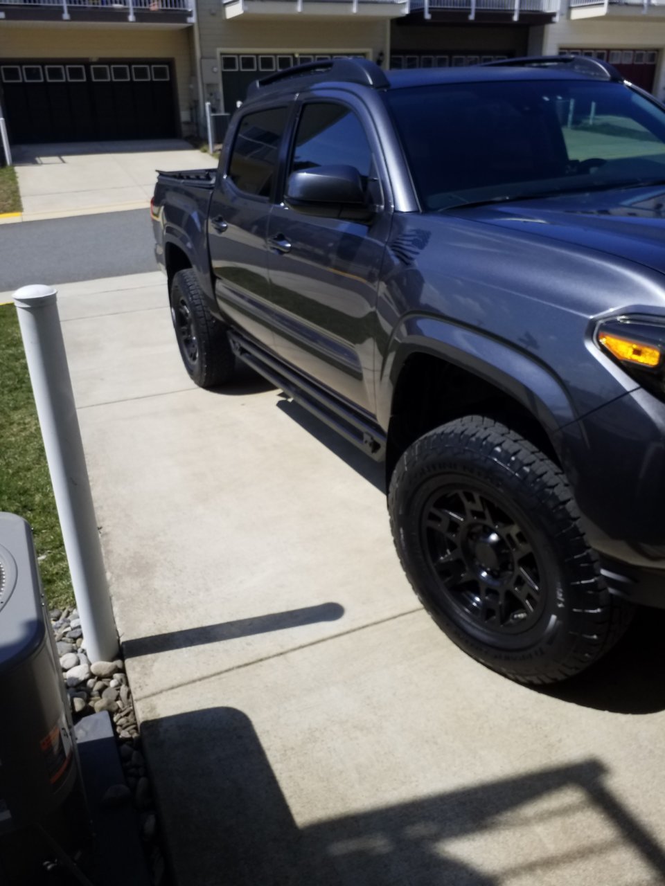

    [​IMG] What Wheel and tire are you running ? Is your truck lifted if so what lift ? I have the same truck and like that set up. Thanks

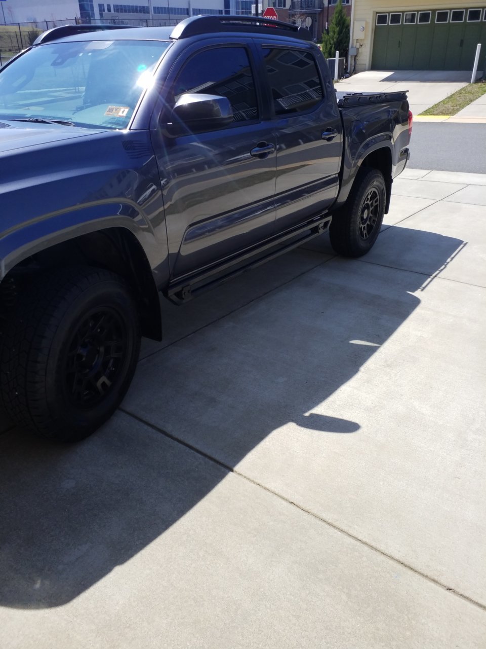

    Continental TerrainContact

    In front, I have OME 888 springs on 5100 shocks set at zero with an ECGS needle bearing replacement bushing, with factory UCA's (I have no alignment issues)with 1/4" spacer on the driver side. In back, 2" blocks, 5100 shocks with a driveline spacer kit. The wheels are Toyota 4 Runner TRD Pro wheels (grey) 17" with 255-75-r17 BFG KO2 tires. No rubbing whatsoever.

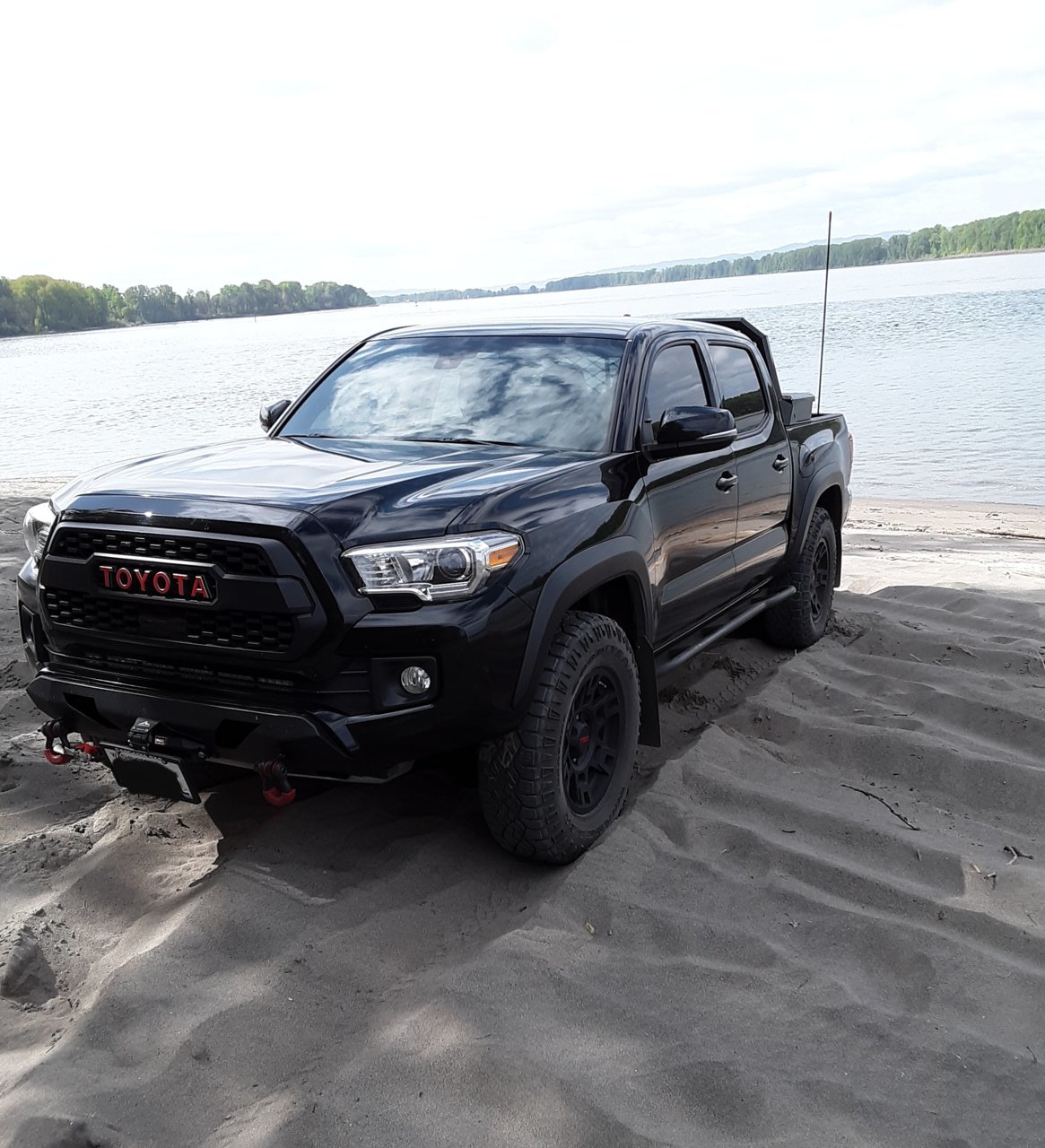

    Still having good luck with my 255/75/17s duratracs. I have over 20k on the tires now. Truck still on all stock suspension.
