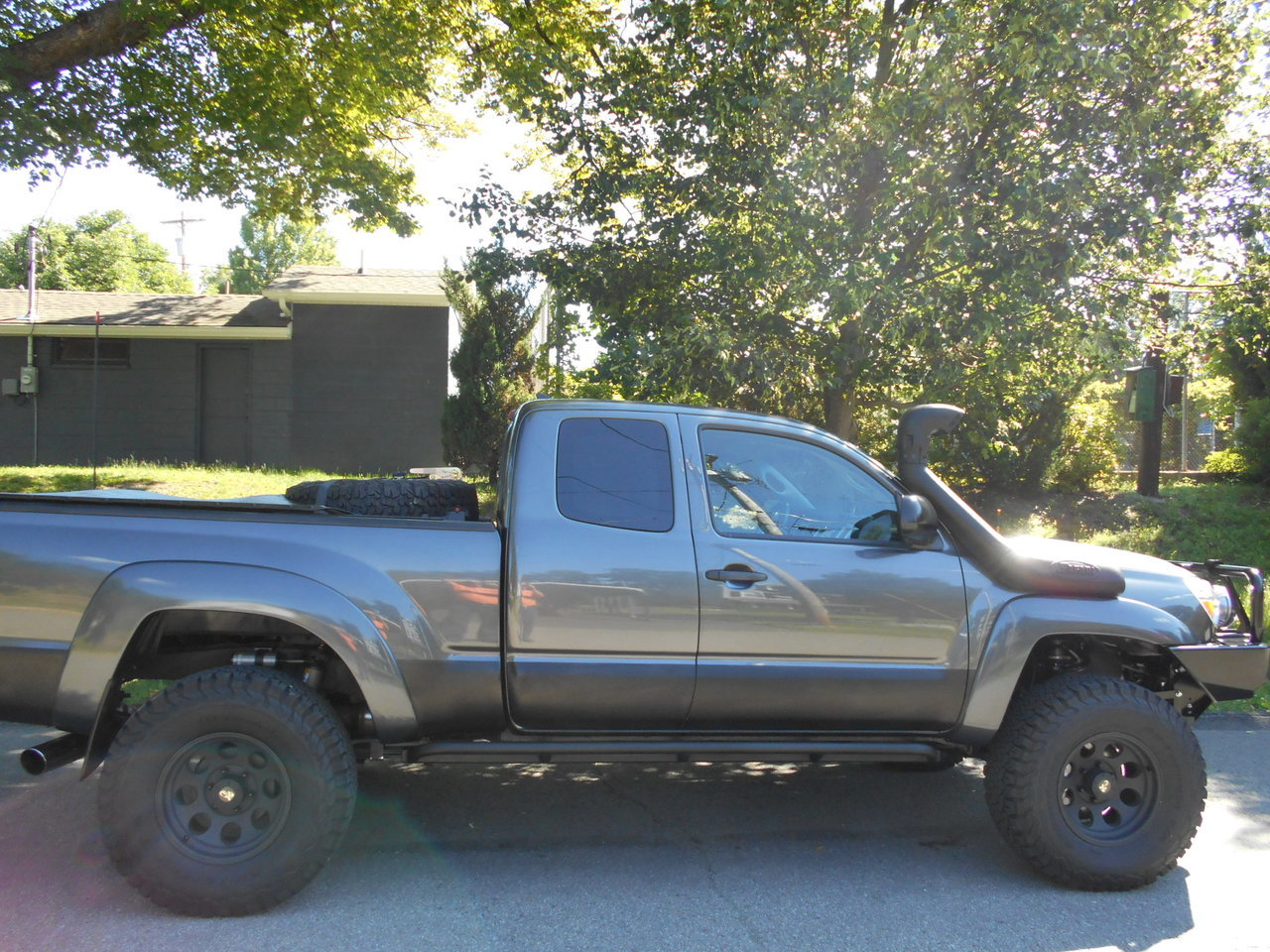

    Has anyone who has gone up to 33's noticed a difference in the odometer/speedometer? Is there a thread I have missed? Has anyone corrected this ..is it as easy as the jeeps were, ie change out the gear in the tranny?DSCN1339.jpg
