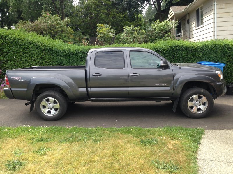

    Here’s my truck when it had that 5100 885 set up with add a leaf stock tires. 157B86C1-2190-41F7-A799-25079575D02F.jpg

    Lol looks exactly like my truck, color, year and all. Thanks, doesn’t look horrible. Drive ok?

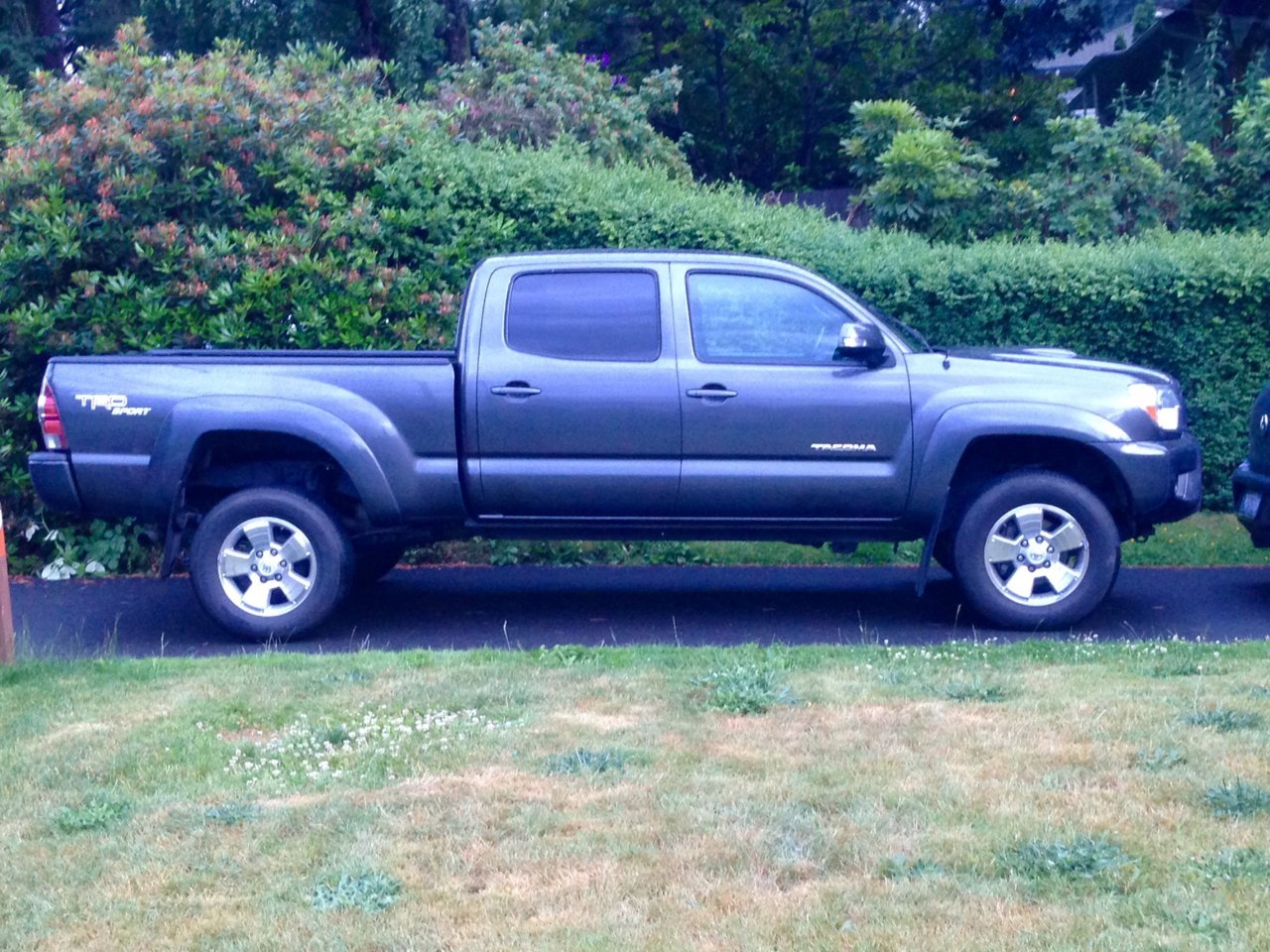

    Just found another pic without the aal in rear it was basically level. B9BC4060-A653-4364-83B3-C8F5F1C1BEAC.jpg

    I can see some lean bro

    That pic was minutes after install. After a week it settled and was almost totally equal.
