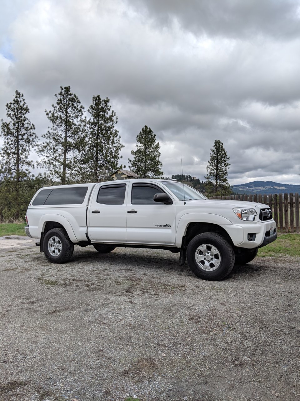

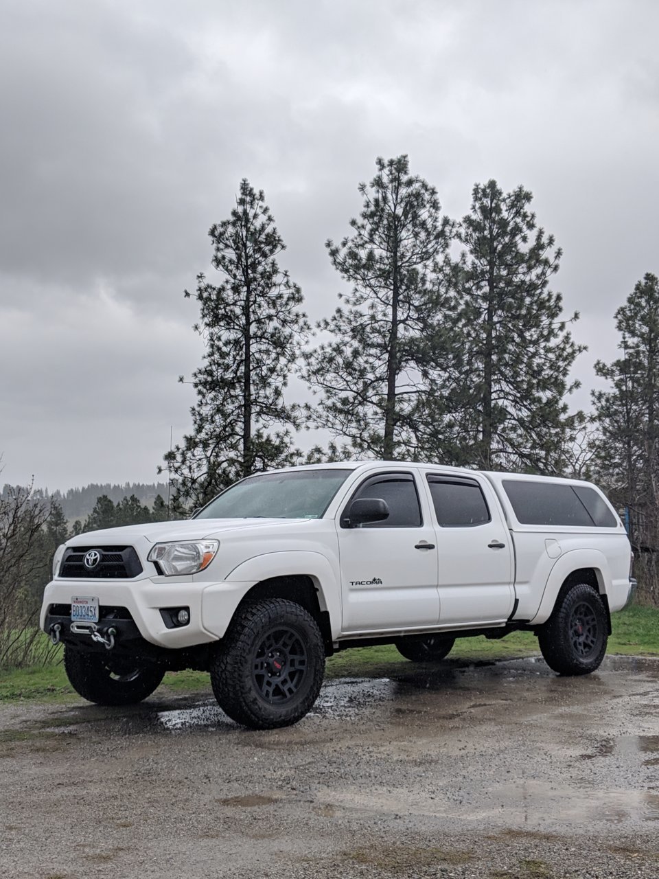

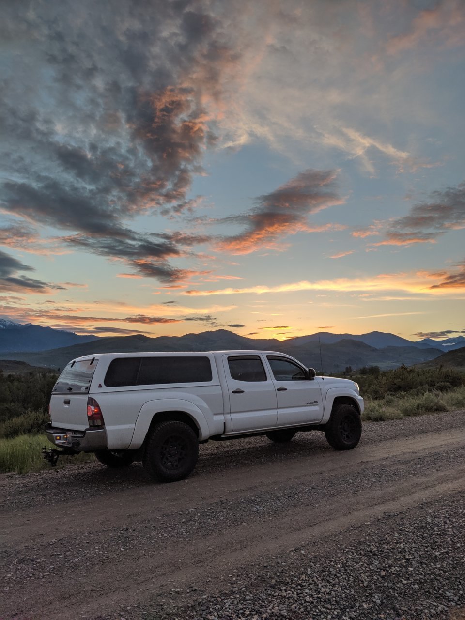

    You will be fine without doing anything in the rear. The truck sits about 1.5-2" lower in the front so the new coils and 5100s will just level it out. I ran 885s and 5100s for a while and it was good. Now I have bags and cradles in the rear.
    First pic is with rear stock and front 885s
    Second is with the bags.
    Tires are slightly larger than stock, 265/70/17

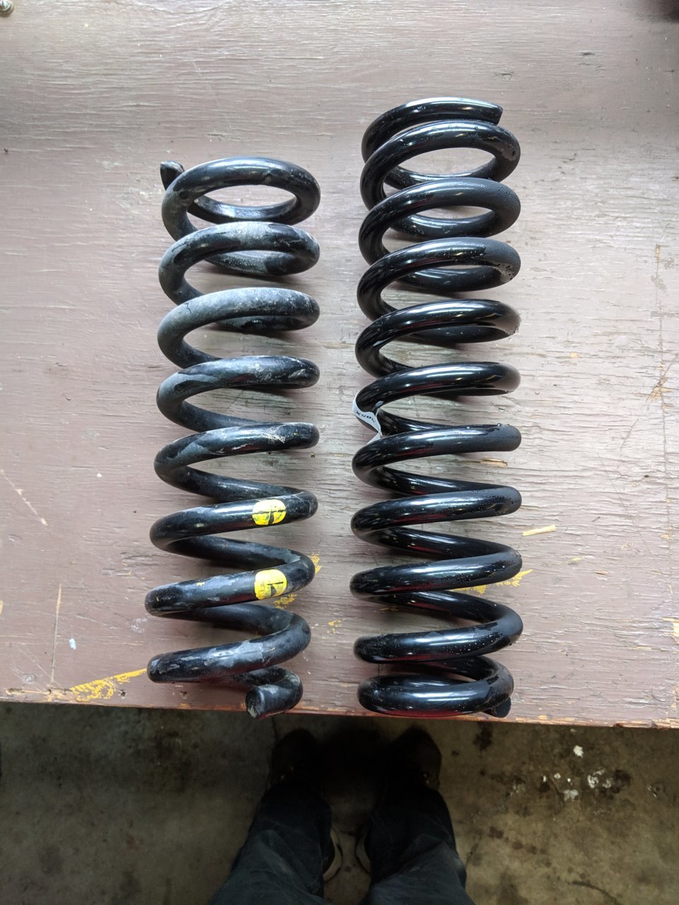

    Better pic with stock wheels and 265/75/16 Tires with the 885/5100 combo.IMG_20190407_150347.jpg IMG_20190407_114207.jpg
    Second pic is factory coils vs 885s.

    It appears the first pic shows a little bit of a lean in the rear, was the pic right after install and the front hadn't settled yet or is from the camper top with the stock rear?
  7. Jun 6, 2019 at 6:22 AM
    #27
    buckmaster243
    buckmaster243 I don’t know what to do with my hands
    Sep 21, 2014
    #138821
    1,819
    Buck
    Washington
    2013 DCLB, 2023 4runner
    That is correct the first pic was immediately after pulling it out of the garage after I did the lift. I should also note I have a USOffroad front winch plate and winch in the front that adds about 100 pounds and they are not Installed in that pic. It has settled some since.

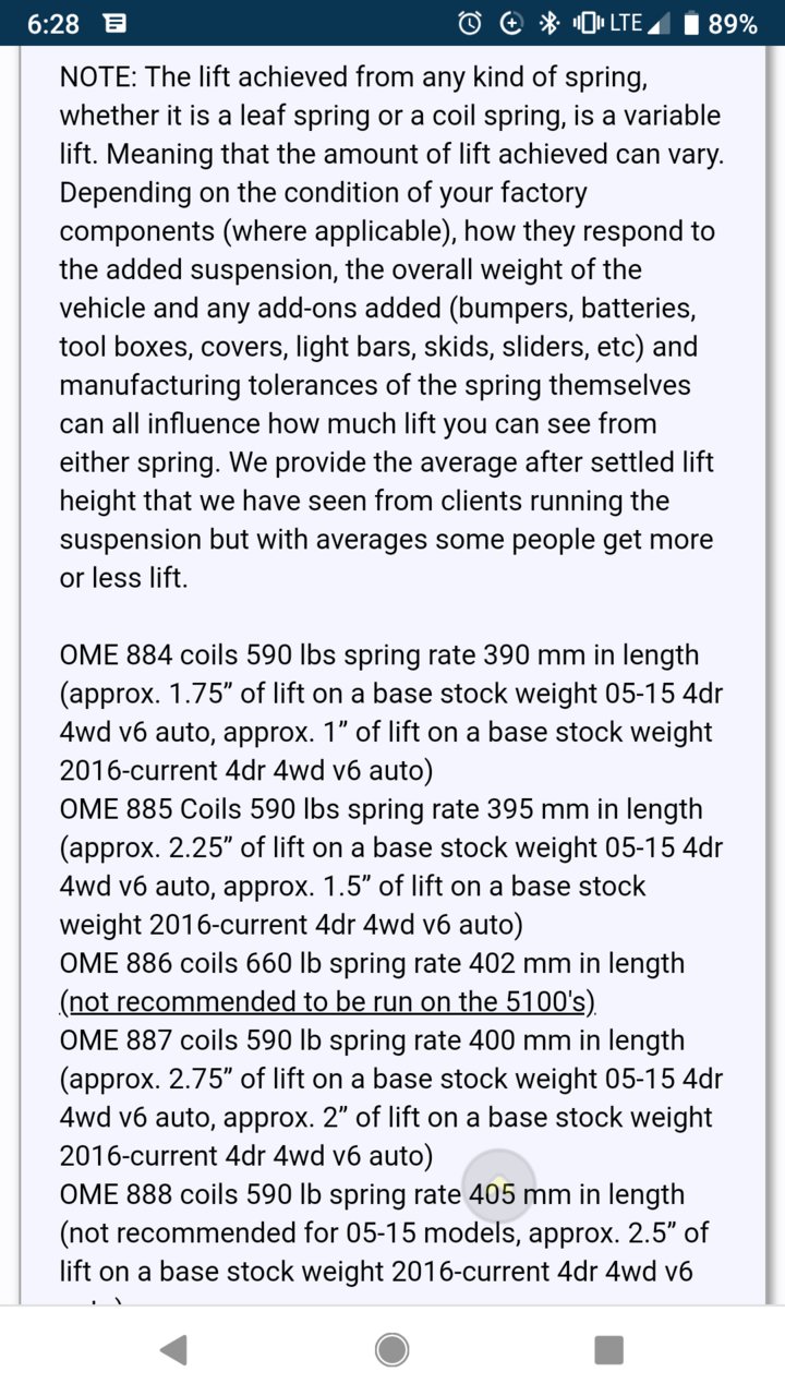

    ARB has recently redone their spring rate charts so people with newer springs aren't seeing quite as much lift as the older coils. This info was given to me by Marie at Headstrong. She sent me a chart I'll try to find it.

    Here is the chart

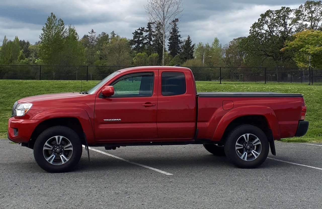

    5100s front and back. Stock springs, front shocks at first setting. Still one inch higher in the rear.
    Rides great.Will go up a size(265\70- 17) when tires get replaced.20190503_133507 (2).jpg
