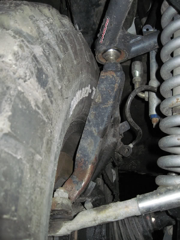

    Are you still running ungusseted spindles? :facepalm:
    More on-topic, I'm going to be swapping to stiffer and longer (giggity!) 700 lb coils on my shocks because I had to crank down on the 650 lbs ones so much that I had coil binding at full compression.
    They've been in my garage for months, and one of these years I'll find the time to install those things...

    I always thought it was kiinda funny see'ing all the beefier U/LCA's, yet the spindly spindles are un touched..

    Hmm some people run them for a reason. They would rather bend a spindle than rip apart something else

    Thats a good point. But hitting a small rut can fold it, where as if you were to gusset it, it could survive the same impact, and still be the "Fussable link" if a larger hit was had.

    Worst yet is I had spare spindles and gussets for almost a year or longer in my parts room.
    Hell, my tire gate has been cracked for over a year :D
    Haven't bent one yet.
    this...and laziness....and the fact I needed new wheels to fit the gussets on without spacers.

    My gusseted spindles are still fuseable links. :eek:
    Boyd, you got a welder? If not, I've got a flux core MIG setup that'll get the job done, or you can drop a few bucks and we'll take your junk to Bob for the baller TIG treatment. :cool:

    Icon uses a "special" length spring that's longer then what King uses. I would be weary of changing them around. I know that King 700# will work with Fox no problem.
    Yikes... thats AP's old gussets I think?
    No welder here. I wish I had one.
    Thanks for the offer.
    I have a few local friends I need to ask...they actually offered I'm just not good at asking for help. My bumper needs some help (couple cracked welds), my gussets need welding, and I have a shackle flip in the works that will need some welding.

    Those are actually the TC gussets. Since everything else is reinforced, they're still the weak point on a hard enough hit. It was a pretty hard hit. :eek:
    The offer's there if you feel like taking a drive so there's no need to ask. When I'm finally rolling again I could even haul my welder and generator down your way if there's an offroad day planned and I decide to trailer my pile. :thumbsup:
