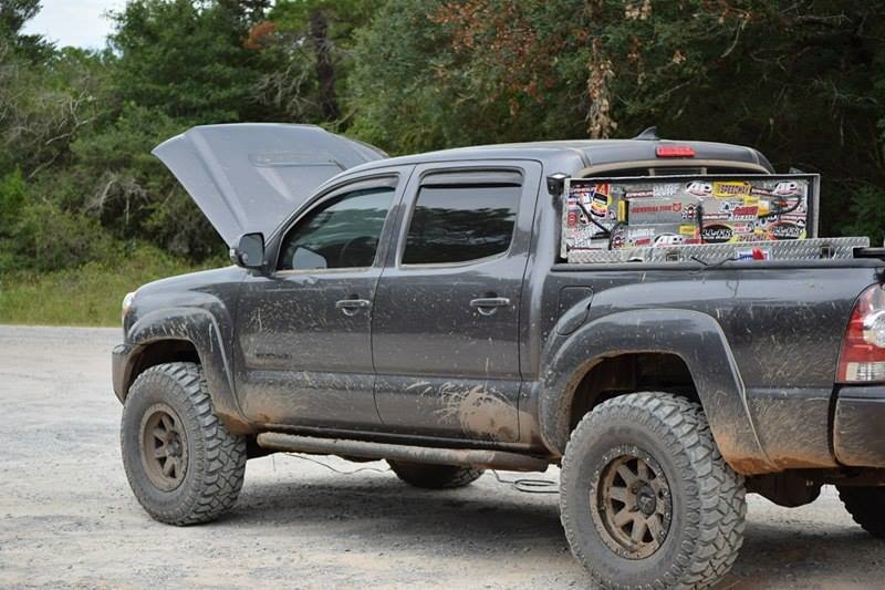

    Front 5100s @ 2.5, 1.5 AAL, 265/75-16 all terrains
    I recently switched from Firestone Destination AT 285s to Hankook Dynapro ATM 265s with no regrets. Better braking, better acceleration, it no longer wants to drop a gear going up hills, and better steering response. I'm still using the same KMC Addict wheels, 17"x9" with 4.5" of back spacing. It took me a couple days to get used to the look but now I think these tires look much better.

    It took me a couple days to get used to the look but now I think these tires look much better.[/QUOTE]
    Do you have any pictures you could share?

    I don't have any right now but I will get some for you later today.

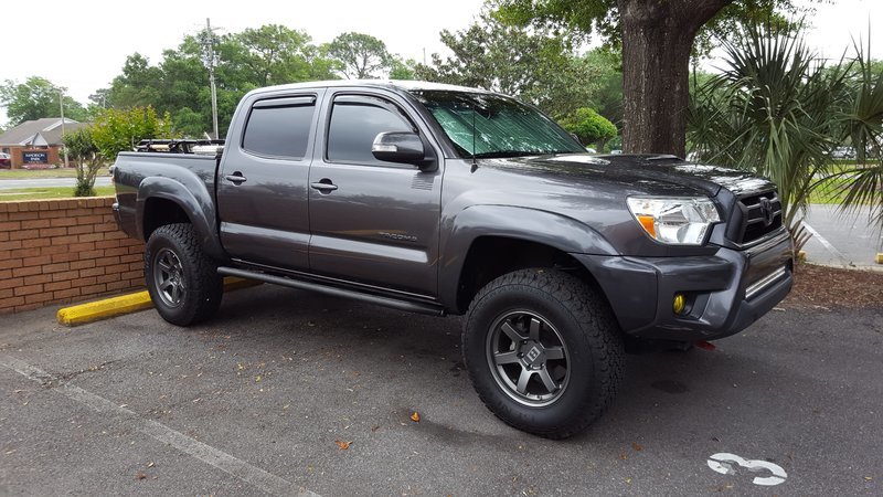

    That looks a lot better. I have the same size at stock height.
