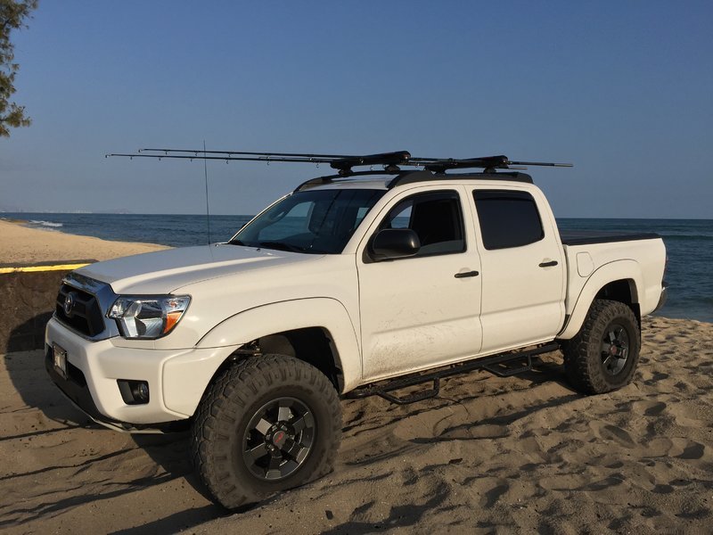

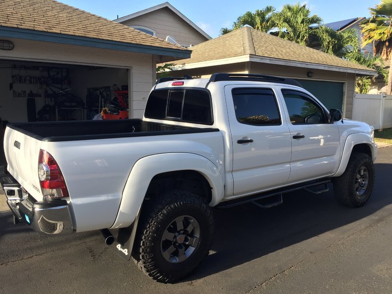

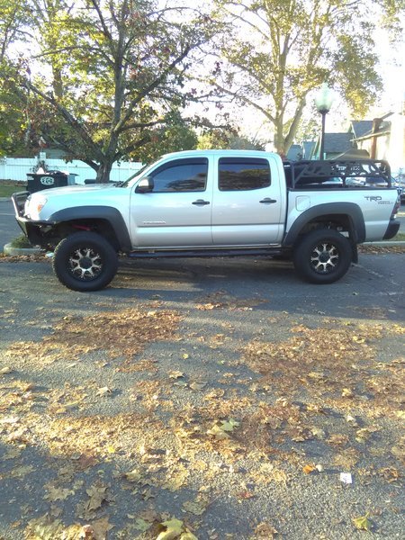

    2012 tacoma-04cbr1000rr-22ktm890duke R-19 wr450f-98rm250

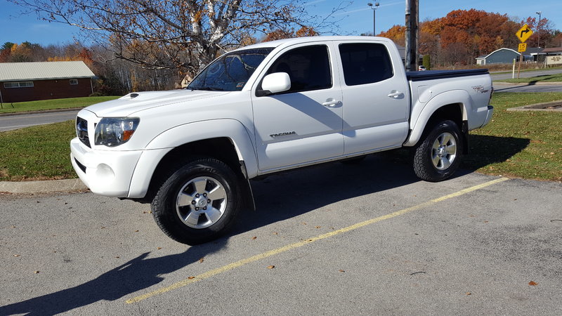

    3" lift 265/70/17
    Same 3" with 255/80/17

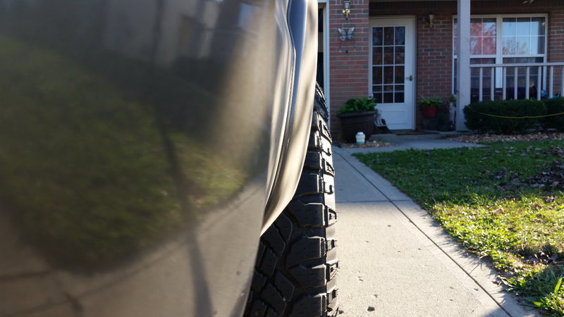

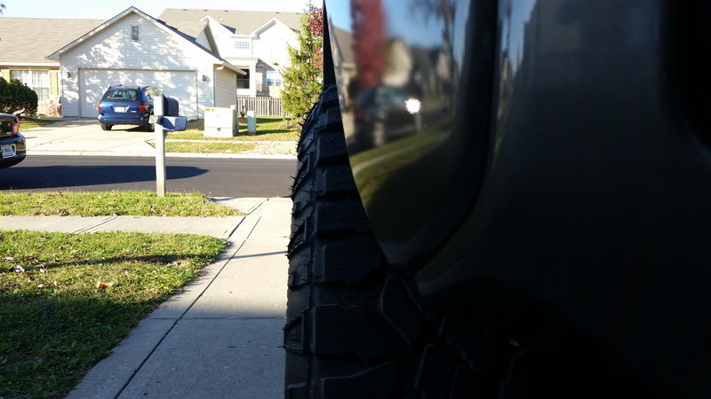

    Got a shot down the truck to see how far they stick out?

    Basically just the side wall + a 1/4 inch sits pass the fender

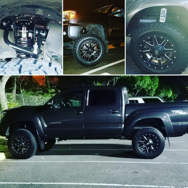

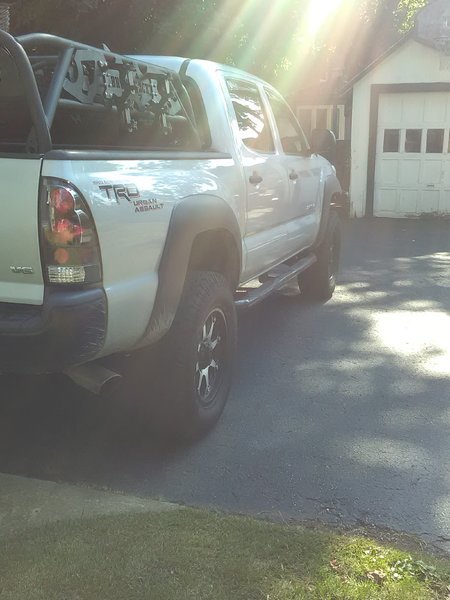

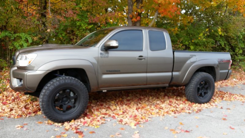

    Top image is 265 70 17 Bridgestone Duelers Bottom is 255 75 17 Cooper AT3's for winter. I have a 3/2" lift

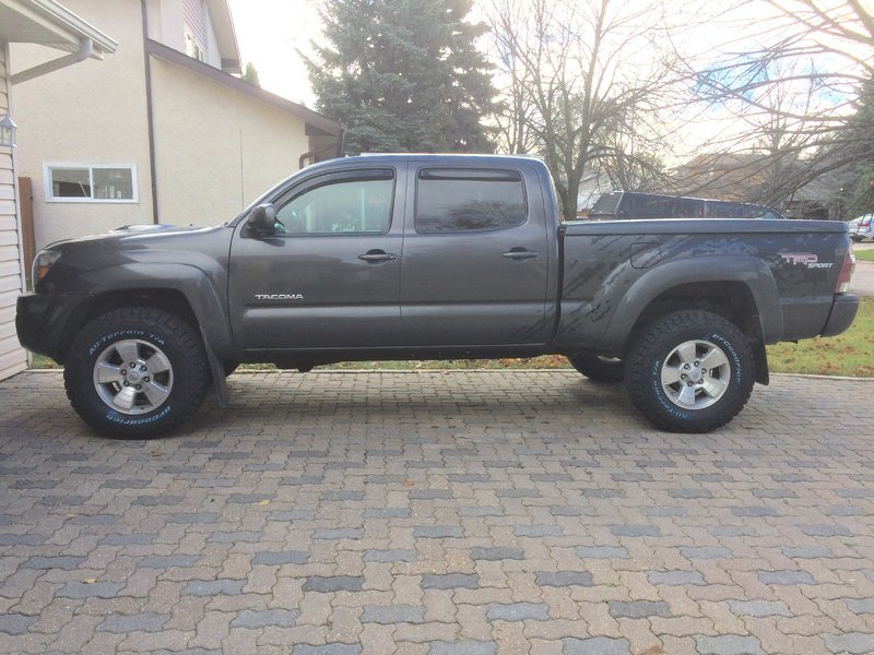

    BFG AT TKO2s 34 x 10.5 x17, Leer 550 Tonneau cover, weather tech digi fit liners, Viper 5901 remote start/security, 2" fr spacer, 3" TC AAL, All Pro IFS skid plate, Trans skid plate & Transfer Case skid plate, 12" roof mounted flip down dvd player, In channel vent visors.
    Go 34x10.5x17. It's essentially a 265 80 17.
    Taller than a 285 and you can keep your mudflaps on.
    TKO2s are the only ones with this size though.

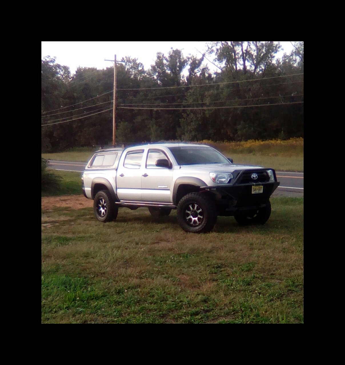

    2013 v6 2wd
    K&n intake/borla
    265 70 r17
    3 inch lift

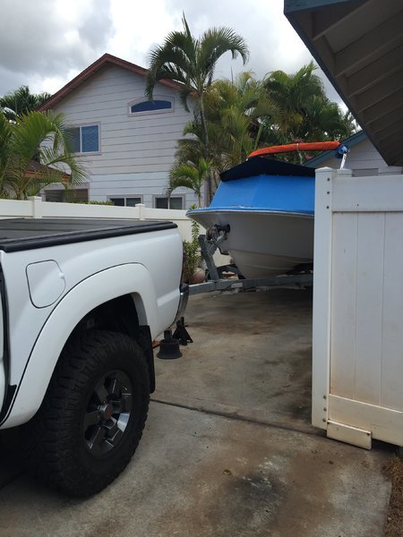

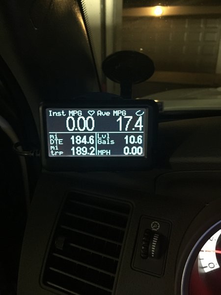

    I run 285/75/16 on fj special edition wheel, a 3in front lift 2.75 in the rear no rubbing what so ever had to remove the front mud flap tho that's about it . I average 17.4 mph that's what my ultra gauge reads. I tow my boat about 50miles almost every weekend. I personally love the look of the 285 , with stock tires I was getting around 19mpg lol I miss that too

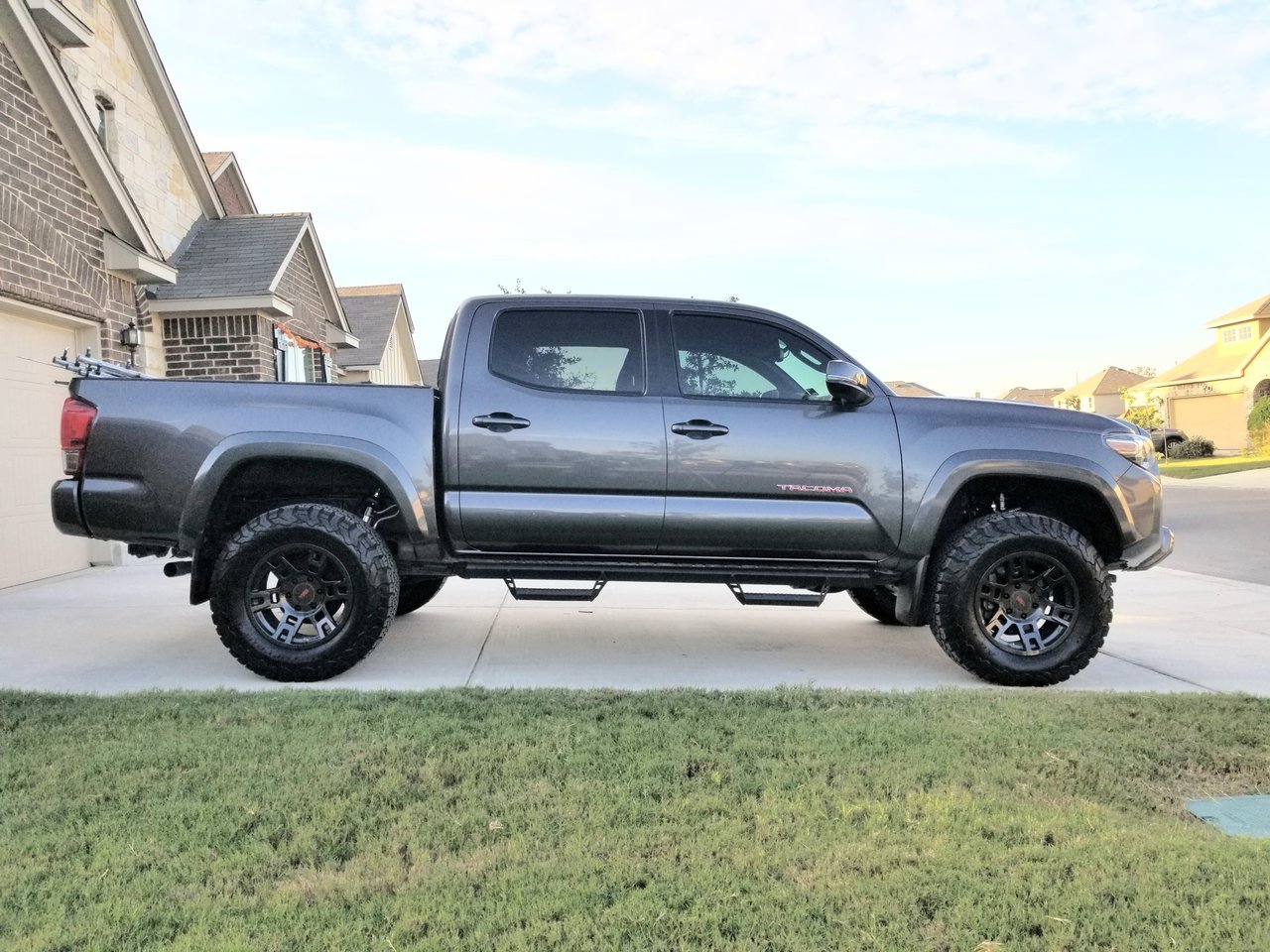

    Fabtech 3" Uniball System w/Front Dirt Logic Adjustable 2.5 Coilovers & Rear Dirt Logic 2.25 Resi-Shocks. 285/70/17 Nitto Ridge Grappler Load C wrapped on 17x8.5 Jet Black SCS Ray 10's....
    Nice Fabtech lift :D:D:thumbsup::thumbsup:
