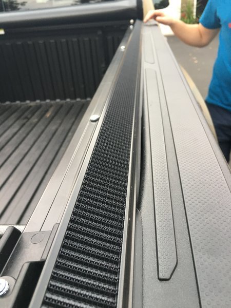

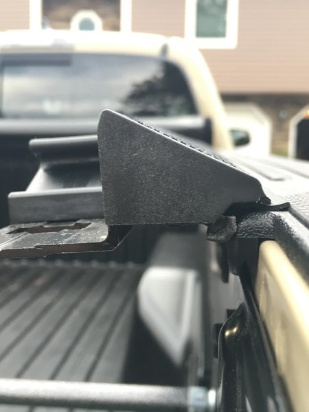

    Chas, this is what mine looks like if I put my last rail like yours is... You can see the gap that I mentioned before.

    The gasket is folded under along that gap area. Just loosen the bolts and pull that up so it covers that gap. Happened on mine as well.

    The gasket is just barely folded under. If I straightened it out, there would still be a gap between the edge of the gasket and the bed liner on the inside. That space is too big, no way would it be watertight.

    Well, I don't know what to tell you. The rail is supposed to be level so you can rotate the rail a bit to the right (as pictured) so it moves the gasket a bit more over the cap. The seal should be sufficient and the cover extends beyond the gasket when in place. good luck with it.

    Call Truxedo or email Rhonda with the pictures. They are very nice to deal with.

    I sent Rhonda pictures and she responded that she needs more photos and also stated she thinks it is not installed properly. So I will get the photos she needs and see what she comes back with.
