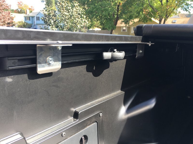

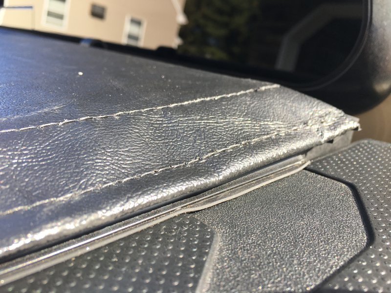

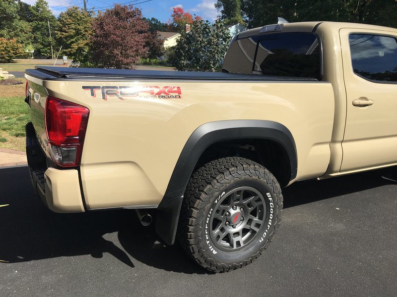

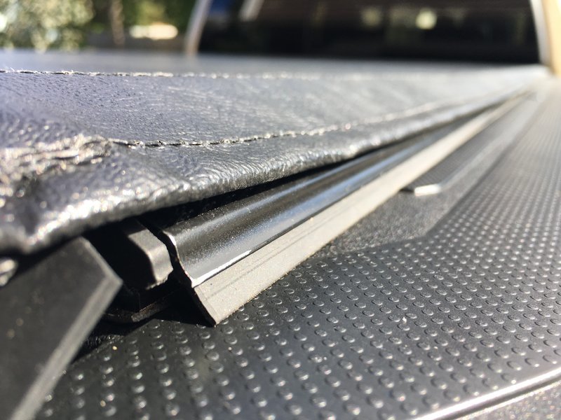

    Didn't get around to it yesterday but here are some pictures. You can still use the Tie downs on the rail but you can't take them out unless you take off the Lo Pro rails.
    One question I have for anyone with the Lo Pro QT, does the rail near the tailgate seem to rise up more than the head of the bed or is that just me and my install issue? I tried to get it to go down but no luck.

    I would loosen all the bolts/nuts and start tightening the bracket closest to the tailgate while pushing down on the rail, then tighten each one while holding down on the rail. You may have to egg the hole out on the bracket that fits up against the rail to allow for more adjustment. TruXedo has great customer service as I have called them twice myself. Give them a call.
    As far as the tie downs, you can remove them without taking the rail brackets off.

    Yeah that's the plan for tomorrow. Today is another busy day. Hopefully they seat lower. It seems like there is a price of plastic that is preventing it from seating correctly but I'll double check. I'll also double check the tie downs, you can't twist them out like I usually do. Probably have to just twist the center and not the whole thing.

    Yeah I know how to take them out, easy without the rail for the cover. I'll double check later on today and see but when I tried the plastic hit the metal rail for the cover. I didn't try very hard to look too in depth. It was getting dark out as I was finishing the installation

    I ran into the same issue. Didn't have this problem with other Truxedo Lo Pro QT I installed on other trucks. Not sure how to correct. Let me know if you find a solution.

    Oh.. O.K... I see what you are saying now. I put the tie downs back in the rail before I screwed the tonneau rails down on the brackets. Never tried taking them out after I installed the cover. The fact that you cannot remove them is not a concern for me. Sorry this is an issue with you guys.

    Yeah, it's not an issue for me, you can still use them and move them between the mounting point. I was just making a comment that not sure you can take them out if someone needs to. But like I said I haven't really tried that yet so it may be possible. I'll report back tomorrow or over the weekend. So far I love the cover

    Glad I'm not the only one. There's a piece of metal or plastic that kinda prevents it from touching. It seems like it would be fine without the liner in the bed. I'll check tomorrow and try to solve it and let you know

    It appears to me that the problem is that the top of the bed rails flair inward slightly a couple inches from the tailgate. This prevents the Truxedo rails from dropping down flush with the bed rails, and therefore has to sit on top. I tried moving the Truxedo rails inside the bed rails but then the cover will no longer fit between the two rails because it is too narrow.
    Besides the look of it I'm concerned about water leakage as well.
