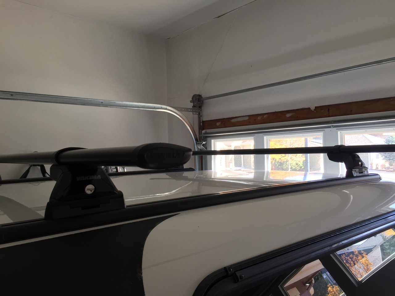

    ARE Overland with Yakima Rack system with CVT Mt Rainier.

    would you have any more pictures of this? Im curious of the rack, how does the CVT attach to it? is your rack just 2 bars? 3 bars?

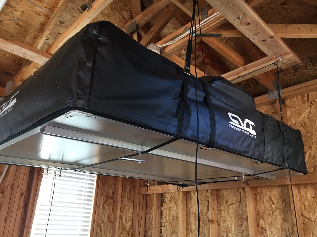

    I have bed stiffeners that I have not yet installed but no issues without. I did go with the overland model since it is supposed to be a bit stronger. CVT stated that they have installed hundreds of these tents on camper shells and have yet to have any issue. However, I still feel bed racks are stronger but I needed the shell for storage, etc. Also keep in mind the size and weight of the tent and what you will be doing. I would not want to be doing any crazy off camber stuff because physics is physics. A 140-185 lb tent that high up is gonna affect your center of gravity and would put a lot of lateral stress on the rack and shell.

    I had my shell dealer install the rack. You can order the shell with the tracks and then install whatever rack system you want. 2 cross bars
