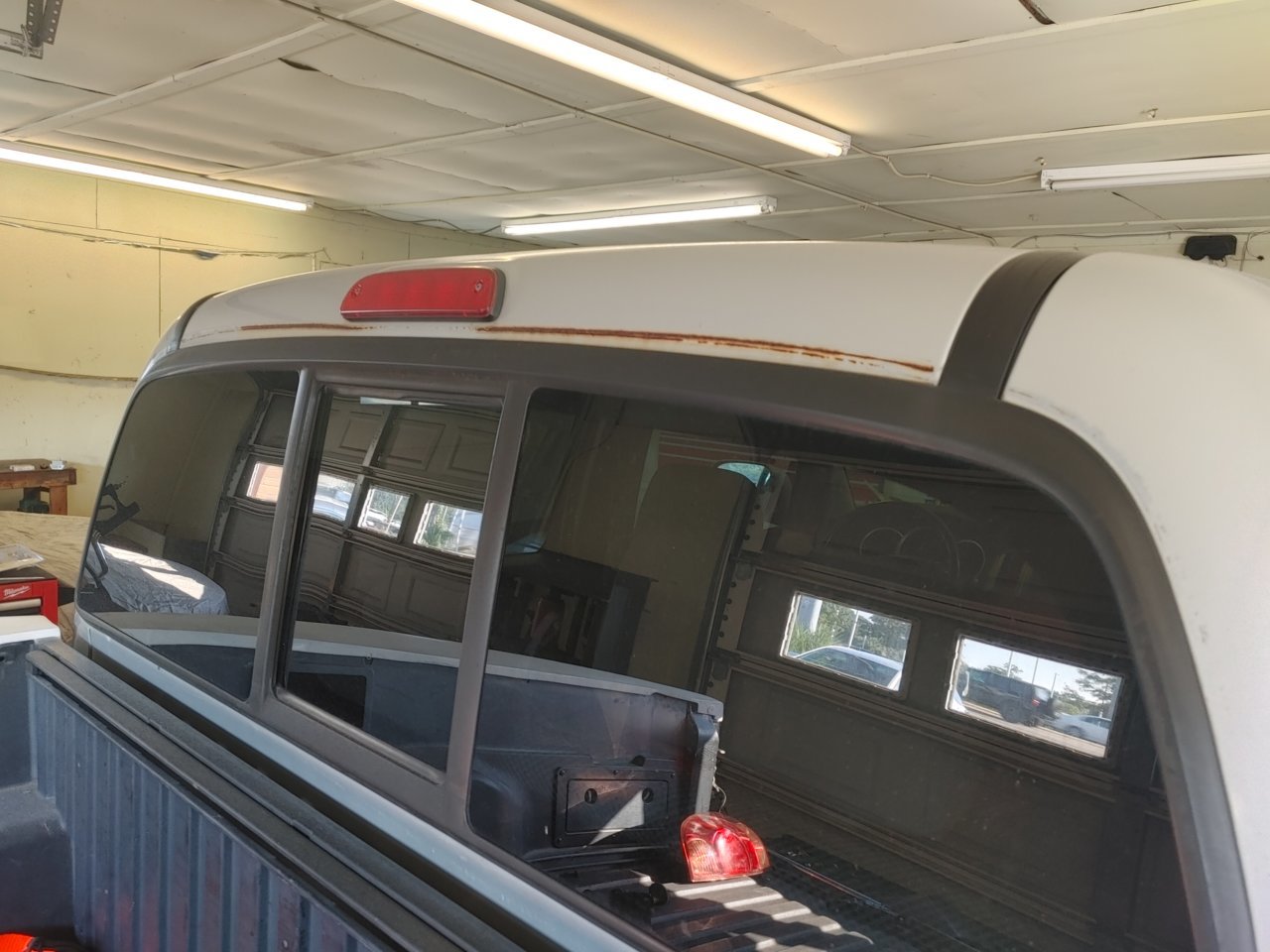

    16637668571217066380523826654762.jpgSnugtop. If you have a shell that has a rubber gasket that touches the cab I would recommend putting some clear vinyl down to protect the paint

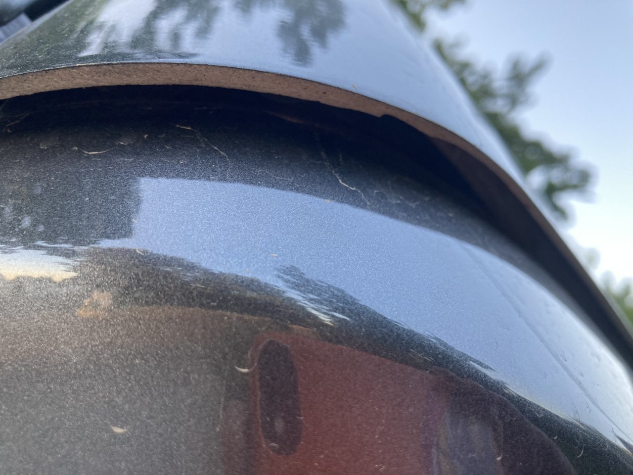

    Okay OP this is my personal experience.
    My ARE shell was installed using foam tape. Over time, and many miles of dirt road later, the crappy foam tape flattened and the shell eventually started rubbing my bed. I could even hear the squeaking of it rubbing the paint while driving down gravel roads.
    I went back to the shell dealer and he replaced the foam tape with some of that thicker weather stripping. Haven't had a problem since.

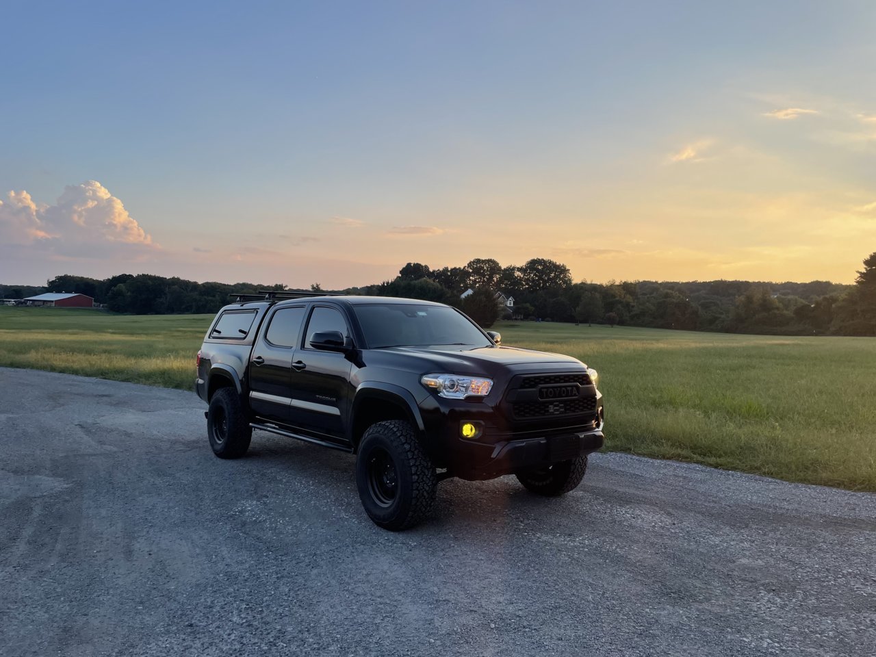

    I have an ARE shell. Haven’t had it for long but no issues at all with paint scratching. I could definitely see how @boston23 ’s post could become an issue though, my cap is mounted with the same foam tape near the cab.
    Pic for fun.

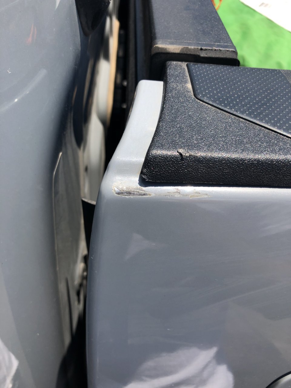

    Just removed my Leer 100XR this past weekend in preparation for picking up my GFC camper.
    I found a couple spots where the shell had contacted the body and rubbed paint off to the bare metal. I’m guessing the foam seal the dealer used flattened out over time. My truck has also seen lots and lots of miles on rough dirt roads. It’s not a huge deal, I just touched up the bare spots and called it good.

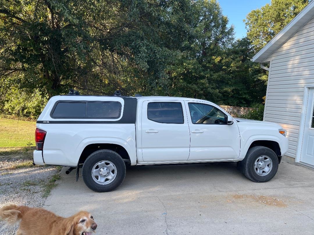

    It it's mounted correctly...CORRECTLY...there is no way it can scratch the truck. This assumes the topper is made for the correct year, make, model and bed size that it is mounted on. I have run toppers for years with no
    issues and currently have them on my '22 Ram 2500 and my '22 Tacoma. Handy as a pocket on a shirt when needed and can be lifted off in 10 minutes with a buddy if not needed.

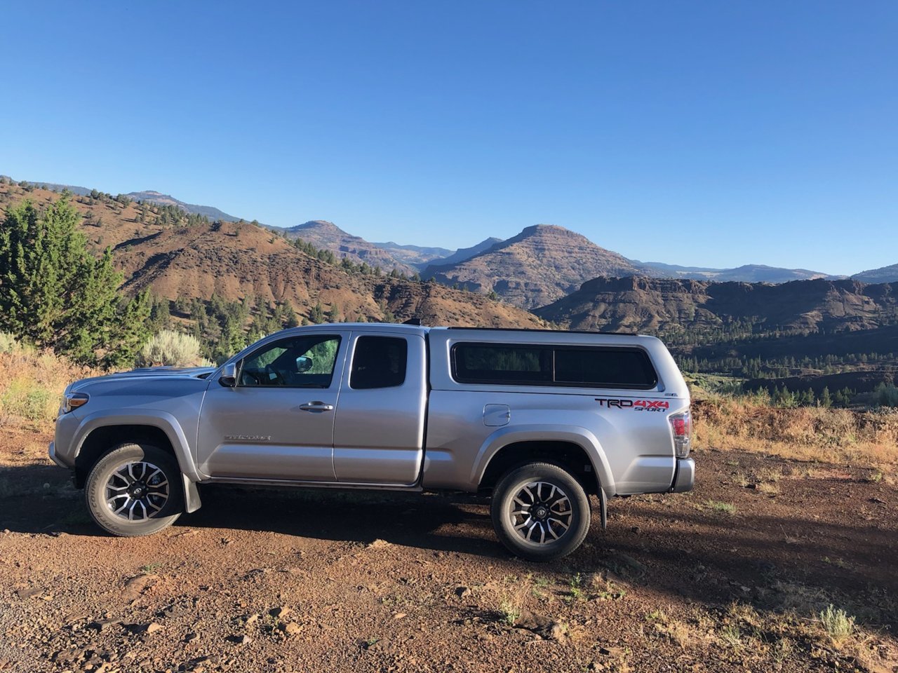

    For what it's worth... I have a Snugtop ... Had it for 16 months now. The place that installed it, ran some of that flat (About a 1/4" thick, about 1 1/2' wide) foam wheather-stripping around the top rails of the bed. Mounted the shell (Rock solid) and the bottom edges of the shell, you can run the edge of your pinky finger around it and there is nothing coming even close to the paint. Works for me.. :thumbsup:
