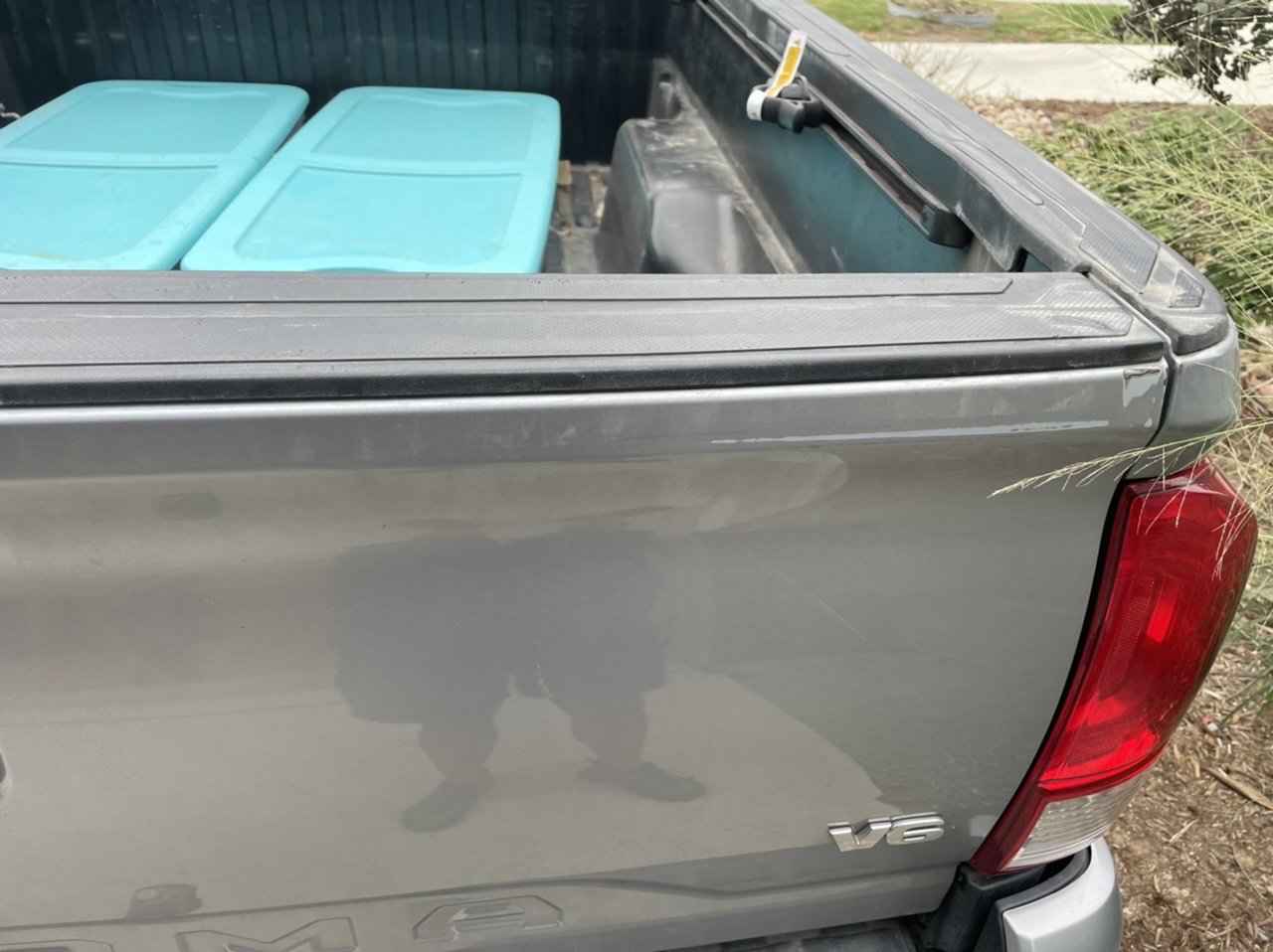

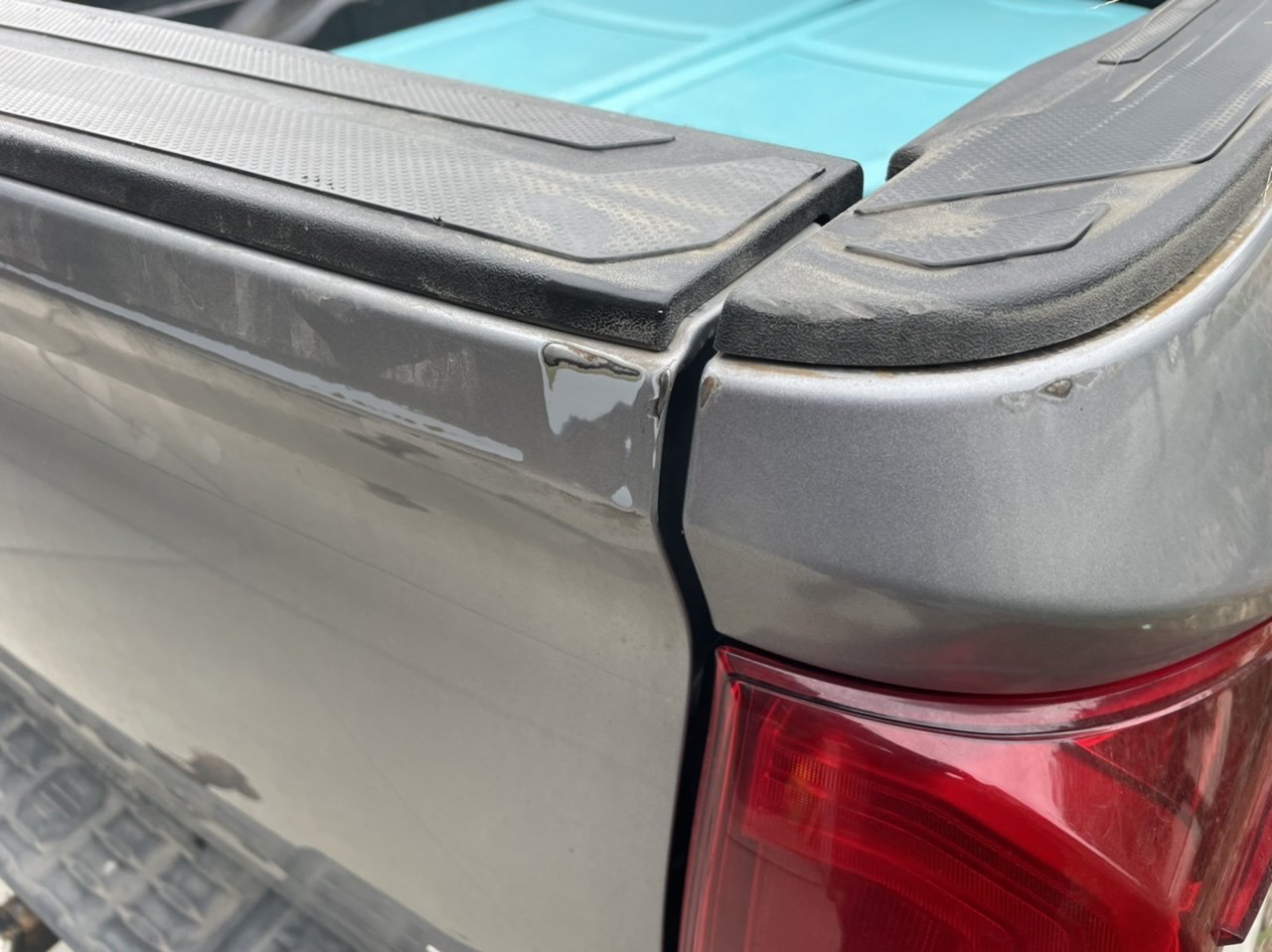

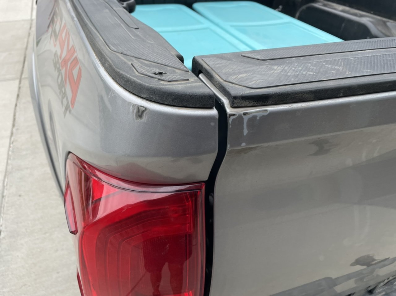

    Don’t mount it too far forward! Recently bought a snugtop Rebel off a Tacoma owner, who ran it for 6 years. It was installed by Snugtop dealer. When we lifted it off, this was exposed:A8CBA2AB-2F17-4B79-8CEE-16F6A688219C.jpgBC41FB90-873B-4D37-8F85-38FB9FA99074.jpg F41ADCB9-7204-4C51-830A-79B5D08A1263.jpg

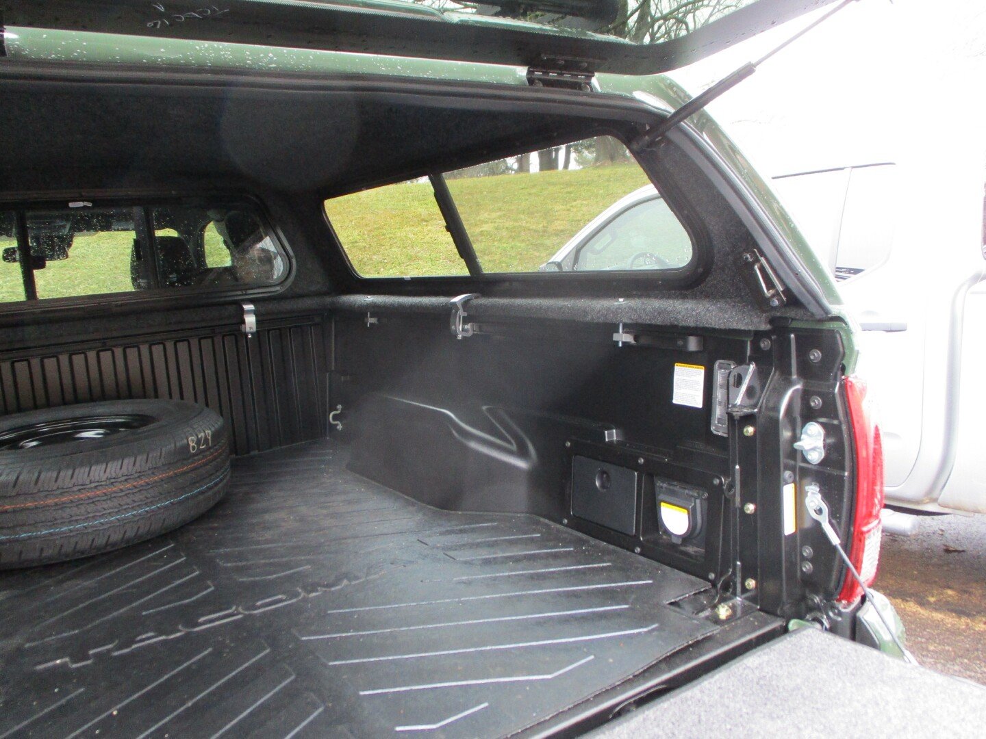

    My topper shifted during an off road trip and ended up scratch the paint at the back end of the bed. I have since added one of these clamps to either side of the topper and it hasn't shifted at all.
