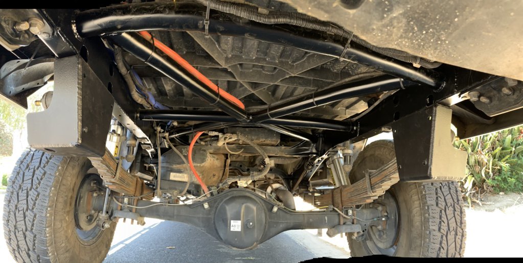

  10. Jul 20, 2020 at 1:42 PM

    i've had my frame boxed before I got my drifter camper on the truck. I've been constantly heavy (steel bumpers, 1/4" steel skid plates, sliders, camper, etc) and havent had any issues. I can't really say I've noticed any difference driving wise on or off the road specifically related to the frame since i easily added 500# to my rig fully loaded on a trip at about the same time I boxed the frame. I can say that I feel less worried about issues when on a trail flexing the suspension with all the weight on the back.
