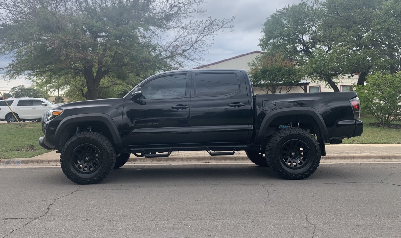

    B56B73DD-8E76-4E52-8218-6862881E7D7A.jpgFuel Vector wheels 17x8.5 +7 offset with 265/65 r17 tires

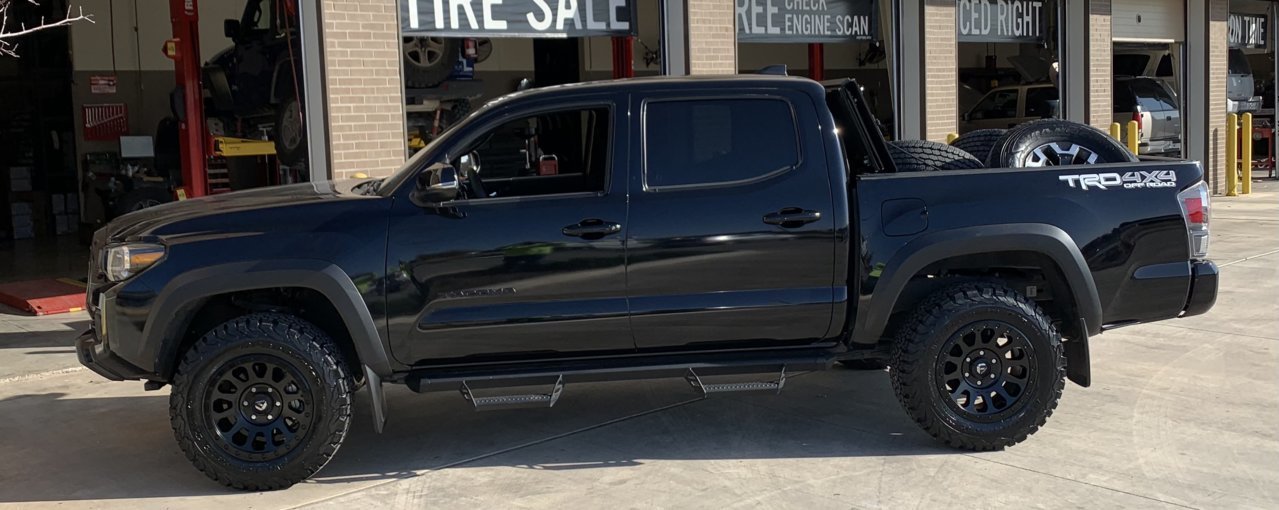

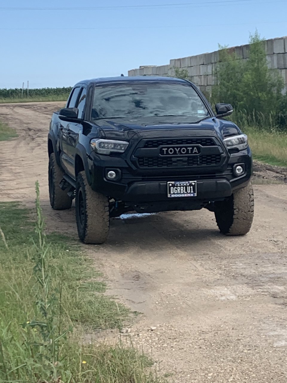

    E331D6B5-814F-413F-B6D2-1114AE3D5A8F.jpg 14D378C6-69AC-4A76-85BE-811F4E1CB897.jpg Fuel Vector wheels 17x8.5 +7 offset
    BFG 285/70 r17 all terrain tires rubbing on driver side was corrected with a wheel alignment no trimming or modifications.
    3” lift front 2” lift rear
    Front:King 2.5 coil over shocks with remote reservoir with Camburg UCA’s
    Rear:King 2.5 shocks with remote reservoir and Old Man Emu Dakar EL 111R Leaf springs

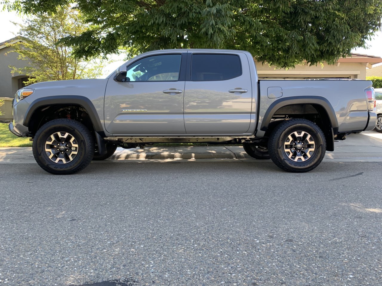

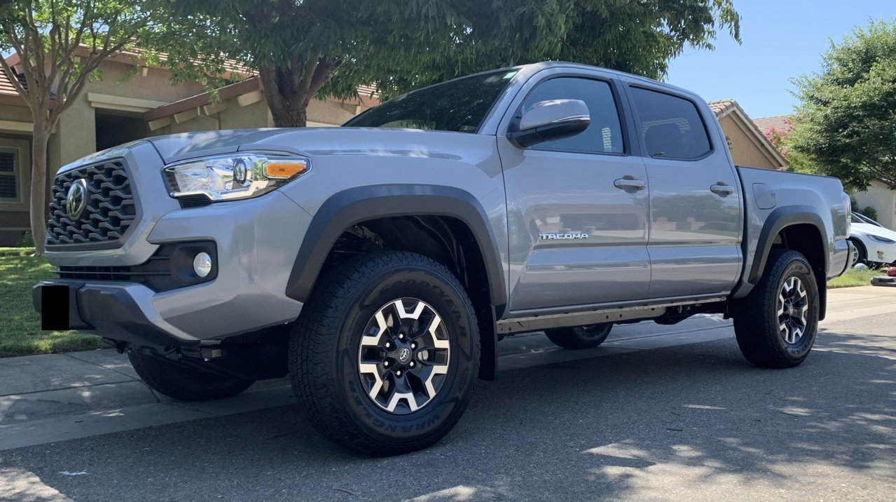

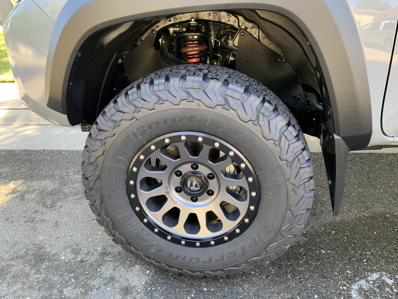

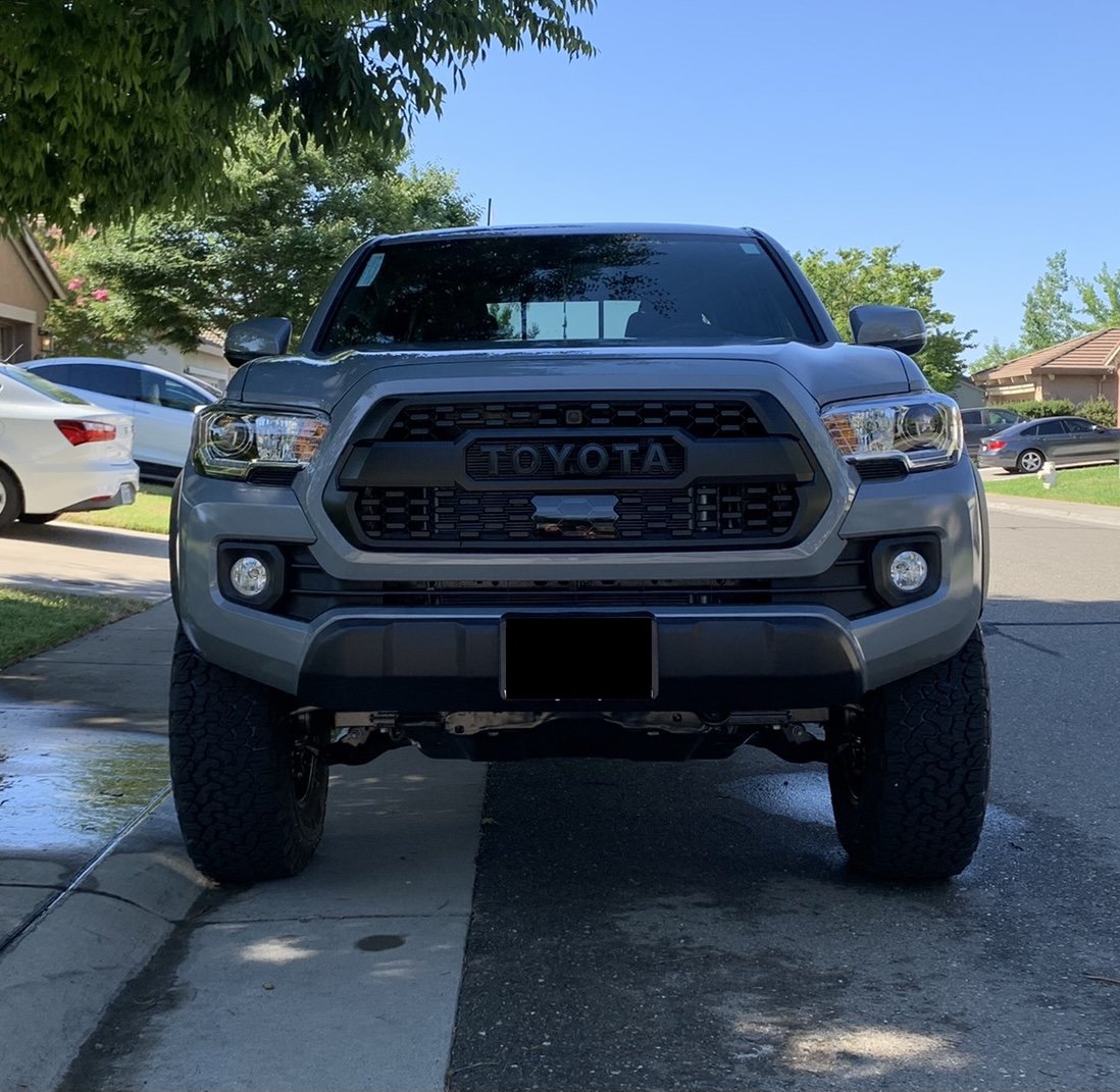

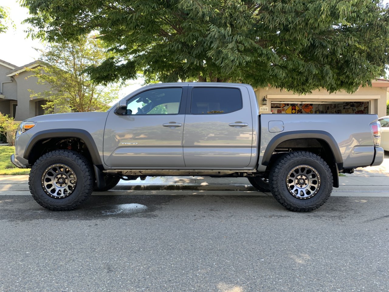

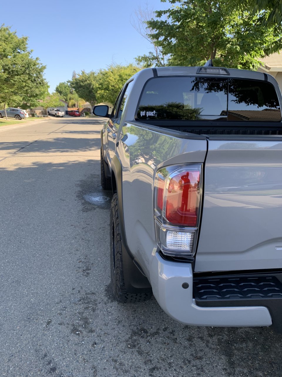

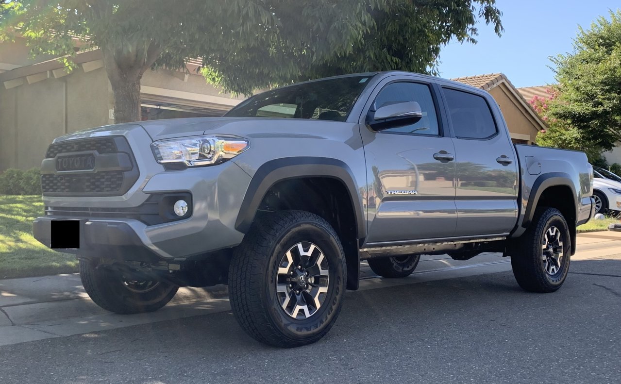

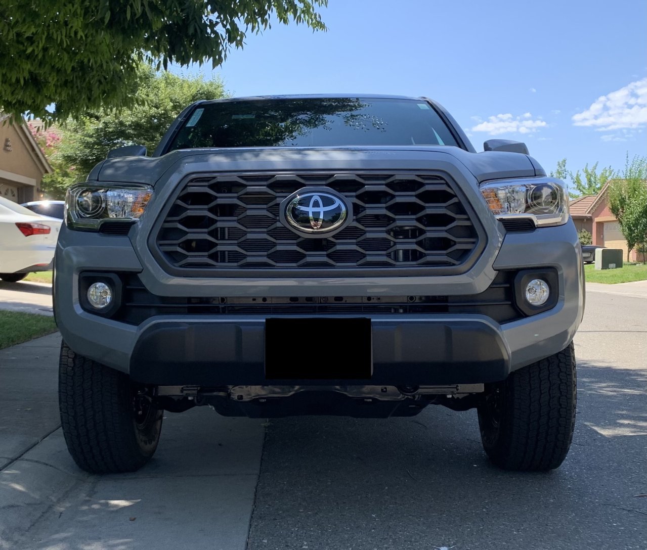

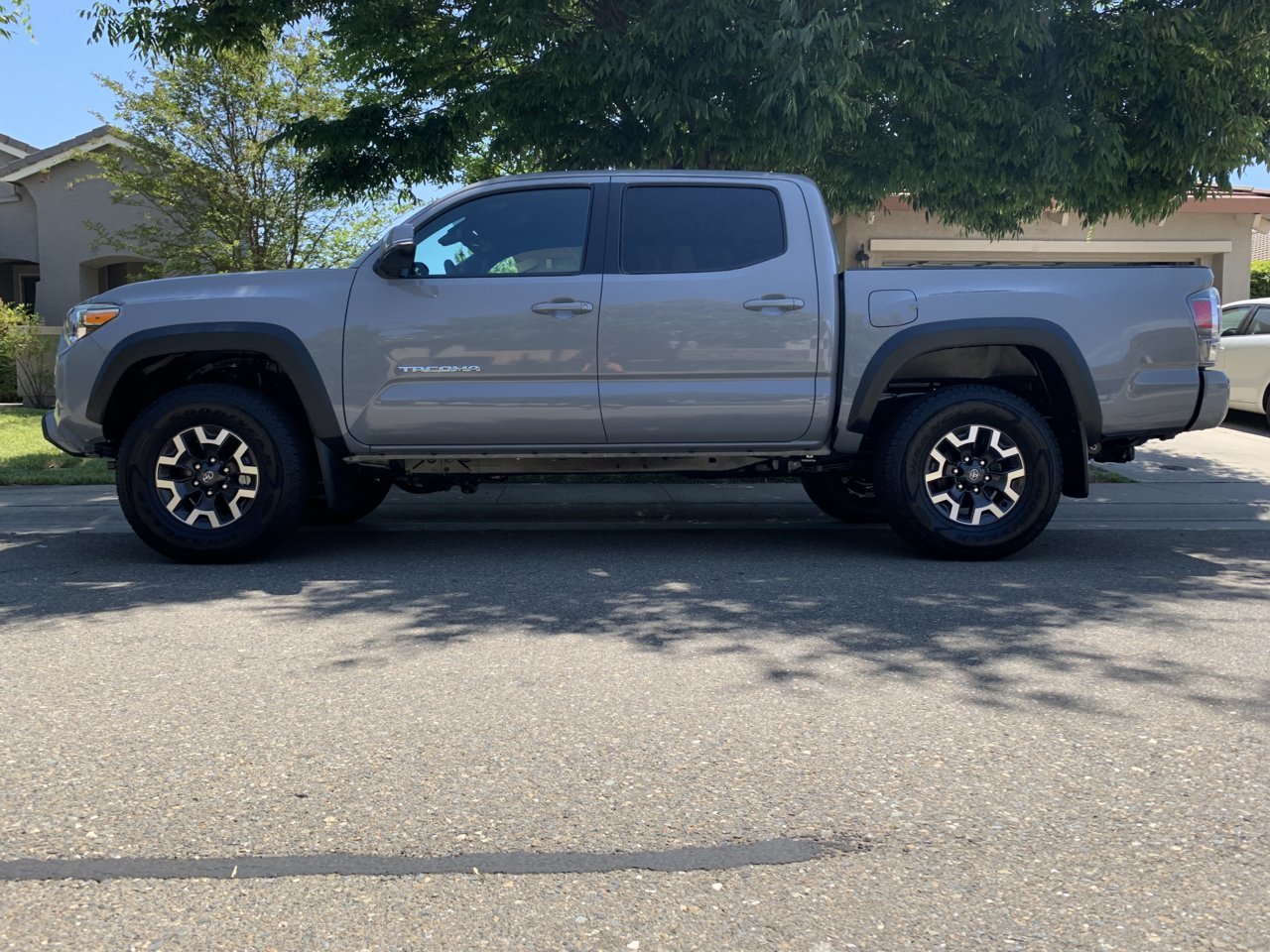

    Got her done yesterday and I absolutely love the look of these wheels on the cement taco.
    Absolutely no rubbing while fully cranked (on normal street driving:)). I’m guessing I’ll have to remove the front mud flaps and potentially do some slight plastic trimming at some point (I’ll know more once I get a chance to get her off road and twisted).
    Here are some pics of the transformation so far…
    Stock:
    With Lift:
    With new Tires and Wheels:
    Setup:
    • 2021 Taco Off Road
    • 285/70R17 BFG KO2’s (C rated)
    • Fuel Vector 17x8.5 +7 Offset
    • Toyota TRD OEM Lift Kit (2 inches in the front, 1 inch in the rear)

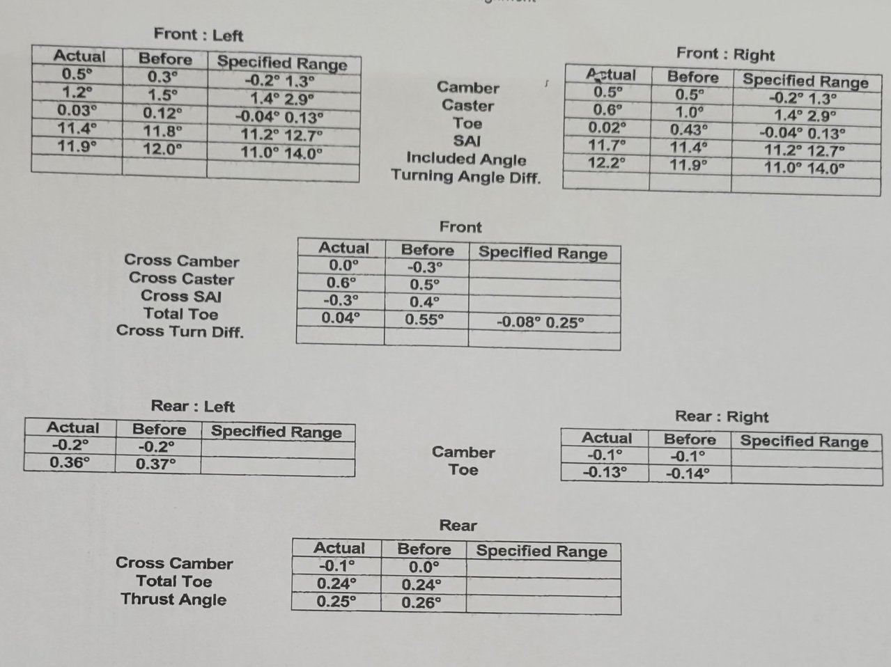

    Looks good do you know what your new wheel alignment specs are? I’ve had a rubbing issue with my set up and no one so far has been able to get it right

    Here ya go @Mono …good luck brother!

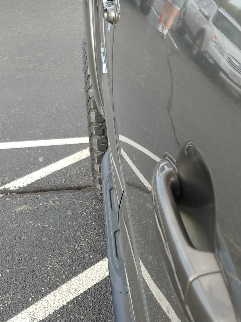

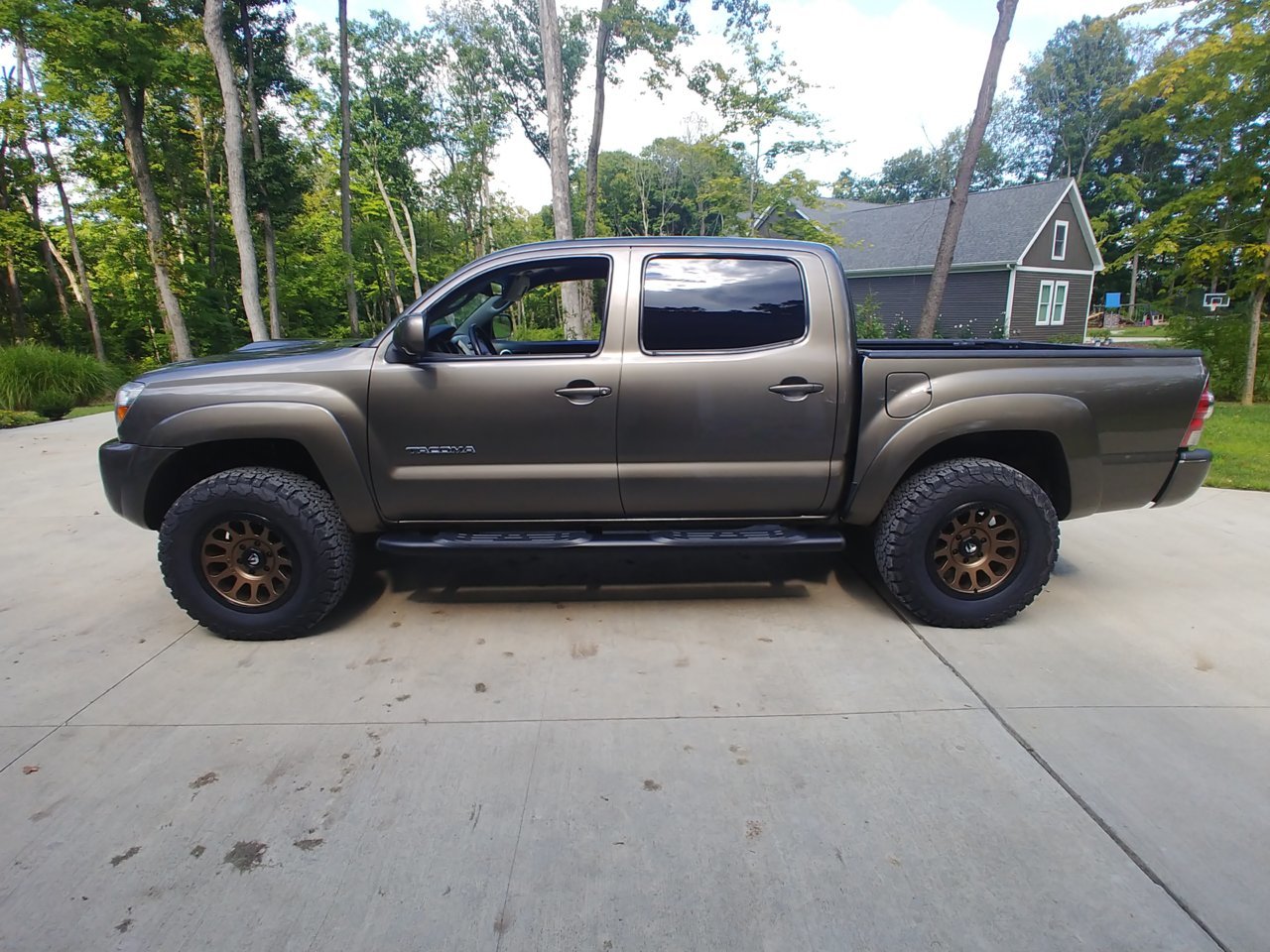

    My 09 with 17x8.5 +7mm with K02 265/70... about 1/2" outside flares. My setup is 39 mm (20 tires & 19 wheels) narrower than what you're looking at overall.

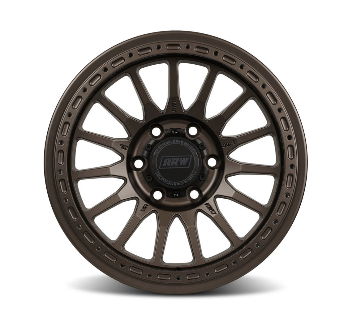

    Been thinking / Lustin’ about these too in matte bronze.
