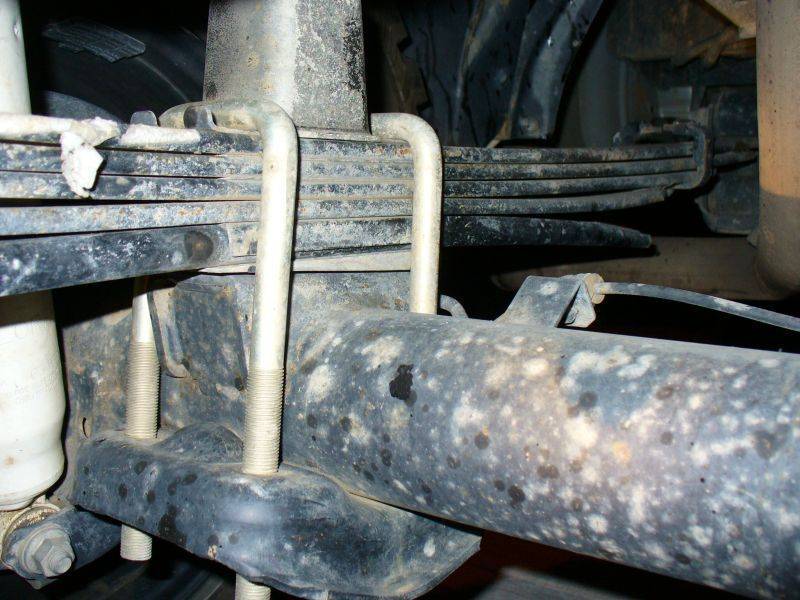

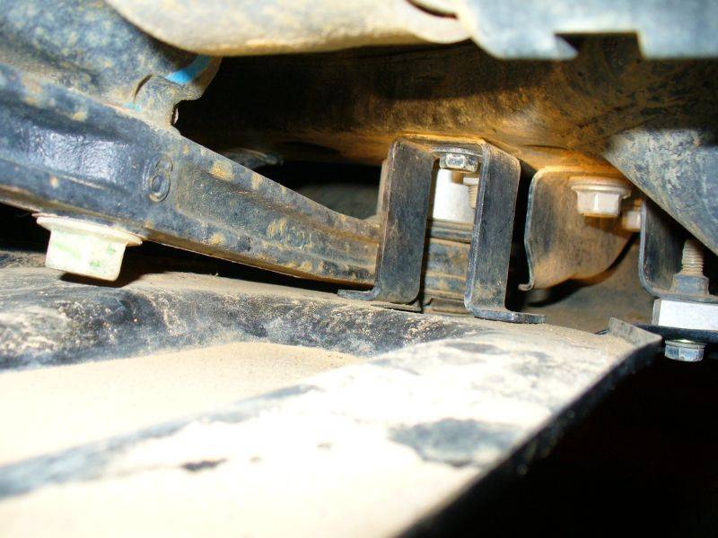

    404

    This is the passenger side diff drop spacer. You have to look through the skid plate mount to see the spacer. You can see how it goes on top of the diff to change the angle. Oh and the small square blocks are to drop the skid plate (right side of pic)
    This pic of the axle shim is of the passenger side looking at the inside of the passenger wheel. You can see how it goes on top of the axle and under the leafs. The fat portion of the shim goes to the rear.

    I could have sworn my toytec Diff drop kit came with small meta circles instead of the small blocks to lower the skid plate? Oh well, same thing I guess.:eek:
