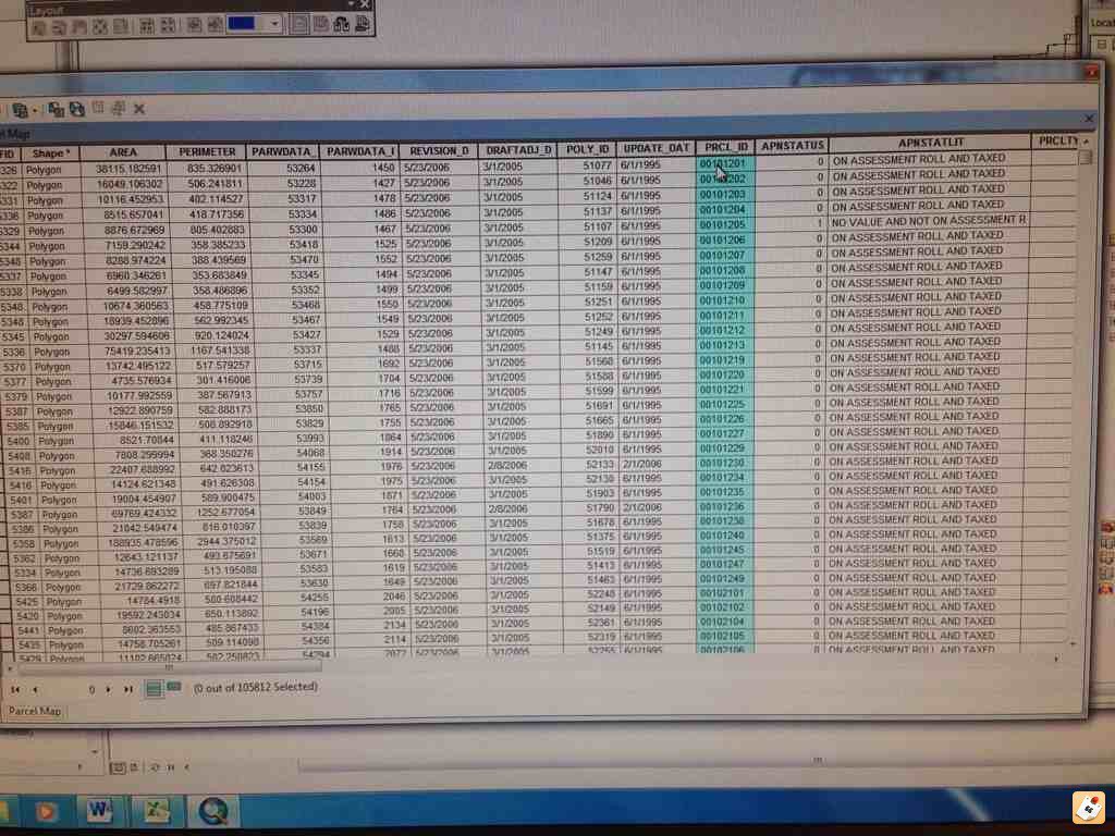

    You need to do a Join of the Excel Table to the Existing shapefile you have. Base the join on the Parcel numbers.
    Are the parcels you need already included in the existing shape file?

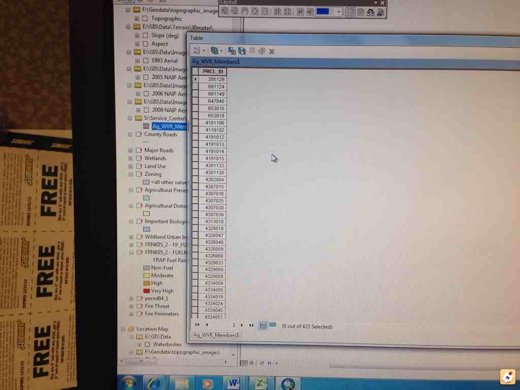

    yep they are all in there but when i tried to do a join it would not select the parcel in the excel file. It was just blank in the drop down box :/

    Gis cant read unformatted excel tables. In excel create a new field and call it ObjectID and make it first column. Save and exit out of excel. Restart arcmap. In arcmap add excel spreadsheet to map. Right click on your existing shapefile or newly added excel file and do a table join. Select appropriate fields and follow prompts. Problem solved. Also make sure your field for parcel ids in excel has a header for first line.

    You have to obviously make sure that your header fields are not using reserved words etc etc etc.
    I always make object id fields just because it eliminates possibility of any arising issues because of it.
    In my case when I do table joins worst thing that happens is that it skips records which gives me a clue that not all records are the same. Look at what you have, make sure that naming conventions match and do qaqc on both shapefile and spreadsheet.
    Another thing to consider is that joining is very finnicky. For example 00049 =/= 49 and " 49" =/= "49" and "49" =/= "49 "
    Find a record that you know to be "same" and cross reference it between spreadsheet and shapefile. Another thing you can do is based on your license level you can try running something like a table compare tool. Also make sure that your numbers are stored as numbers in both places or stored as text in both places.
