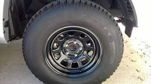

    Here is the wheel, I have a smaller tire on it though, that is a 235/75/15, I have 235/70/15

    At most you have 1.83" (46.7mm) more poke. Not 4 inches. This will cause more wear but I feel it's not enough to worry about.
    Stock wheels are 15x6 +34
    Cragers are 15x7 +0 or +6

    Backspacing is measured utilizing the inner wheel. That means you have approximately 3" of "visible wheel lip" if you have a 7" wide rim. Obviously the amount of "lip" is dependent on rim design and is a bad method of measurement to correctly calculate backspacing. There are good diagrams and explanations online as well on this subject.
