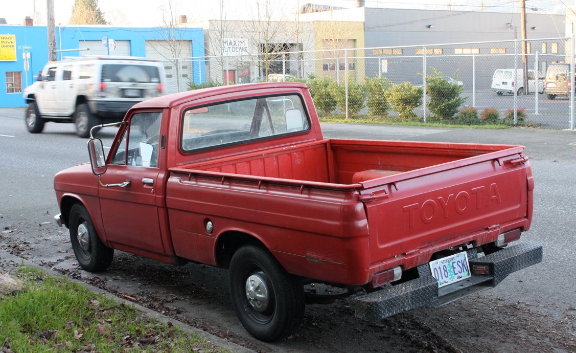

    Fifty years ago, Toyota pickups had a "cam over rear tailgate latch" on both sides.
    The beds were single-wall, dented easily, and super lightweight. That cam over lock helped stiffen it going down the road, but people wanted a one-hand opening (center latch).
    When I first got my truck, I noticed just easily pulling on the side widened the tailgate gap! Oops, seems funny to remember my 1971 truck.
    A random photo reminds people what we old gray beards are rambling about. Drum brakes all the way around, 60 hp, and took about a minute to get up to 60 mph. I got about 25 mpg, but was worn out after a three-hour drive!

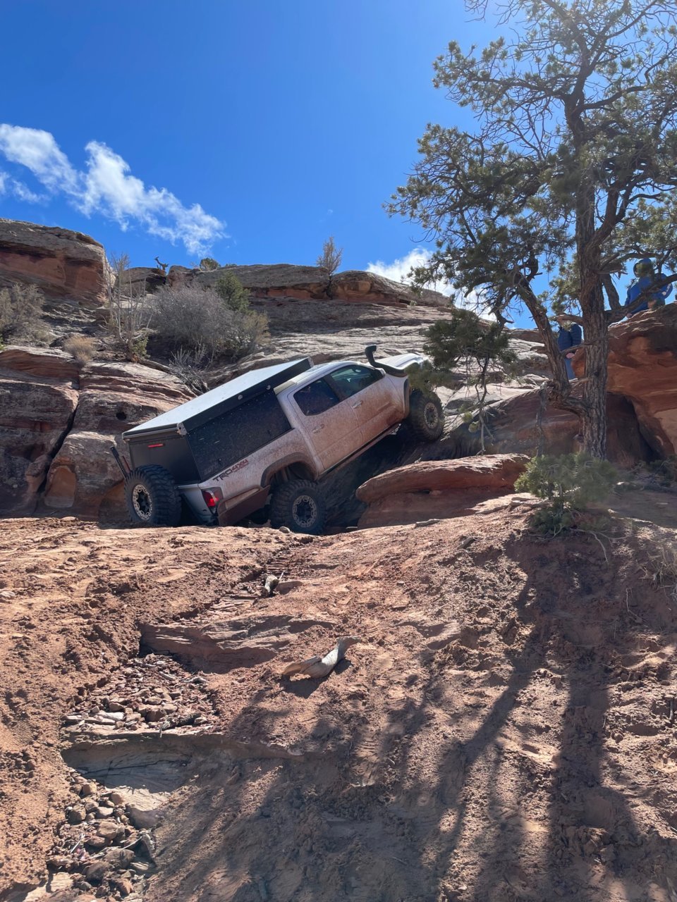

    Moab style climbs won’t do it. Too little time spent on the incline. Face it the other direction on a longer decline, especially with driver side tilted down. Guarantee you’ll see it.

    Like the Devils Staircase on Broken Arrow in Sedona? A descent that a Tacoma does probably once per day, at least?
    Or does it need to be steeper than having your wheels locked yet still sliding down the ledges?
