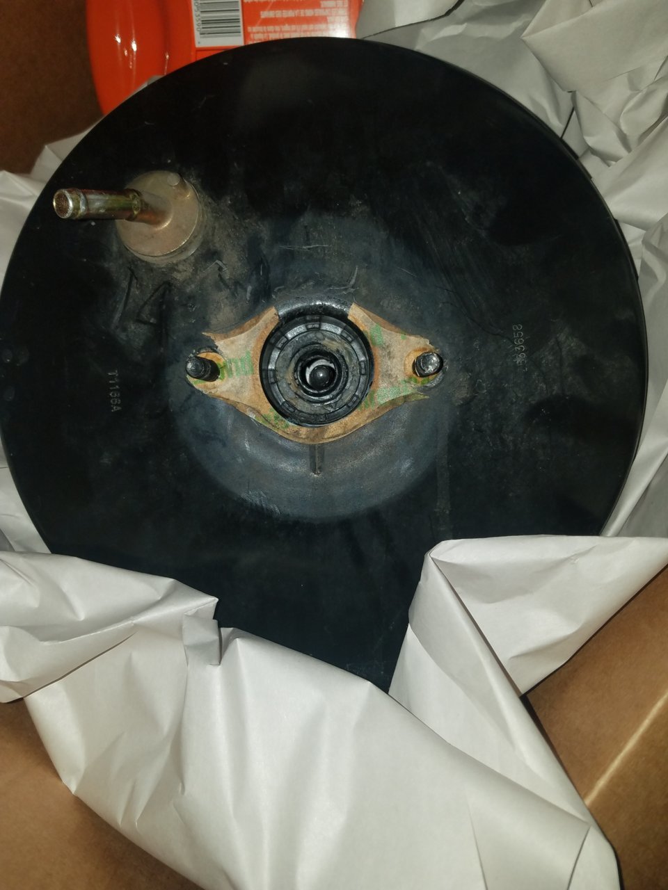

    yah. there was a paper gasket for sure. the old one was ripped. There are 2 bolts connecting the mc on and no abs20201025_094720.jpg

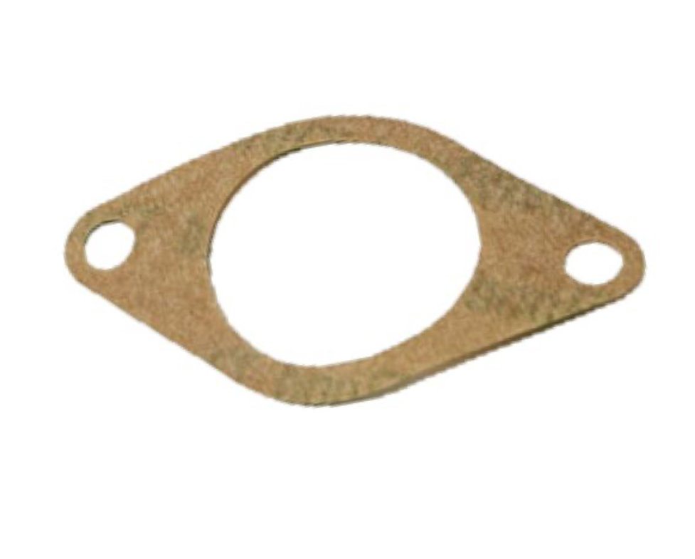

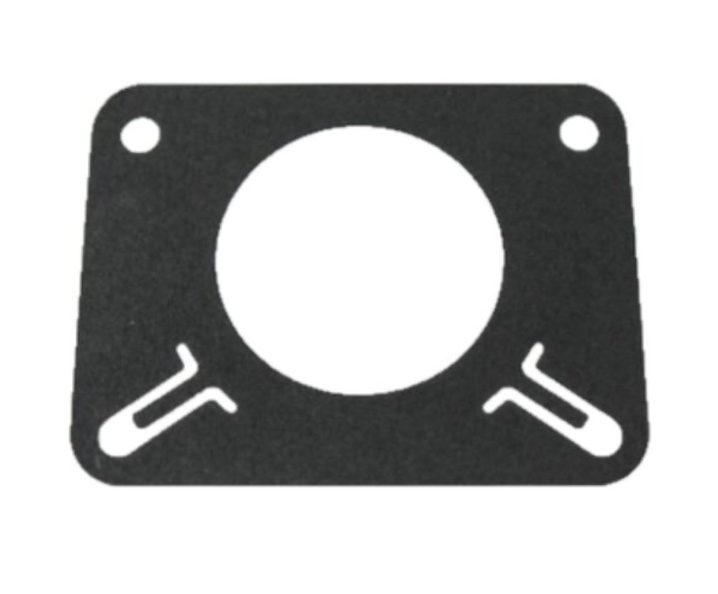

    Just as an FYI to anyone who finds this thread. I bought a remanufactured brake booster from O’Reillys and I was missing the paper gasket between the master cylinder and brake booster. Toyota PN 47275-12020
    I also replaced 2 black gaskets that are separated by a metal block. It’ll make more sense once you take it apart. Toyota PN 44785-0C020.
    I was noticing that I could brake, but man I had to push a bit harder than necessary to get the brakes to engage which suggested a vacuum leak in my mind. Took it all apart and added the 3 gaskets and it’s back to normal.

    I recently changed out my brake booster and I made my own paper gasket from a cereal box

    That gasket doesn’t hold air pressure - it’s only to keep debris out of the mc / booster connection.

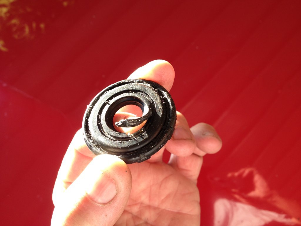

  17. Mar 16, 2025 at 10:10 PM
    #37
    Glamisman
    Glamisman Well-Known Member
    Oct 22, 2016
    #200436
    4,855
    This just popped up on my PC... the seal that I am talking about is this seal
