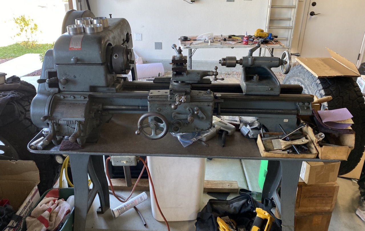

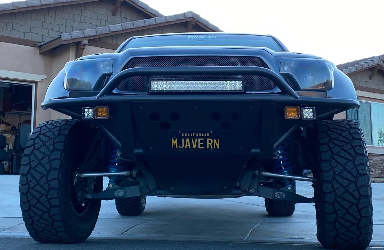

    I made these
    On this 1949 Logan Lathe
    And put them on my truck

    Wow - did you do the tapers with the compound feed? Those came out beautiful. And there's nothing better than making a part and putting it on your truck, imo.

    I Did. Just calculated out the taper on some web page taper calculator set the angle on the compound and hand fed it. I was vey surprised how nice they came out.

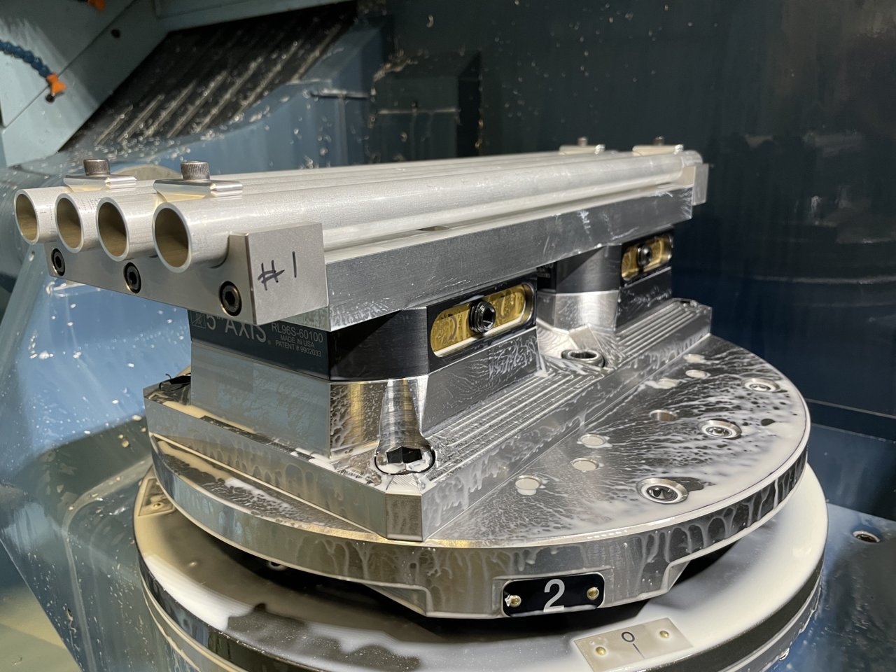

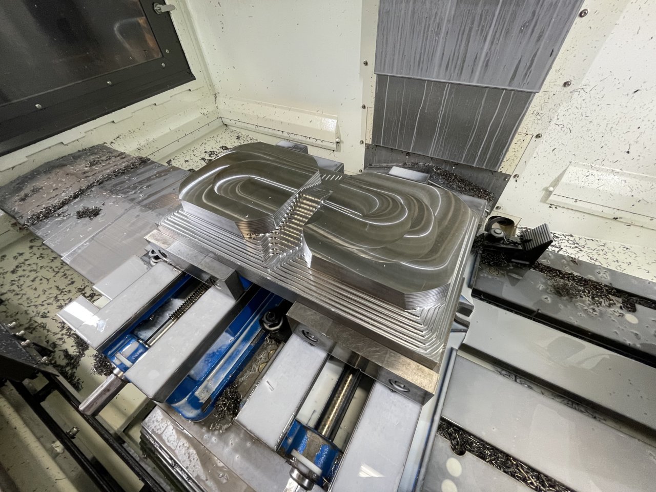

    Hello fellow machinists.
    Heres some fixturing i did a little while ago.

    Those are some serious machines. When you set up two vices like that do you indicate them both in or clamp them both to a big straight bar and indicate them as a unit? I just tried a dual vise setup for the first time and somehow fucked up my first try.

    Thanks, I love fixturing. It when i get to go all out and try some stuff i wouldn't normally get to do.
    i have a 2ft piece of 1x3 ground stainless that was bought for a EDM fixture but never got used.
    I’ll clamp it in both vices loose on the table, tighten 1 toe clamp and indicate in both vices at the same time.
    then any additional vices I’ll clamp the bar in a vice thats already clamped then clamp in the vice thats loose, verify its 0 then clamp it down
    i just setup 4 vices within .0005” over 50 inches earlier this week using this method.

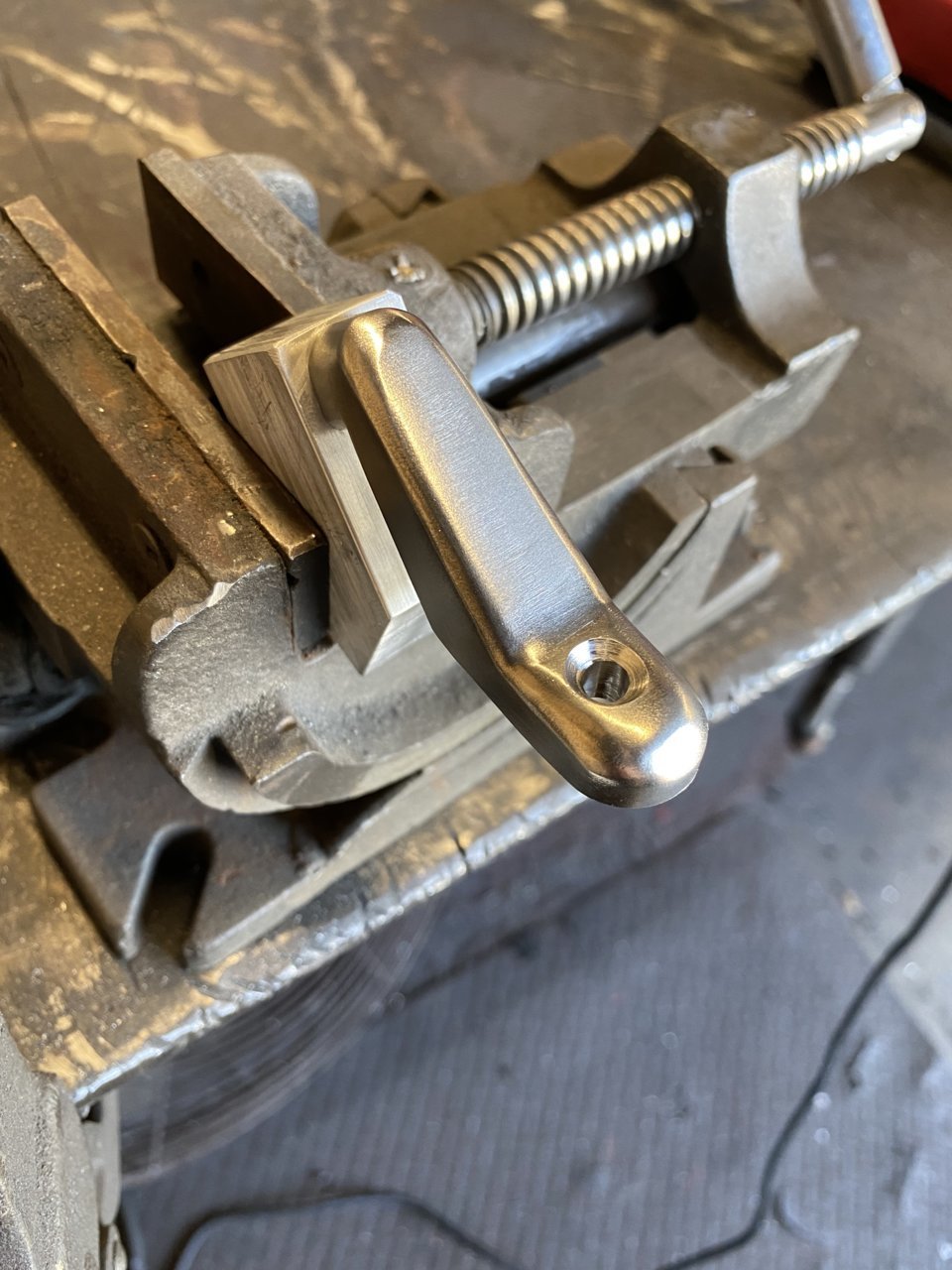

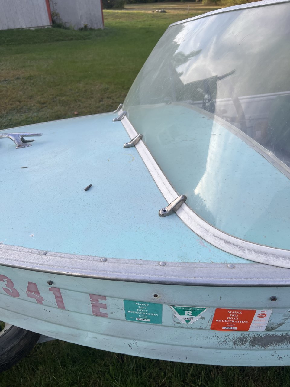

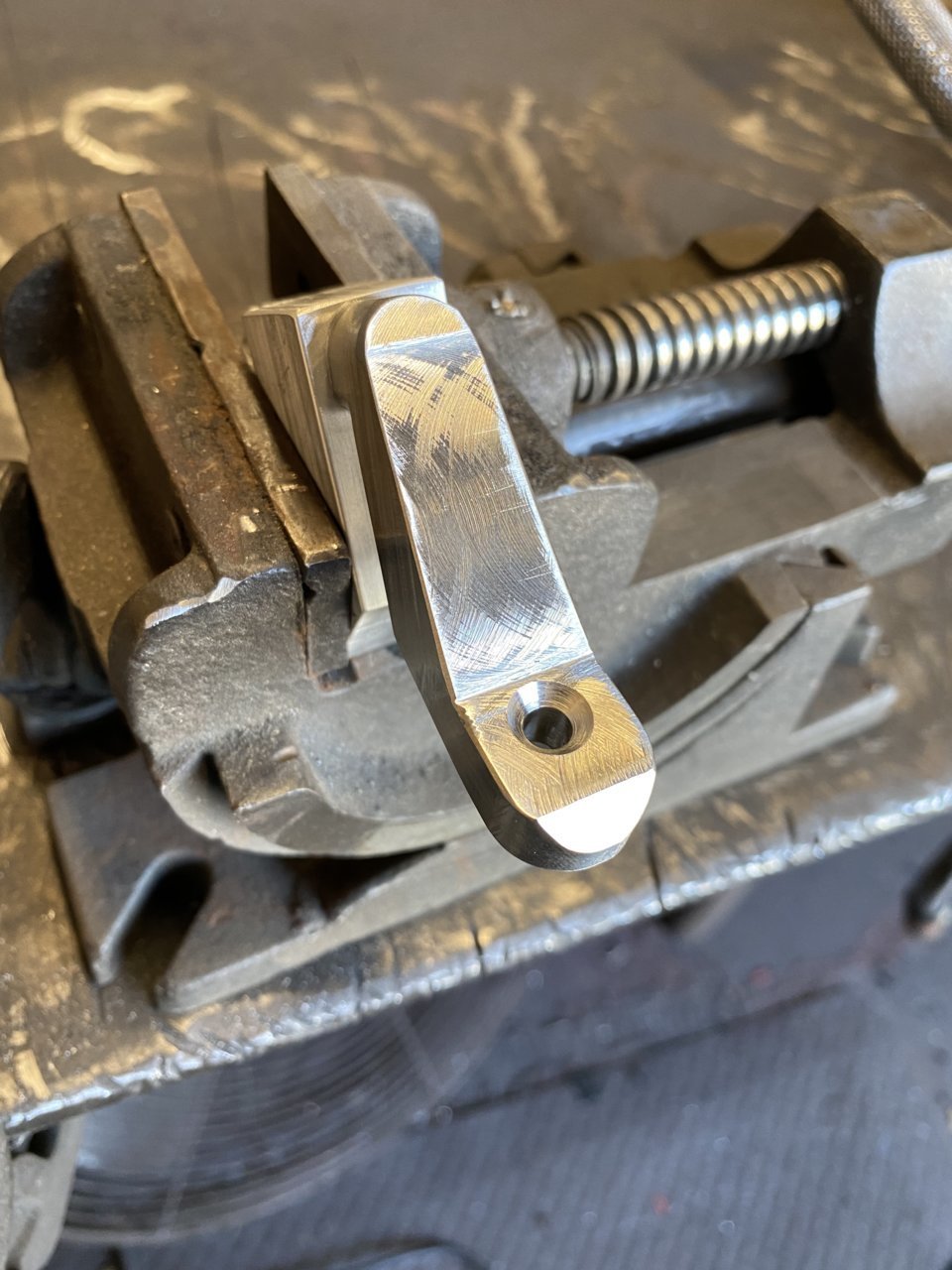

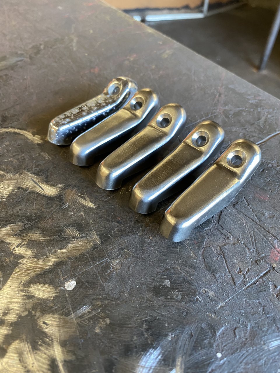

    @cory02taco sent me one of these off of his boat windshield for his boat his grandfather gave him many years ago for a pattern. He was missing 2 so I made him 4 new ones so they’d all match.
    Little CNC, little manual milling, lot of hand work to finish. 316 stainless.
