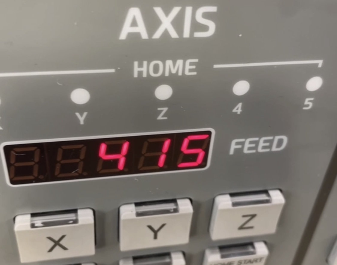

    Breaking in a new machine by hitting a new personal record this week
    7075 alum
    5/8 3flute endmill
    415 IPM
    12000RPM
    1.1” DOC
    .156 WOC
    .01 FPT
    just finished hooking up the air cleaner this morning i couldnt wait any longer lol

    What material?
    I usually stick to 15-20% radial for aluminum but i need this cycle time to be fast to be able to feed the next operation.

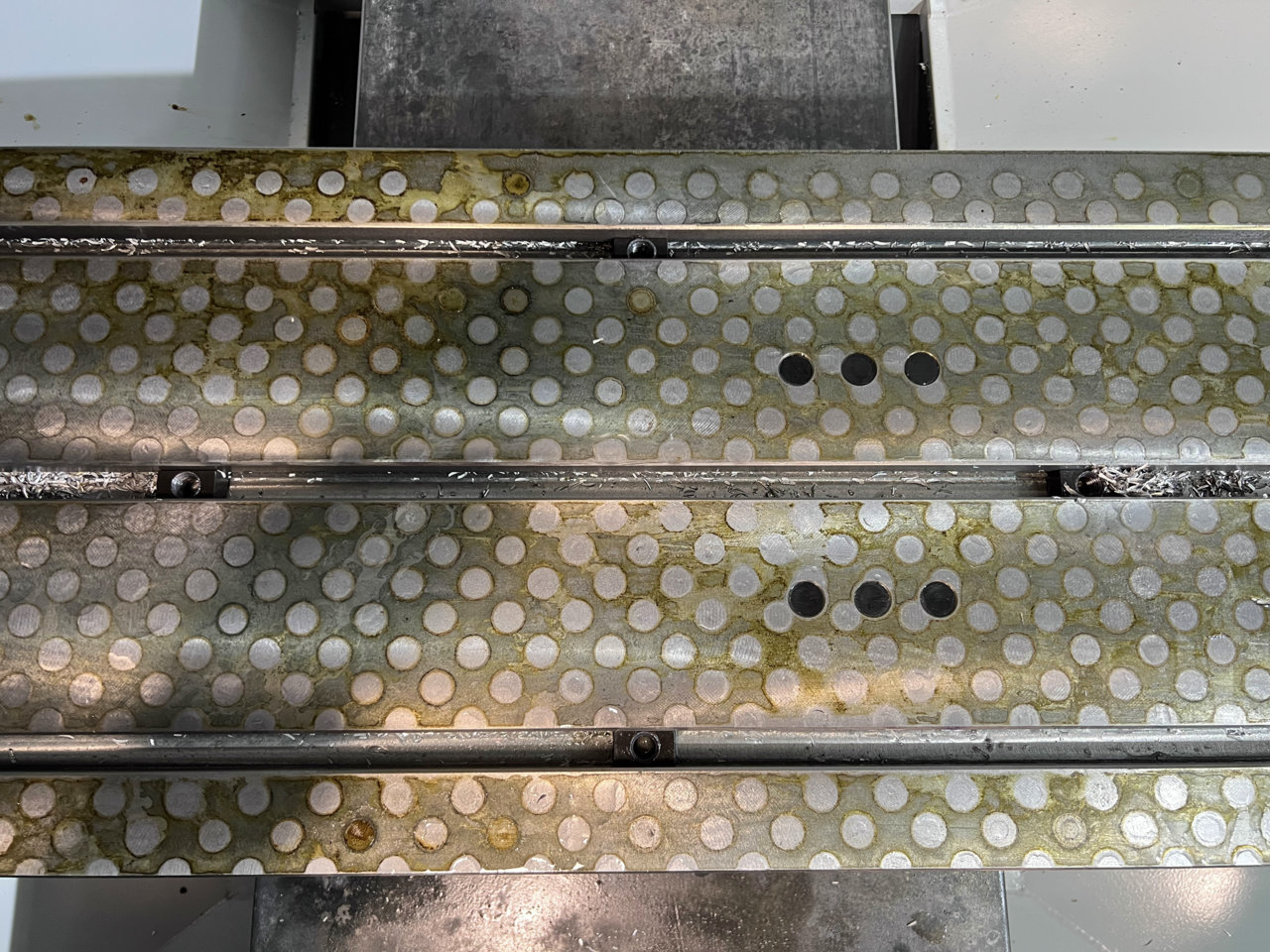

    My setup is a Haas MiniMill2 without most of the bells and whistles. I did get WIPS, the chip auger, and TSC ready (for resale) but were I to do it again, I would have skipped the TSC and added the 10k spindle. I'm beginning to think I may need the HSM option if I want to push faster adaptive tool paths. I understand there's a way to get a 200hr "try" on those unlock options... I'm going to look in to that, for sure!
    I'm currently about to switch coolants. A true bummer. I started out with Synergy 735 - sounded like a good option since my machine sits idle for weeks at a time. But Haas cheaped out on the way covers and tool changer panels and they are not compatible with it. Corroded mess. I'm going to switch to Qualichem 251C and hope I don't grow smelly organisms!

    We’re using 735. We all hate it.

    It corrodes everything, gunks up measuring equipment really bad, burns like a mfer if you get it in any cuts or your eye, and it’s a lot harder to get off of parts compared to other coolants I’ve used.
    If you’re running a job pretty hot and burning it off it really messes with your lungs.

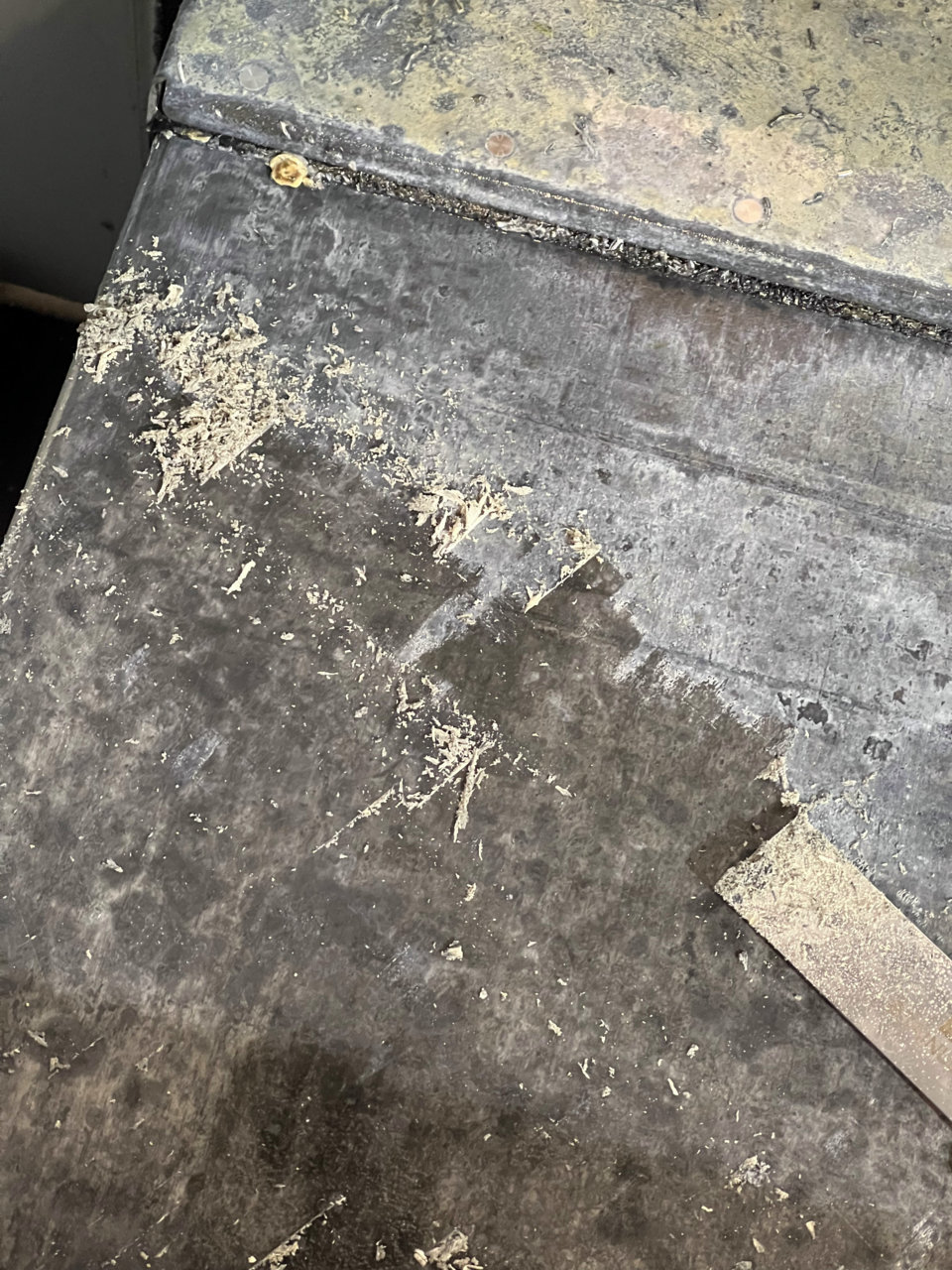

    Can I quintuple like your post? UGH! I have been fighting it, reluctant to change because waaaaay out here in the boonies it's going to cost around $800 to dispose of it. I run a fixture plate and took it off about 4 months ago to check for rust and clean everything (the toolchanger's shutters were getting stuck open) and this is what it looked like. I got it mostly cleaned up but it's already pretty bad again, so I'm just done. All my tool holders, vices, etc have stains too. Ah well. I have a rag soaked in LPS2 on standby and wipe everything down when I pull it out of the machine. Qualichem, here I come.

    Have you guys tried any other Blaser lines? I think we run the 25-md (ill have to check Tuesday) and haven't seemed to have any problems with it.
    Stains the tables a bit if the fixtures are left on the table for a long time. and the mist is pretty pungent if you forget to turn the mist collectors on lol but i assume every coolant is like that?

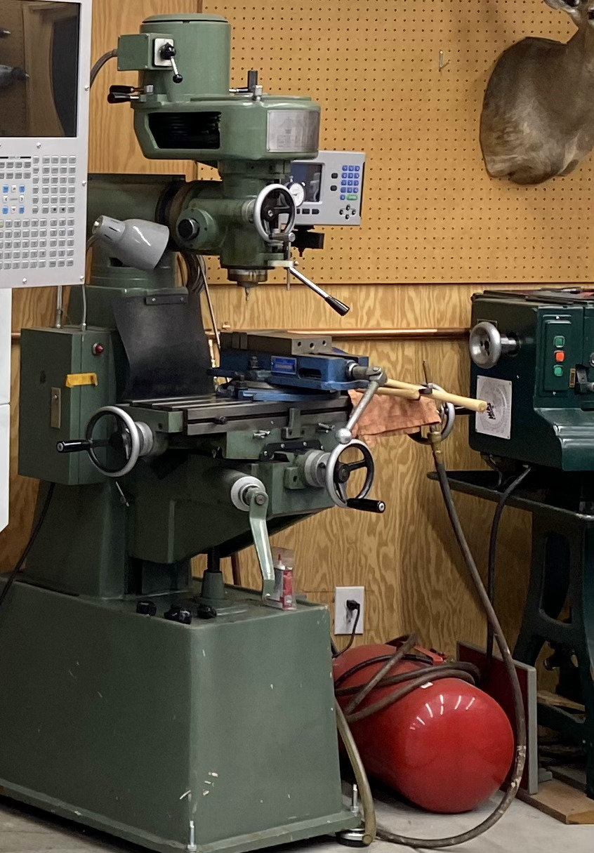

    I think this is the next project... This was my Dad's until he gave it to me in the 90's. Then I loaned it to a friend who was starting a business in Seattle. (I didn't have a place for it) They didn't do a great job of taking care of it - but whatever. They broke the knee crank and roached the collet screw in the spindle (at least I hope that's all they screwed up). I put a DRO on it a few years ago, but the solid state phase converter and it's two-speed motor don't get a long. Then I got the cnc and progress on fixing it up stopped. But I like having a manual mill, so it's time to finish the job of getting it back up to snuff. It is square and holds a fine tolerance. Here's the plan:
    - replace 2 speed switch with electronic variable speed control/phase conversion.
    - make a new knee crank
    - remove/inspect and try to refurb the spindle (this one worries me)
