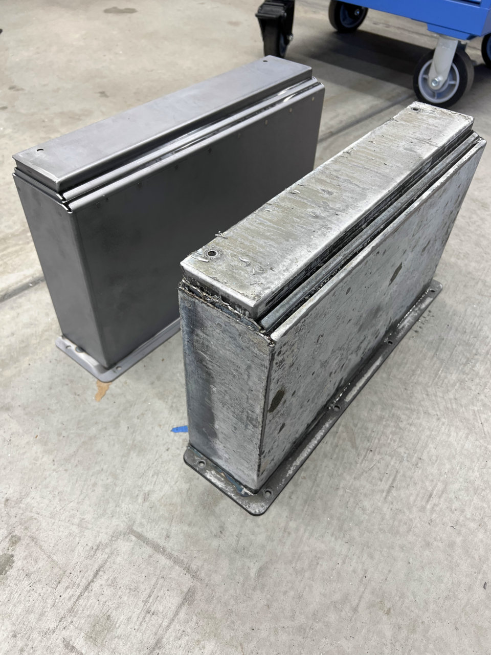

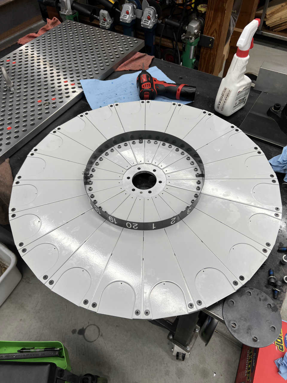

    So, in a totally unexpected move, Haas/Selway warrantee'd my rusty way covers and I now have a set of those and a set of covers/doors for the umbrella tool holder! Gonna spend a couple days inside my machine with my bike helmet, a pile of white scotchbrite pads, and my foulies. Can we say FUN TIMES??!!!

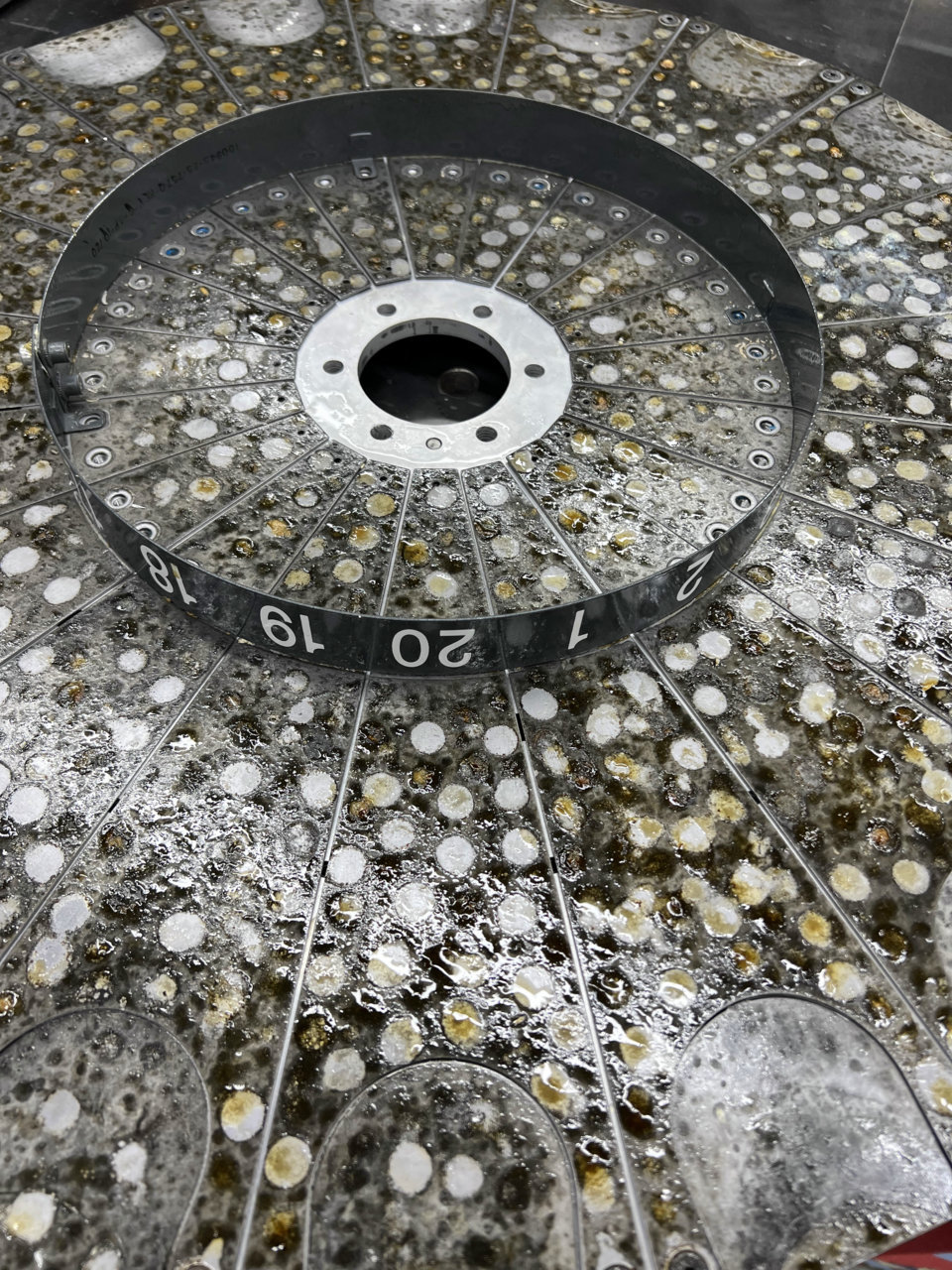

    The folks at Qualichem were also super and sent me a pail of the cleaner. So, 250c going in. Anyone running a Nexjen separator or some kind of skimmer? It was suggested I get something to remove oil and aerate on a timer so it runs for a couple hours a day to prevent creatures...

    We run a couple zebra skimmers, theyre ok. We havent had any skimmers that work perfect on their own. The best thing is to use a shop vac.
    Hold it just above the coolant just high enough to get the oil.

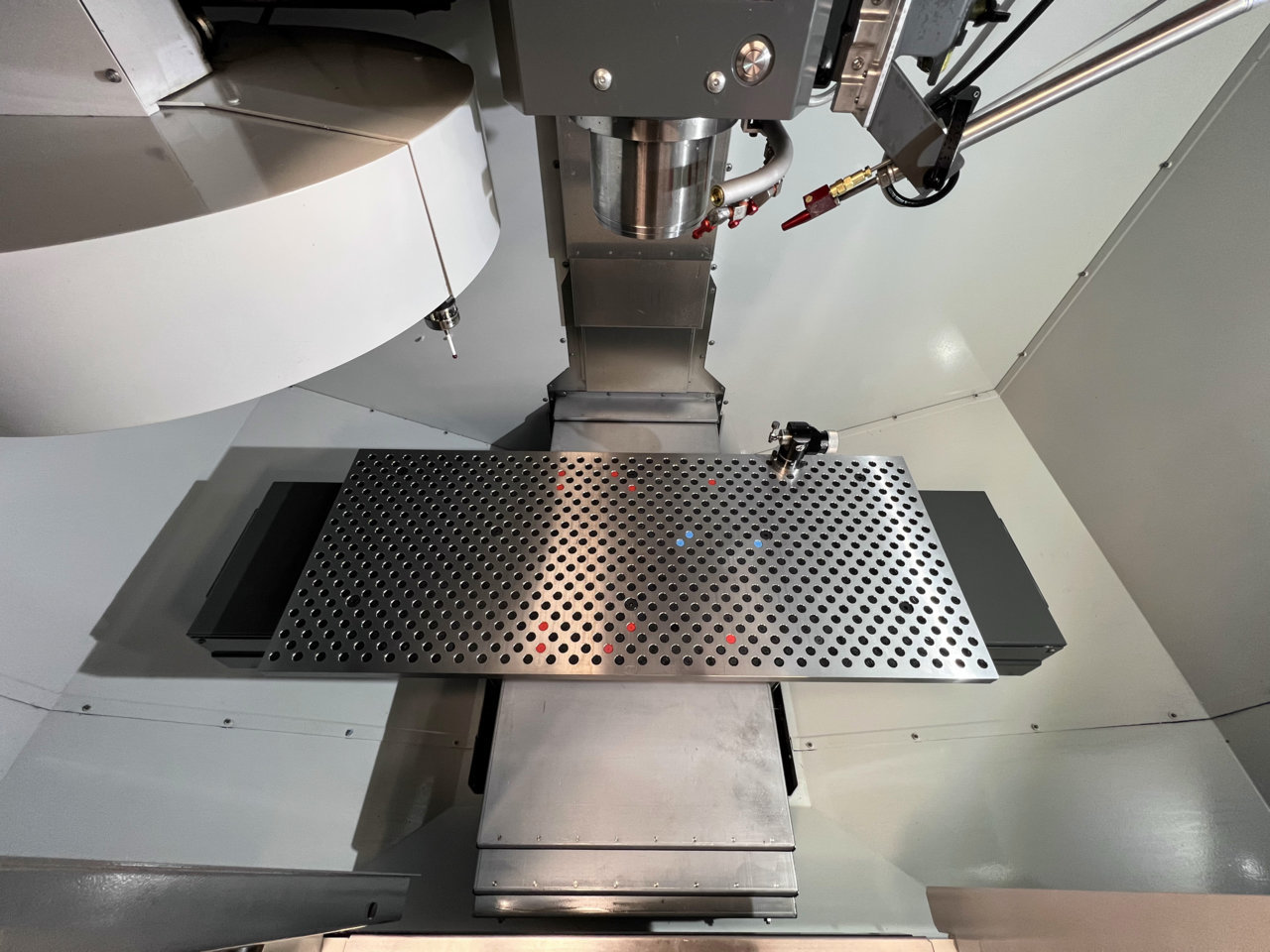

    Well, I took my old crappy shop vac and sacrificed it to the coolant change out gods. 55 gallons of water, and a barrel and five 5 gallon buckets of waste later, I have a sparkly machine with new coolant. I just have to replace the way covers and the tool changer cover and all evidence of that 735 will be gone!
    But man, the mini mill is not fun to clean out. It’s sump is integral to the base of the machine and so you have to get down on all fours and reach inside to vacuum, scrape, and wipe all the crap out that’s in there. I’m too old for this lol!

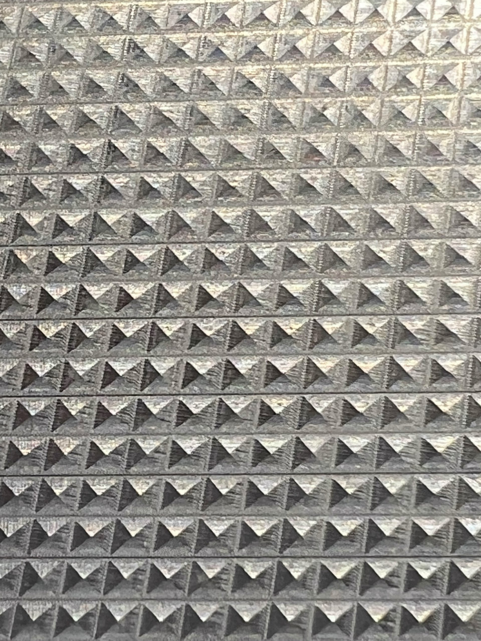

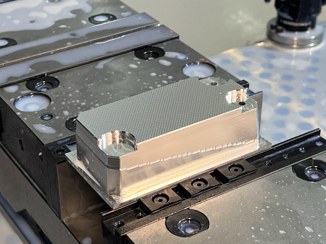

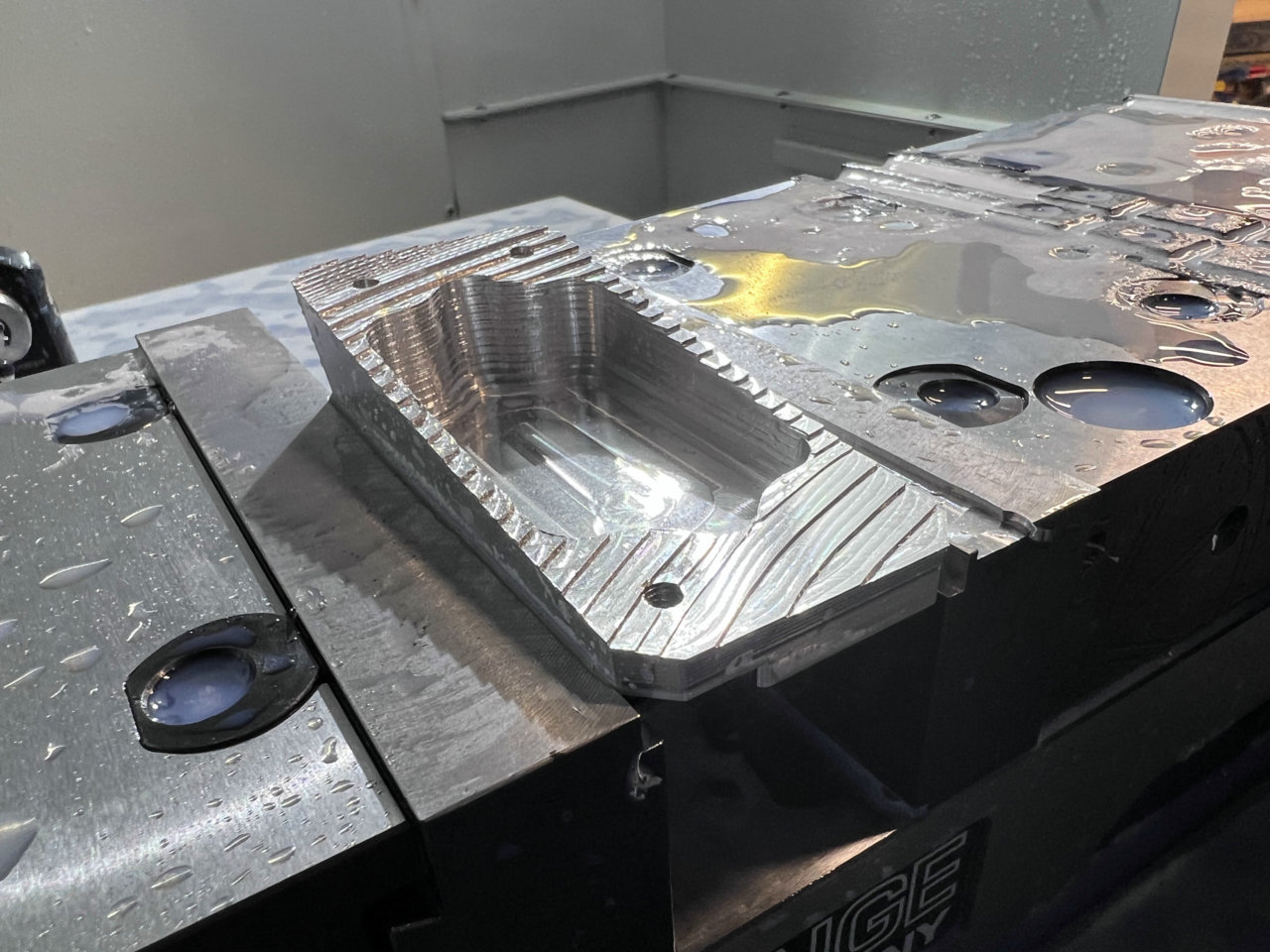

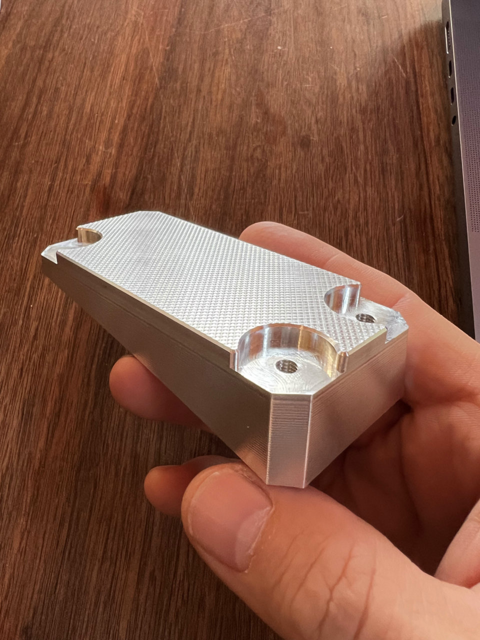

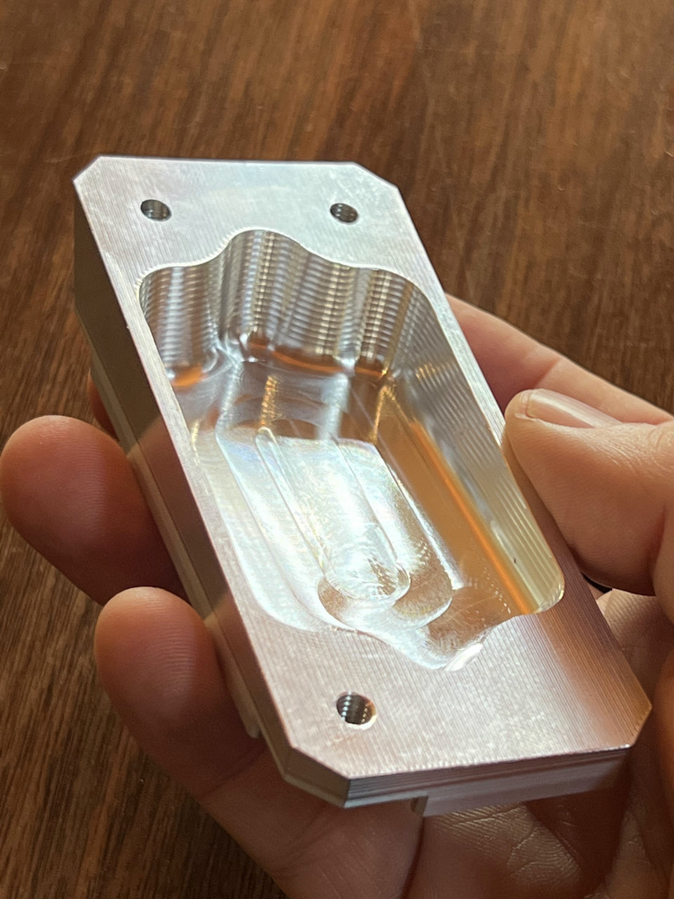

    This thread needs some pics! What have y'all made lately?

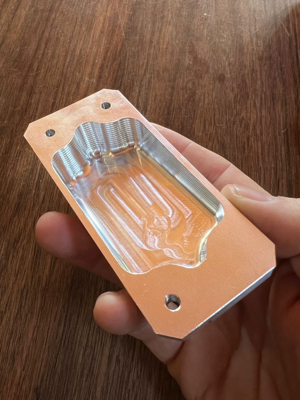

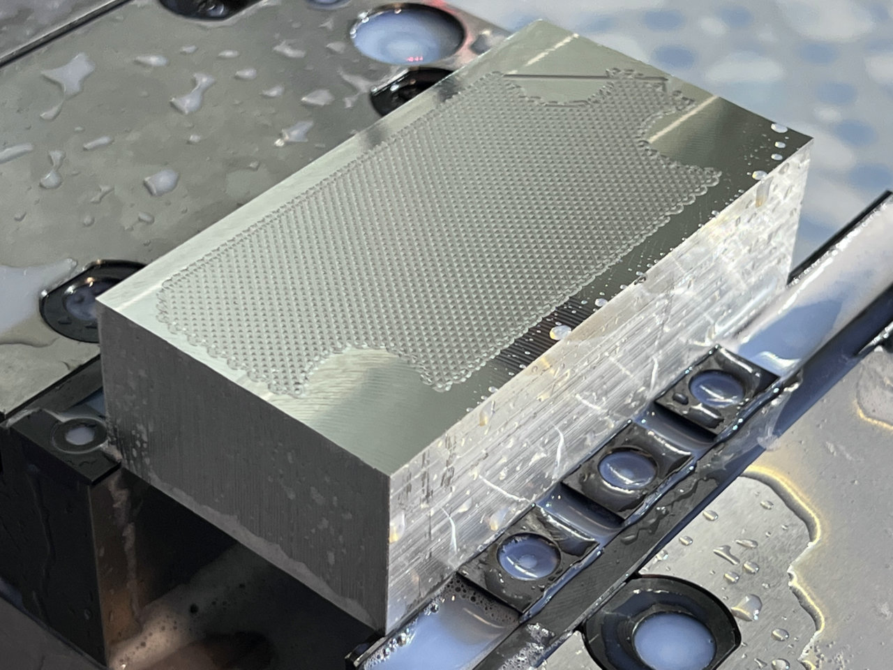

    I had this silly idea for a thing for the truck (a level-able platform that I can lay my iPhone on to check if my truck is level for camping) and tho this is a totally stupid idea, the part looked fun to machine as I have done very little surfacing with ball end mills and thought this would be good practice. Turns out that part was all easy, I just need to remember to check my z-depth. Sorry, vice jaw...

    What did you use for the “knurling” on top?

    Oof. I am just glad to have my maintenance all done for a while. Fingers crossed. The crosshatch is a 1/4” ball endmill. I left about .010” and did a parallel op across the top with a big step over.

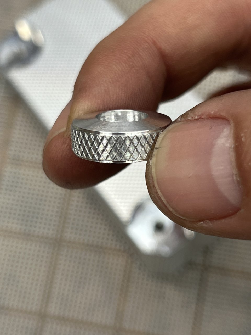

    Fun with the compound slide and knurler… turns out a little math helps! Still I got lucky with how it lined up edge to edge!
