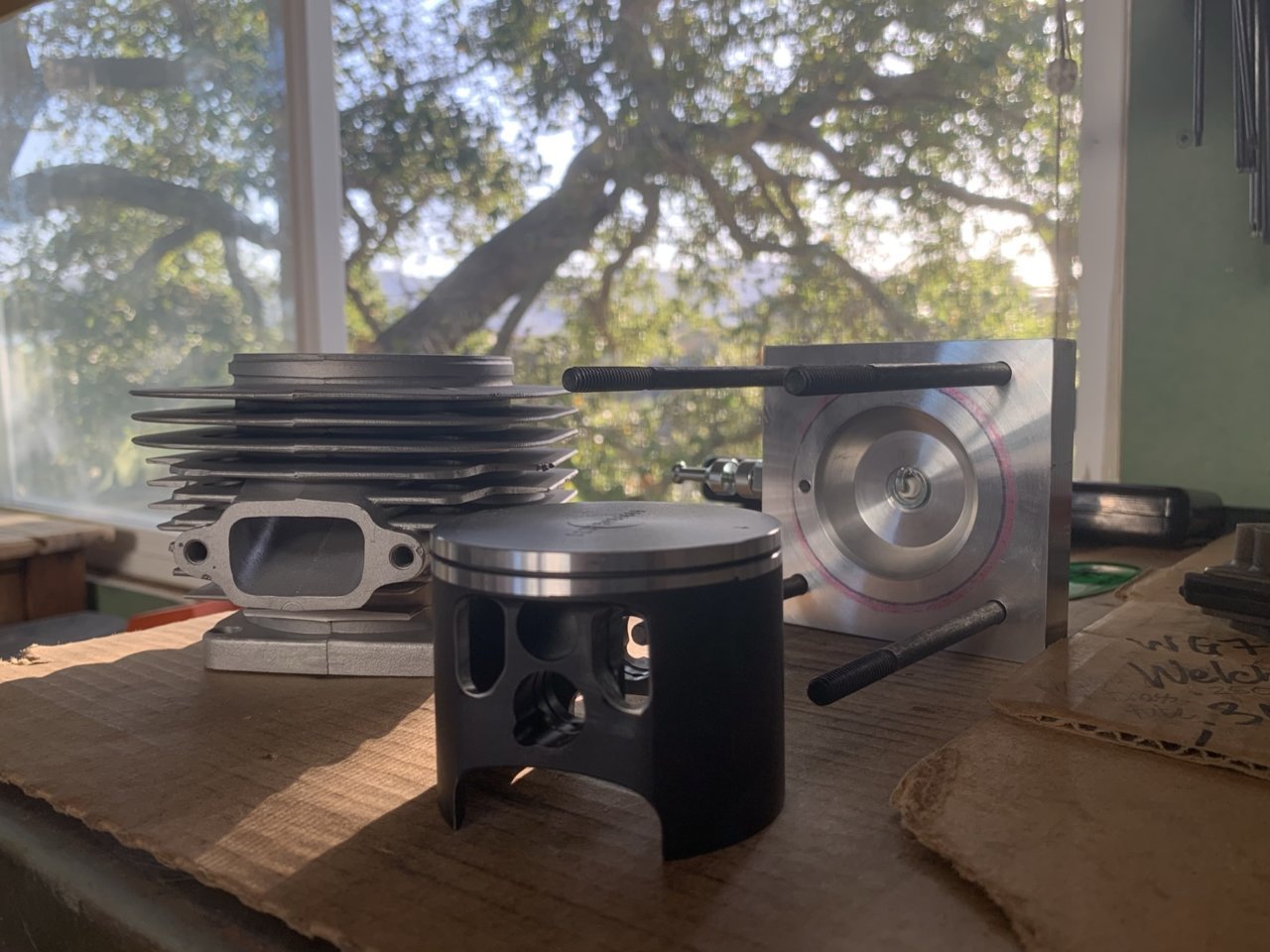

    For you chainsaw freaks!

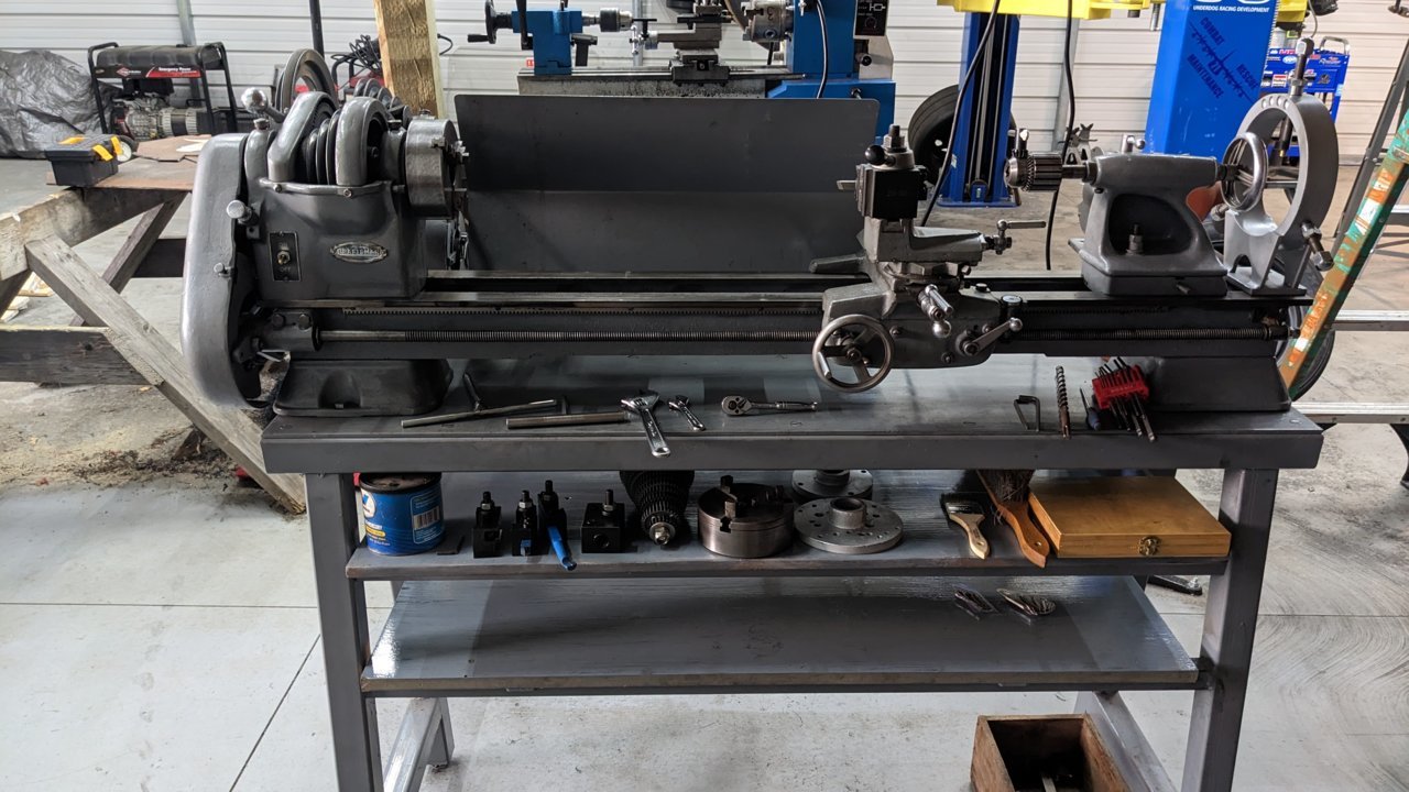

    Very cool. Looks like my Logan. Model 820 built in 1949. Think there is a pic of it on page 1 or 2.

    Thank you, it’s fun times behind the handles. It’s cool to use an oldie but goodie. Yes, an 820. I feel like I’m the keeper now. Going to try my best to keep this slice of Americana going for many years.

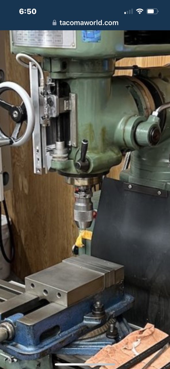

    I've been suffering with a crappy solid-state phase converter for years and recently picked up a new belt sander (from Ameribrade - AWESOME) and it had a really nice speed control on it. I looked at the speed control company's website and they make 2-phae to 3-phase converting speed controls. About $400. I bought one. Fried it being a dumb-ass installing it. Sent it out for repairs and just got it back and got it wired up/mounted. I think it's gonna be a GAME CHANGER. We'll see how it does under load, but being able to twist a knob to change RPM is amazing. I can also go backwards now. Bananas!
    Welded up a little bracket to mount it and the DRO.

    Curious if the chuck is the kind that you hand tighten?
    I have one and amazingly I have never had issues with it.
  10. Mar 12, 2023 at 9:15 PM
    #130
    Zebinator
    Zebinator [OP] Well-Known Member
    Nov 30, 2014
    #143381
    918
    Norcal
    06 Tacoma TRD Offroad
    It is. It’s an albrecht. My dad had three of them that came with the tools. I love them.

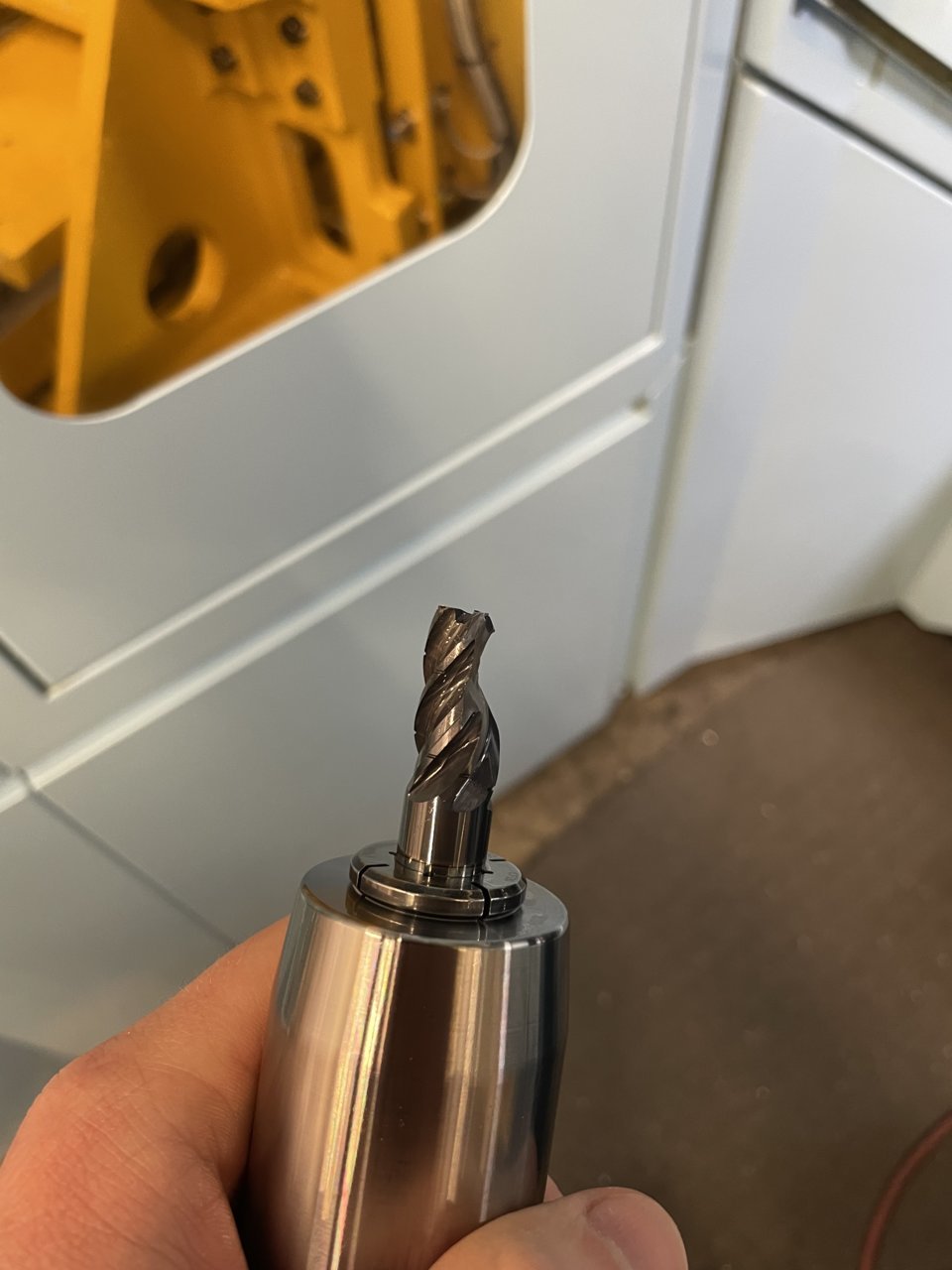

    Figured ya’ll might appreciate this one. Roughed 2 parts like this in 30 Rockwell steel

    Damn, after seeing this, and several from a popular machine shop in OZ on FB, ain’t looking good as I wanted to build a custom recovery point, but the $$$$ are starting to add up just thinking about it. I will definitely need more than one end mill, the cost of the 4130, hardware…and whatever else I’m forgetting.

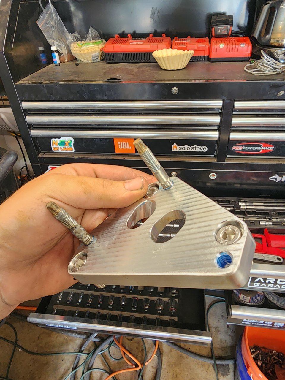

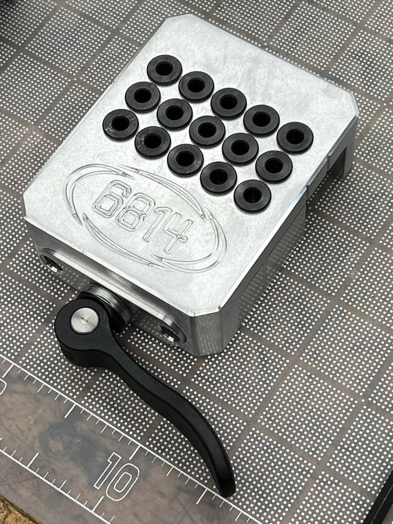

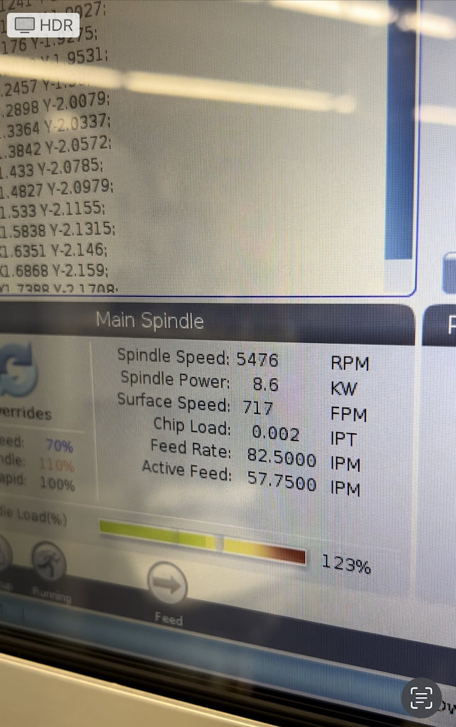

    Been making stuff for my high school robotics team... Started playing with the high speed machining option and pushing the machine a little harder:
    This is a little drill guide for drilling holes in rectangular tubing. Fun little project!

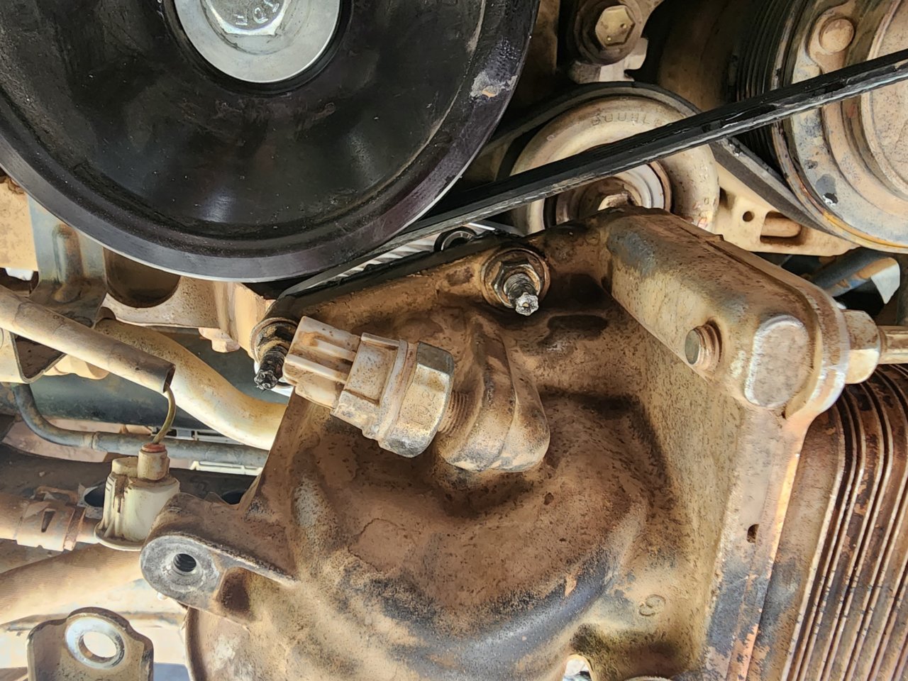

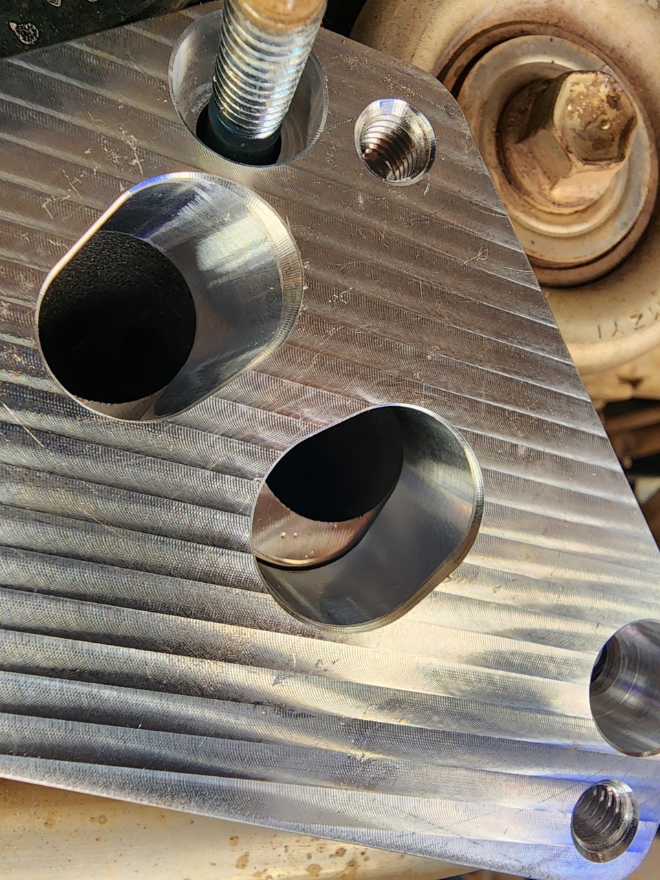

    I had to make this thing from scratch for my used supercharger. Of course the only machined part was missing. I found the positions of the slots and holes on the cmm and just lofted the oil passages the same amount I rotate the holes. A lot nicer than the hack file job magnuson looks to do in their kit. Anyway I was a lead 5 axis machinist but now I'm in machine development and optimization.

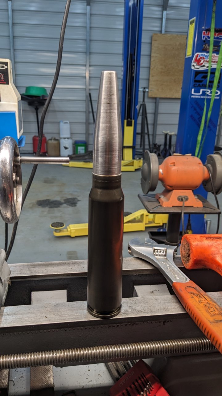

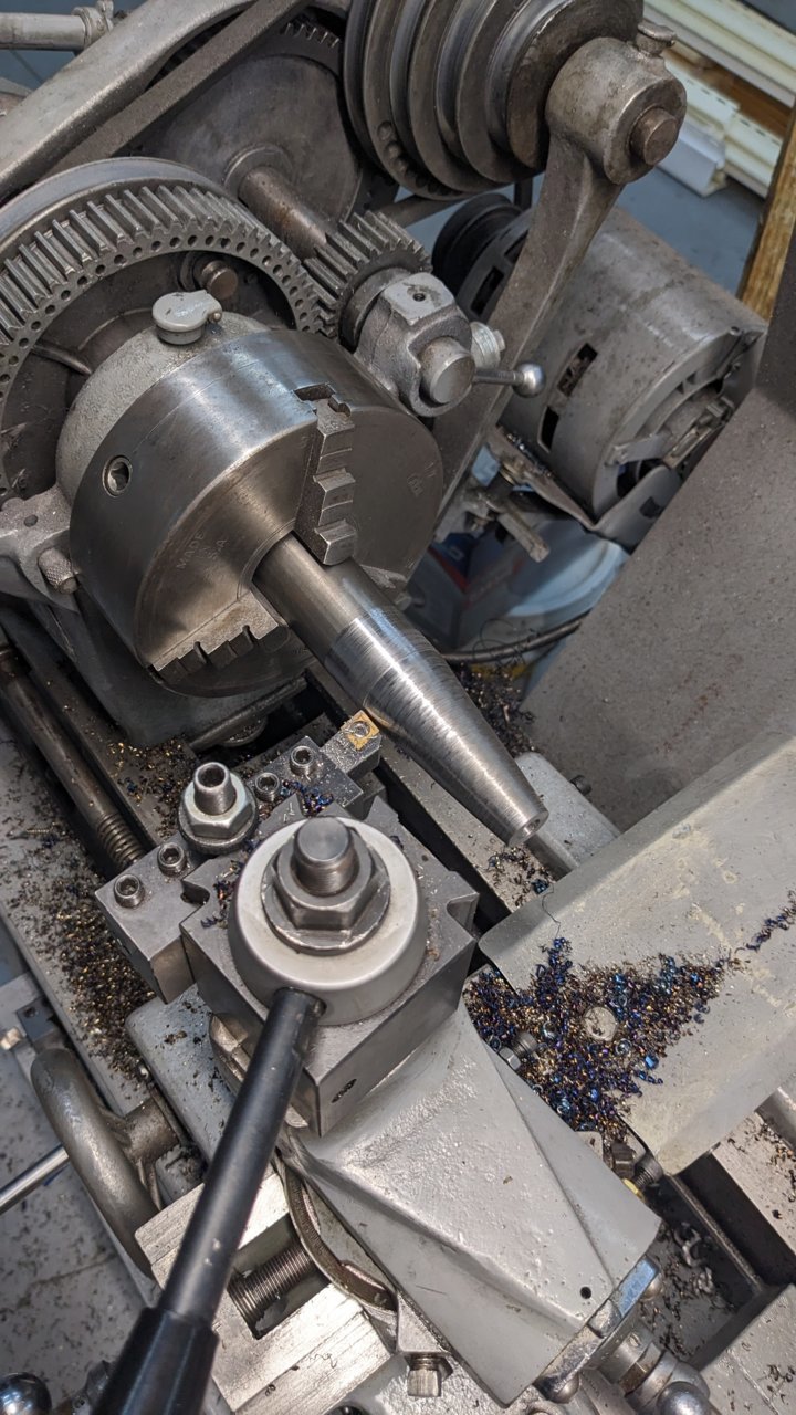

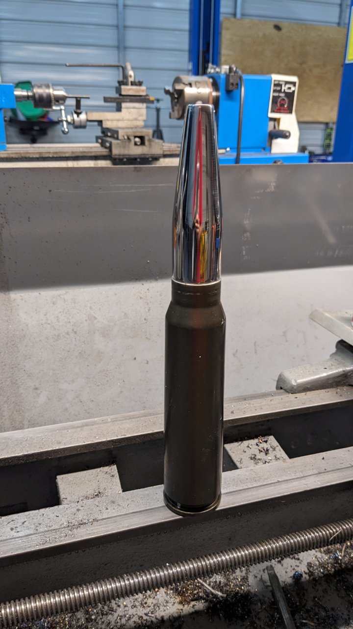

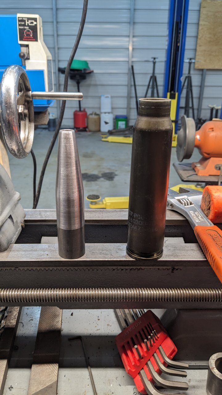

    I picked this up recently. I'm EXTREMELY new to running a lathe. Basically teaching myself after watching This Old Tony and a few others on YouTube. I've made a few things here and there. The mini lathe behind it is eBay junk but got me to learn the basics and really get me hooked on this hobby.
    I learned how to make tapers recently and had some pretty decent success with my first attempt.

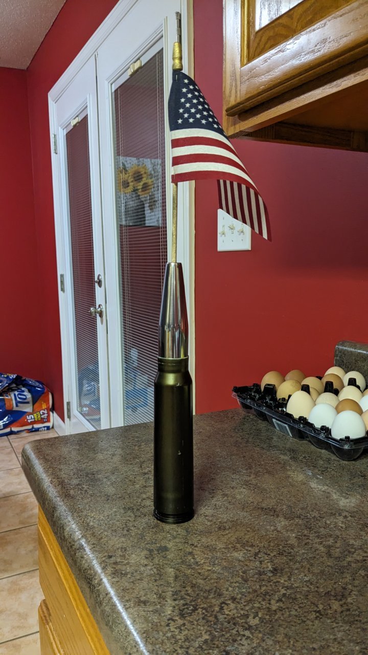

    I made this and gave it to my father-in-law. He was pretty impressed.
