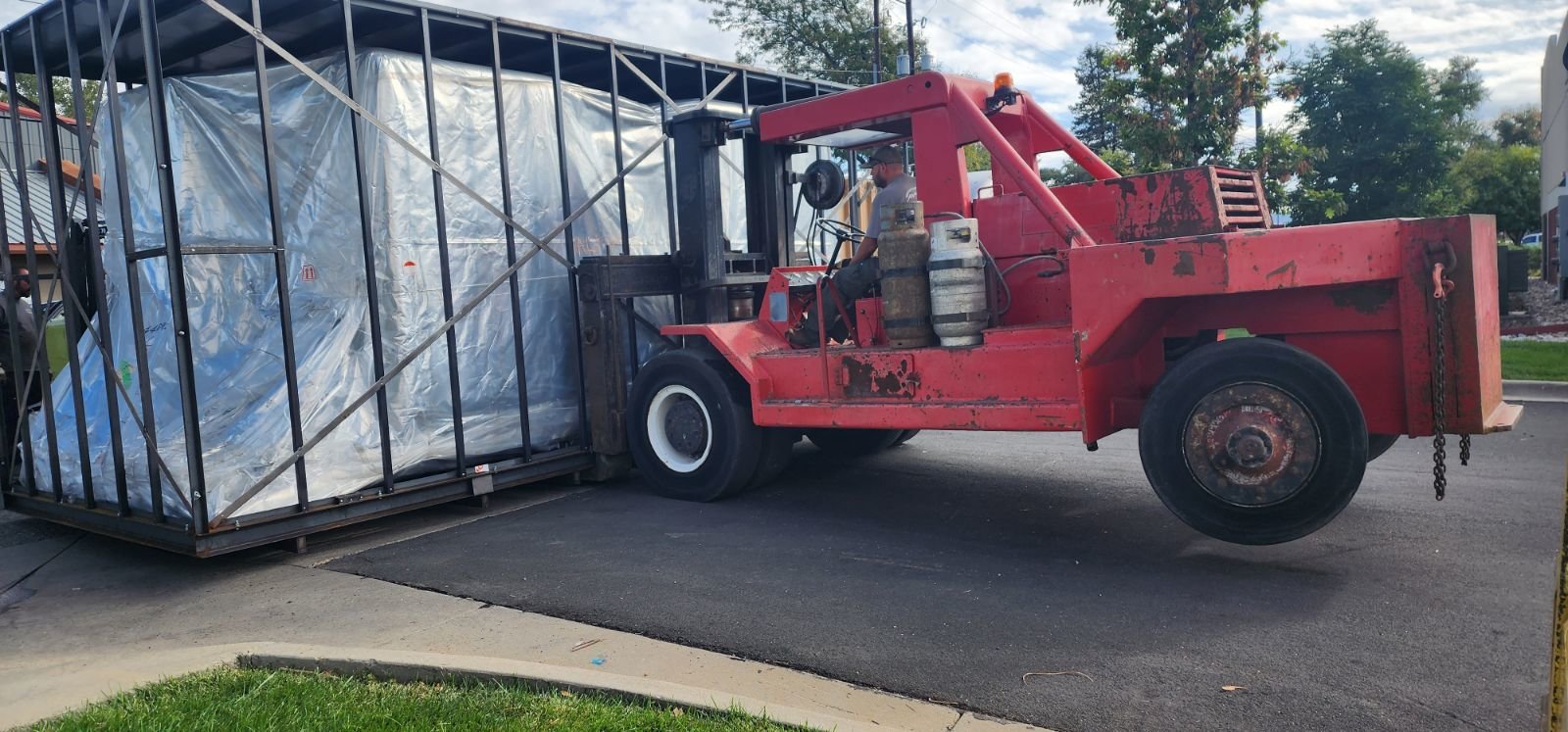

    Finally got the keys to this monster last week. Had to rent another shop because it wouldn't fit in ours lol
    245 tools
    6 pallet horizontal
    Hsk 100
    Zebinator[OP], Airdog and Chadr7858 like this.

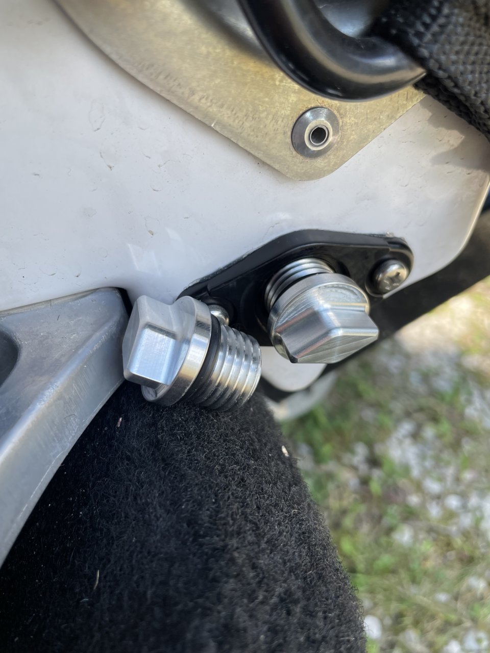

    Quick little government job friday afternoon before holidays.
    Drain plugs fell out of my dads superjet while trailering so whiped up a couple new ones.
    the milling op for this was 1 tool with a 36 second cycle time
    Zebinator[OP], 665.0coupe and SR-71A like this.

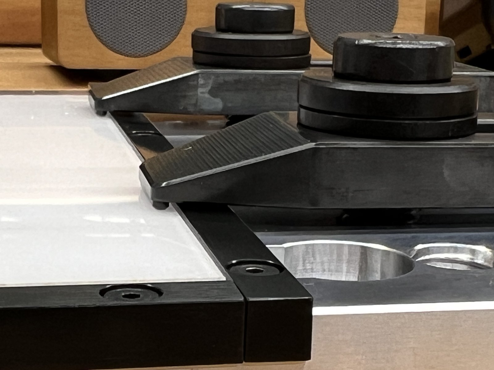

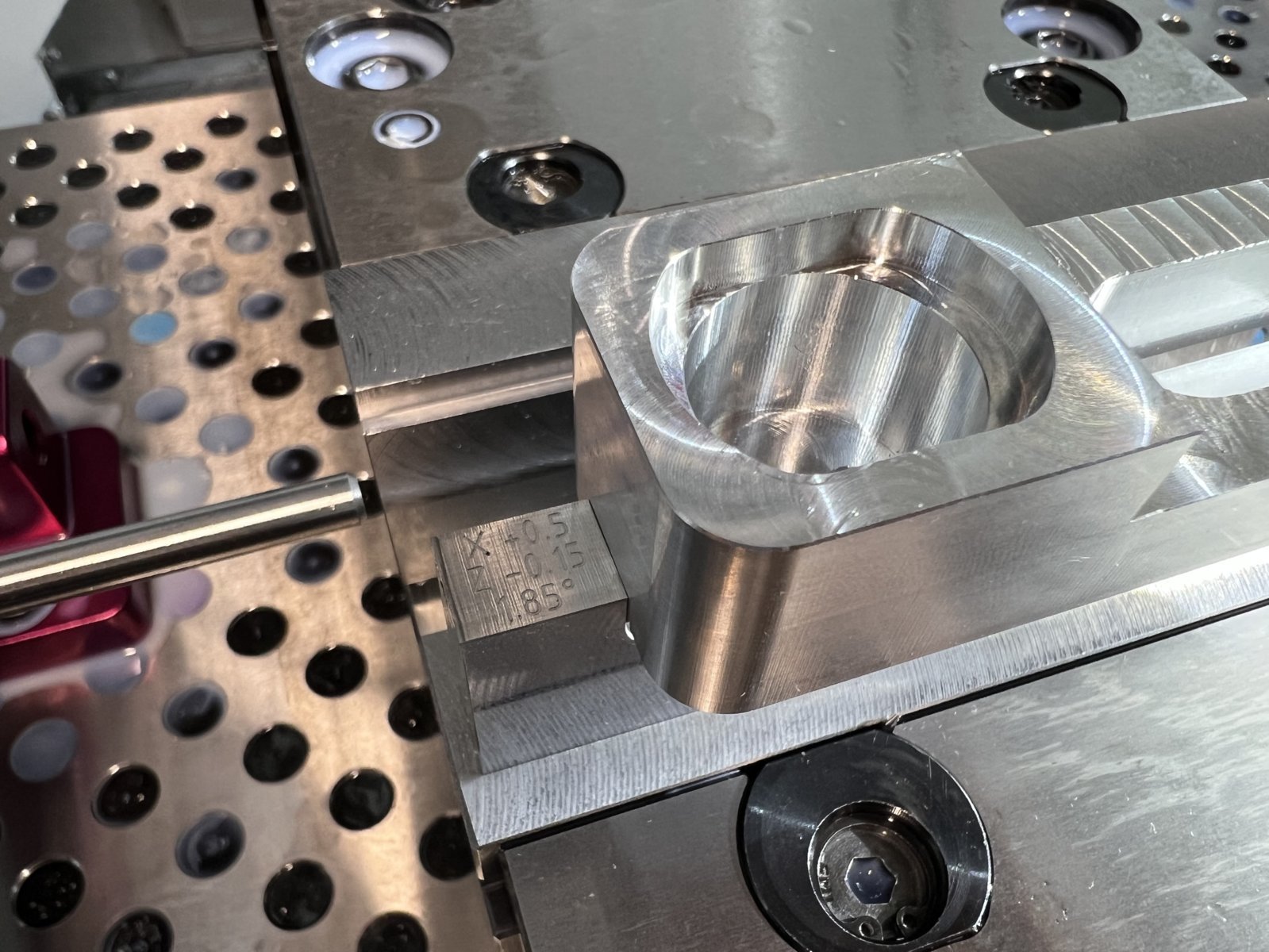

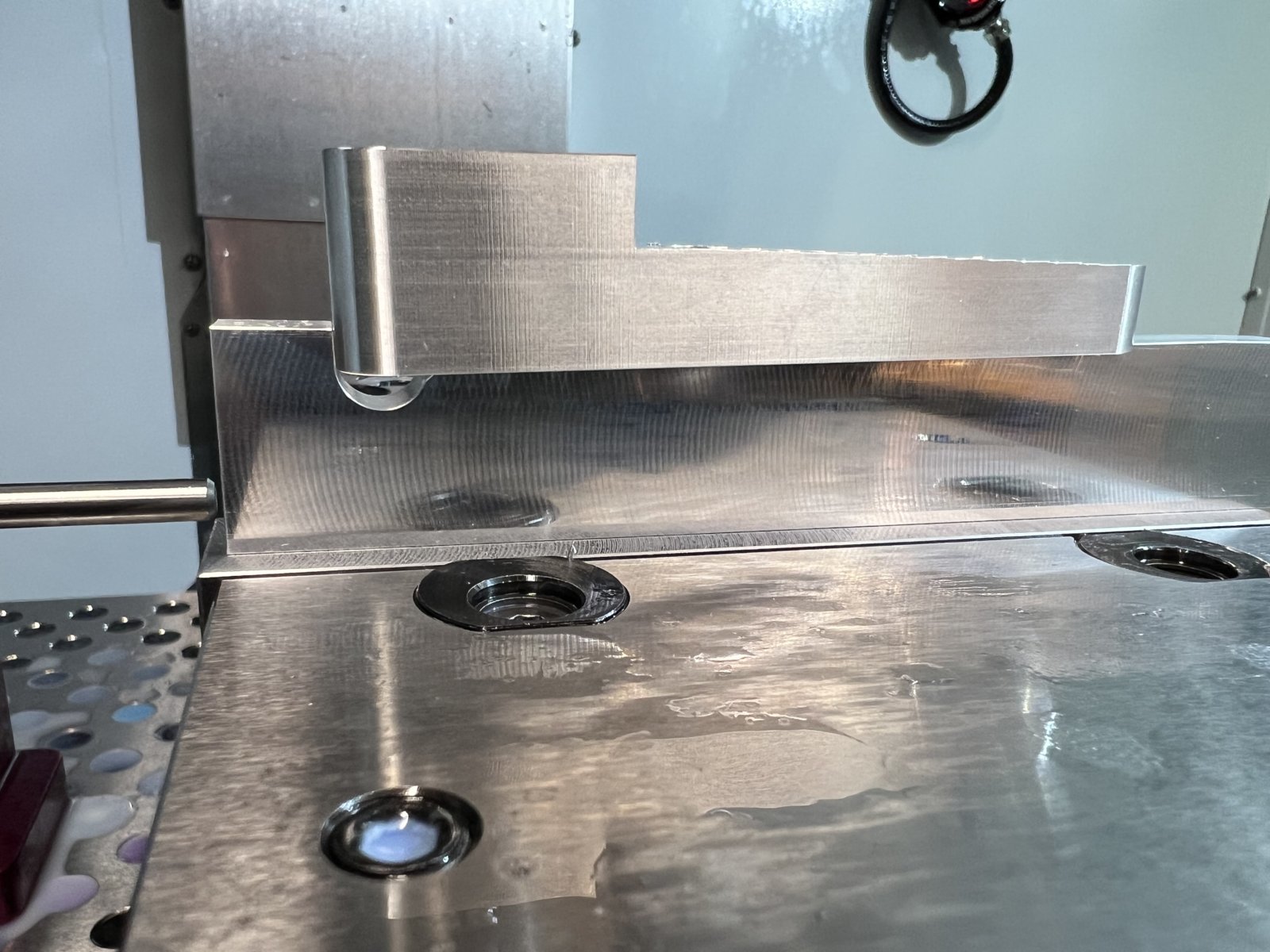

    Spent a lot of time on the mini mill the last week trying to make a gizmo for a friend going to SEMA. Don’t think I’m going to finish it in time. :( ran in to lots of small problems that “necessitated” several side projects. First one is I need to make a sacrificial plate for machining really thin stuff. I hope to make that one today. Second is a vice for holding thin stuff that needs to be faced. I could glue but I want stuff to end up really flat and parallel so letting twist/warp out of the stock seems important. Came up with a design for a plate-like vice that made from a Saunders pallet, some little jaws from mitee bite and tapered washers from a Saunders modvice. That meant cutting a taper on the mill and that led to some head scratching on how to indicate or probe in the part when it’s at a funny angle. So third mini side project: an indicatable angled parallel…. Worked pretty good! The top and side are a known distance from the “corner” edge…
    But then taking my second 6” vice off I found a ton of rust between it and the fixture plate. fucking rust. Anyway… Next up is the sacrificial thin part plate. And then back to making the actual thing I’m trying to make!.
    Here’s the vice all put together:
    This thing drops on my fixture plate in seconds. The slots let me adjust to hold different size stock and then the mitee bites do the clamping.
    tgelata likes this.

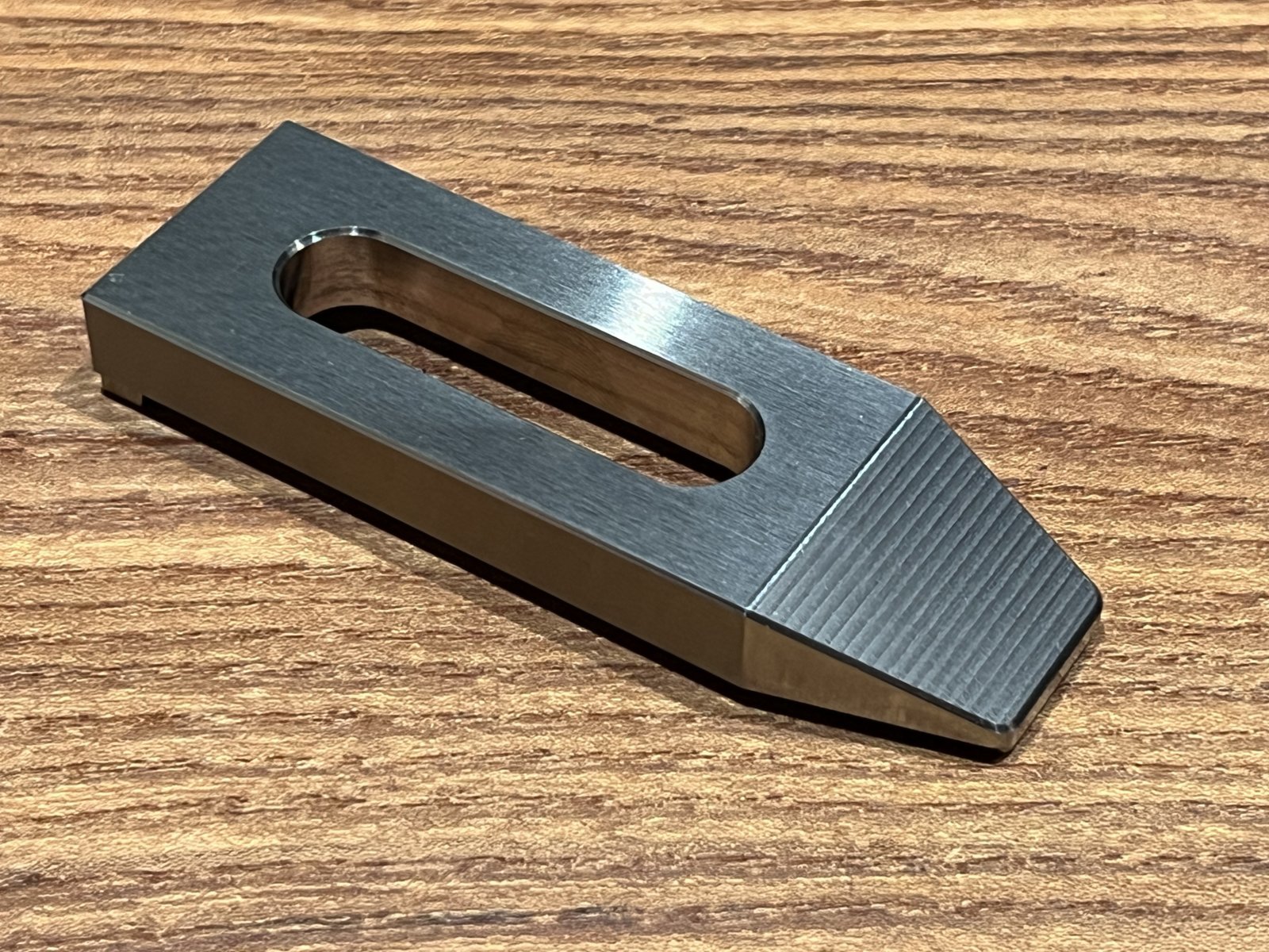

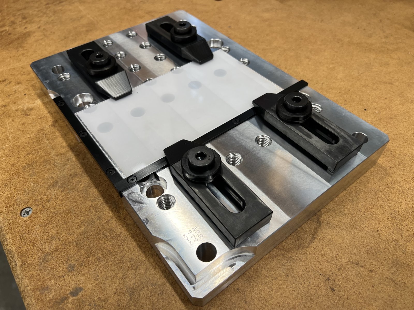

    Didn’t get the other fixture plate done but I made the 4 toe clamps that go with it. Made em out of some A2 steel I had lying around… never milled that stuff before - cuts great! Next I’m going to try some 4140…
    tgelata likes this.

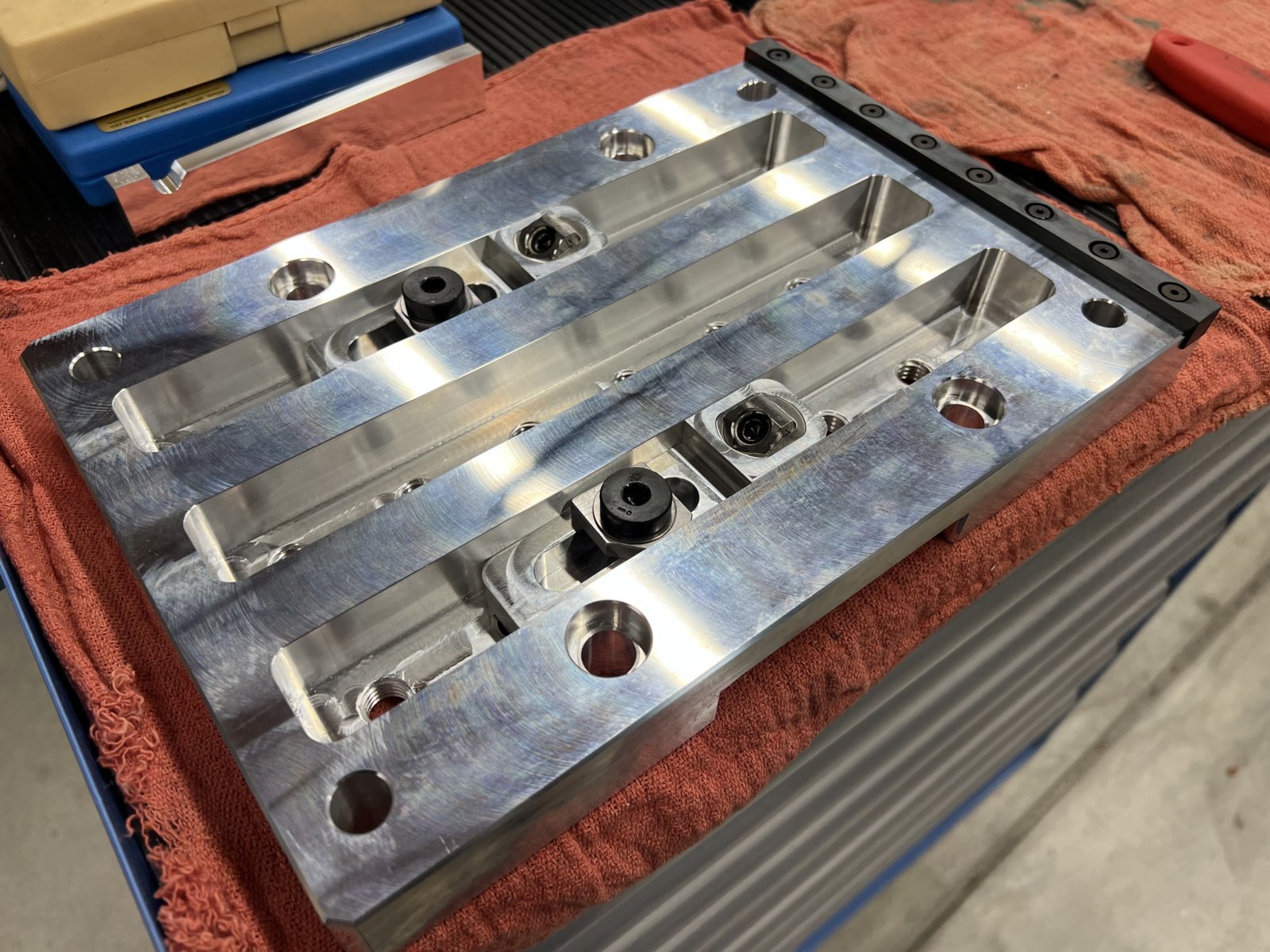

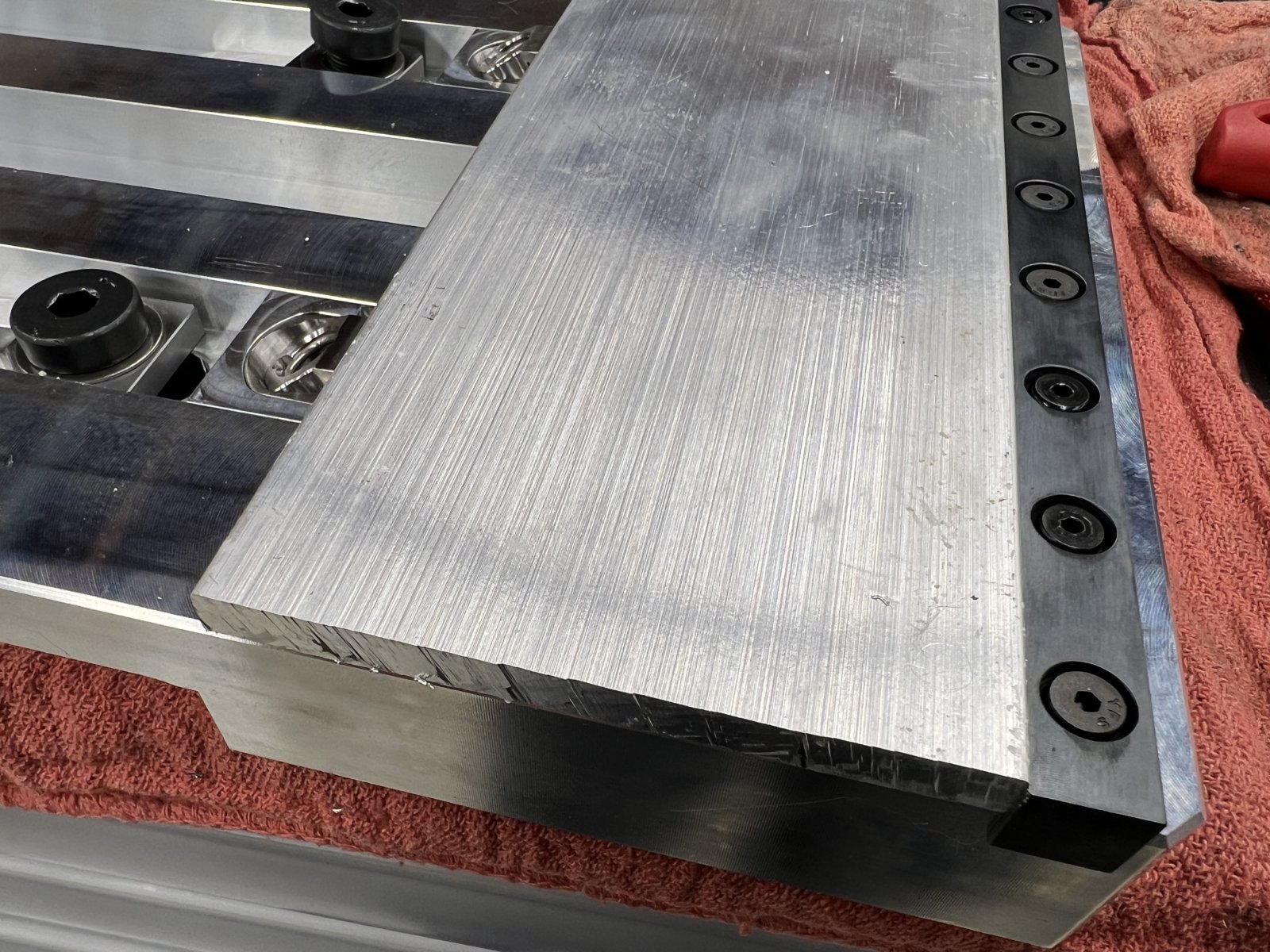

    And here’s my mini-thin-part-semi-sacrificial-fixture….
    also gave the thin facing vice a try and ran into a little problem. My aluminum carriers for the mitee bite clamps have too much flex. Need to remake in 4140!
