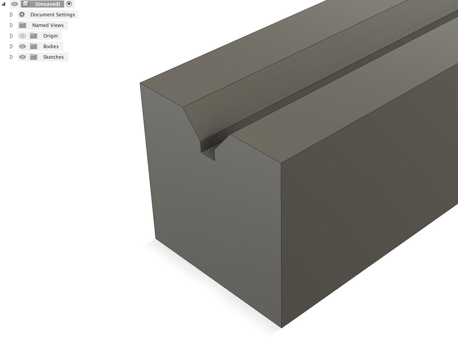

    This is what I'm imagining you are talking about.... 12" long, 80° "V" with a little relief at the bottom to accommodate machining...

    I didn't think about the relief at the bottom; makes sense but I don't see myself using it since the 80 degree will create a 90 degree bend in the work material without fully bottoming into the die.

    Ha ha no, the relief is so I can machine this with a square endmill. I’m going to lay the die over at an angle, machine one wall, then lay it over on the other side… repeat. Unless someone else has a better idea!

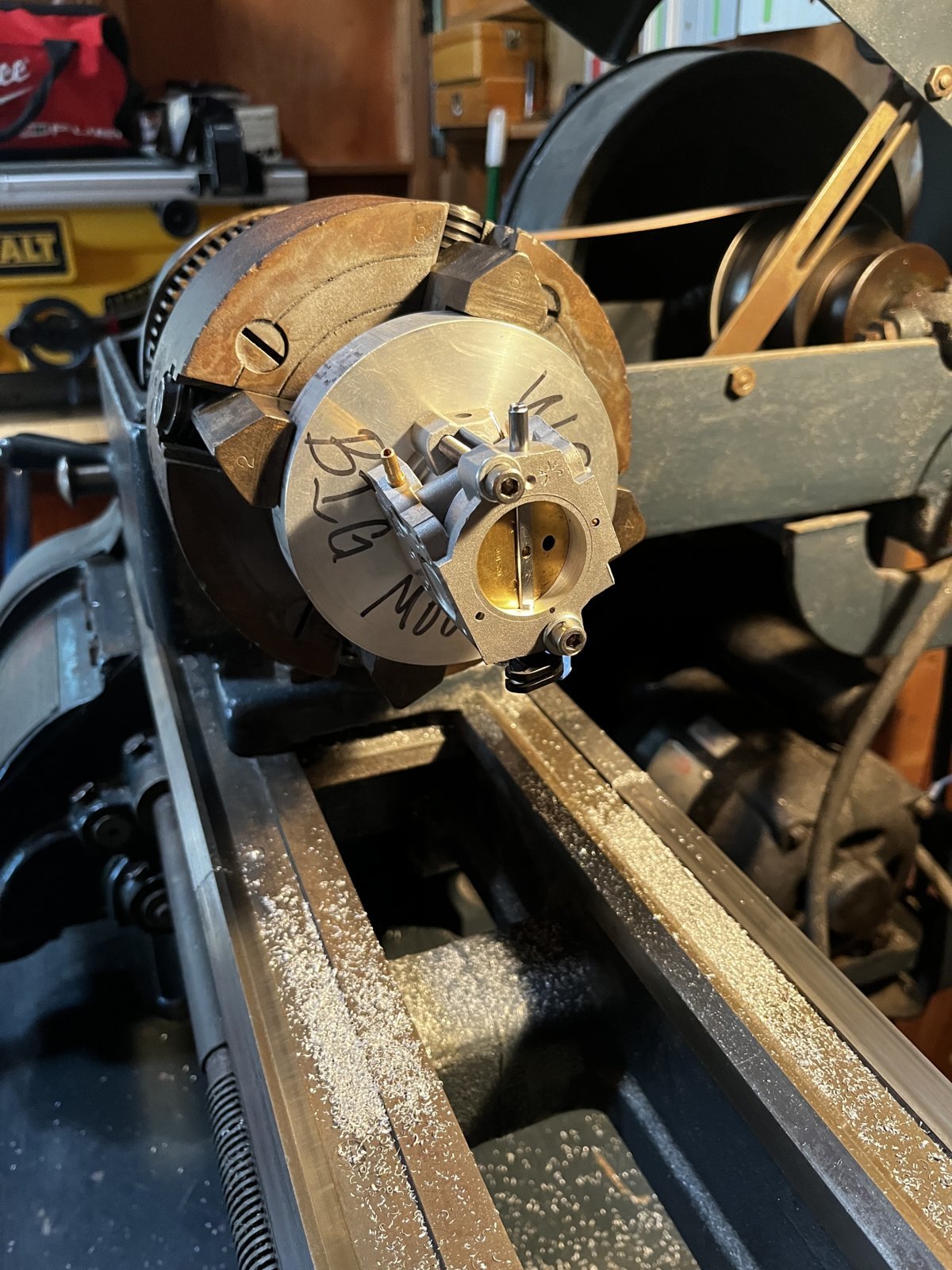

    Thankfully I have the Logan 820, but she needs a 1HP motor.
    Husqvarna 3120xp WG carburetor I machined to accept the choke plate as the throttle plate. Big bore WG’s can keep up with Tillotsons. I no longer use them.

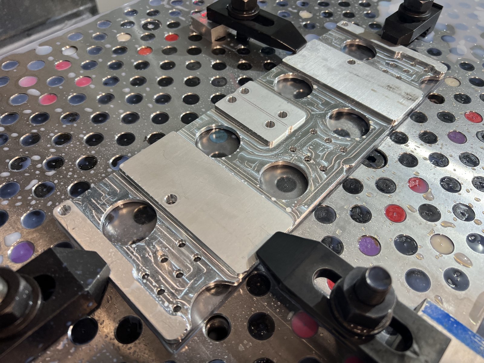

    Yah atm I have no time to look. Sigh. Been machining a bunch of flat plate for my kids high school robotics team. Flat stuff is new for me. Nearly took the ots out - I was so focused on not hitting the toe clamps! Phew!
