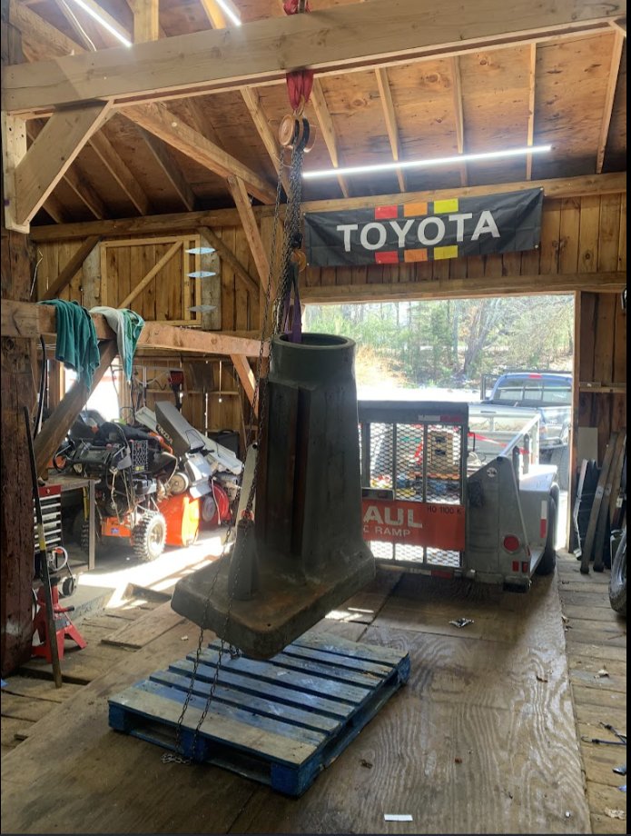

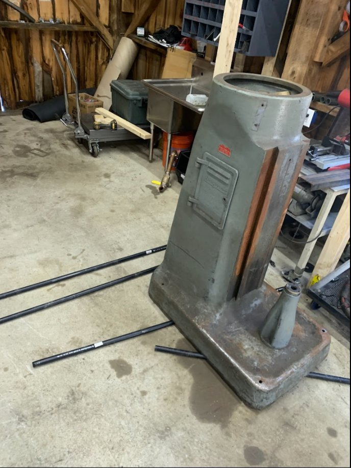

    Agreed, he does. Who needs a forklift, all you need is some sort of lifting device, some pipes, and alot of stupidity. 3 phase is no big deal, just a $150 VFD solves that.

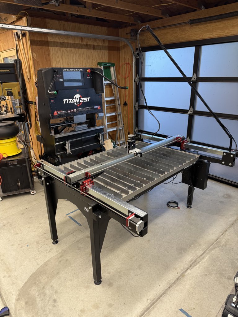

    Well, I finally did it. Maybe now I'll bend some stuff! LOL!
    I gotta say, I do appreciate the price point of the Langmuir stuff but man, the engineering is pretty... fast and loose. I can't wait to start trying to get it all square and flat. (it looks pretty close following the directions but... when do you actually square the x and y to each other?) @Kwikvette I promise to watch all your videos before I start asking you a million dumb questions.

    Fuck yeah!
    Congratulations!
    So the X and Y squaring I perform as part of the frame assembly, ensuring the same distance from corner to corner.
    I can also place a level on any gantry, in any direction, and all sides are also flat. This way the table is perfectly supported on all 4 feet and won't "twist" if I accidentally bump it.
    You'll want to tram your Z axis while you've got your torch off so it's perpendicular to your work surface.

    Done and Done! I got the corner-to-corner dead nuts, but I don't think that means x axis is square to 'em. With the ol' eyeball and framing square it looks about 1/16 off over 24" so that will tickle the OCD something fierce. I haven't finished doing all the steps with the power on yet, so maybe there's part of the setup that squares things by tweaking where y1 and y2 are?
    Also got all the way to the limit switch and THC kit only to find that despite calling them twice to figure out what to get for torch, consumables, and 'anything else they'd recommend' to find that there is a 'plug-and-play' cable for the hypertherm that they neglected to mention. MMRRRFLLLLUGHHH.

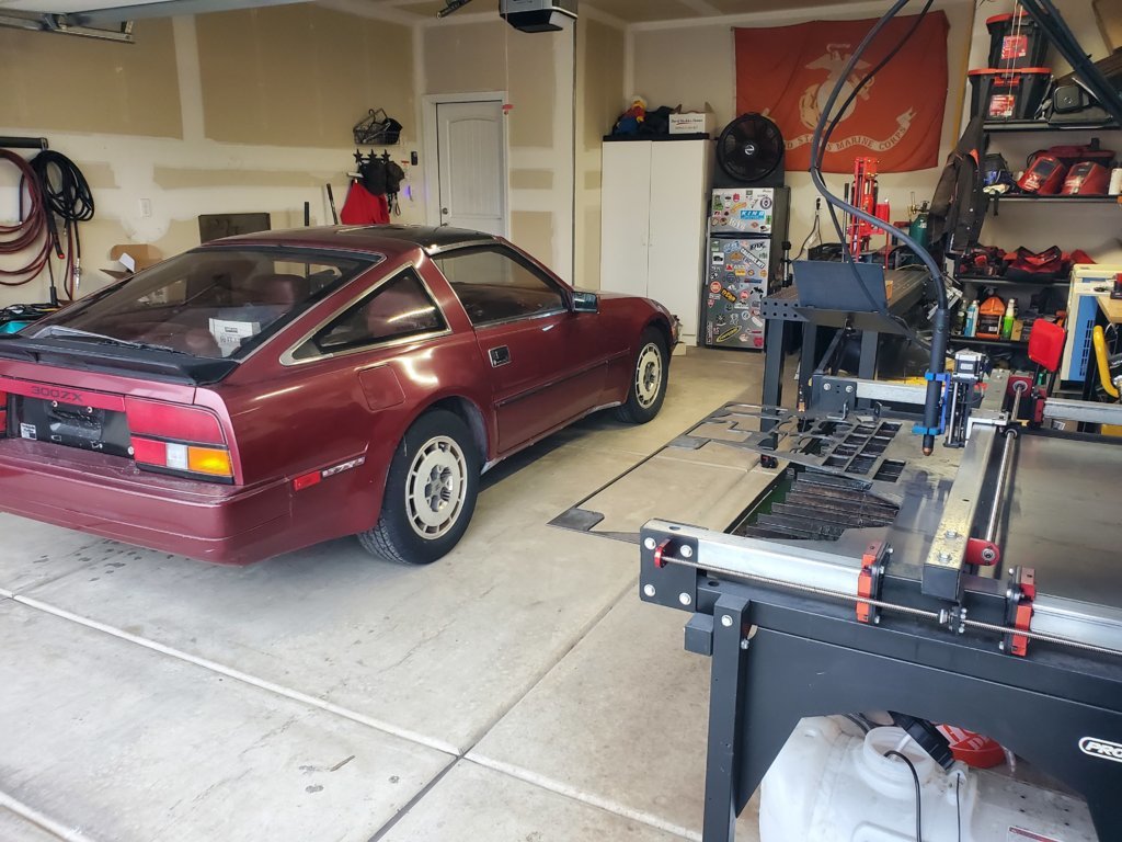

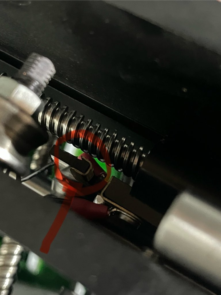

    He speaks the truth. I had a break through myself this past weekend. I was getting an intermittent issue with the z axis and THC. I was told by a “Langmuir Expert” to check the Z limit connectors. I pulled of my cover and did so but also found the copper connections were bent and contacted the z lead screw. I bought this machine used locally so I never got to enjoy the full assembly. I initially thought this was just part of the design. Last night I tore the whole thing apart since I was really losing my sh!t. I bent the tab back and then went through trimming the Z. The end result was glorious. I can now effectively get consistent cuts to dial in. I can now tweak cut height with accurate and consistent cuts. @Kwikvette saved my sanity big time.
    Here is a picture of the tab that I bent back and was catching the screw.

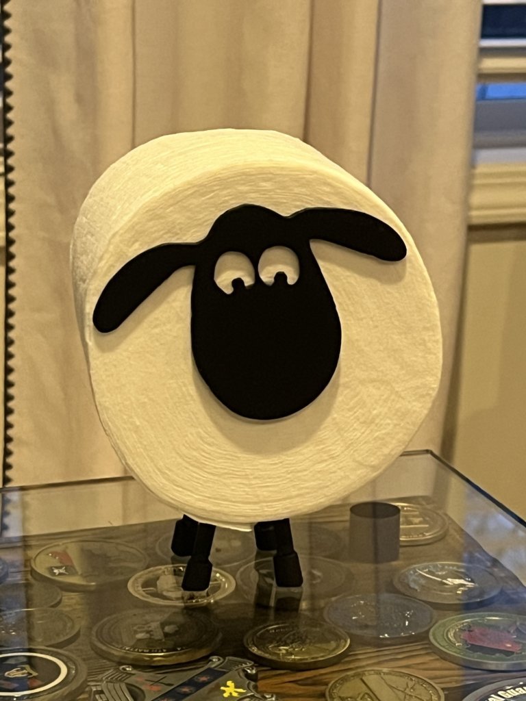

    And then a piece I made for my wife to show her the real value of all the money I spend on tools.

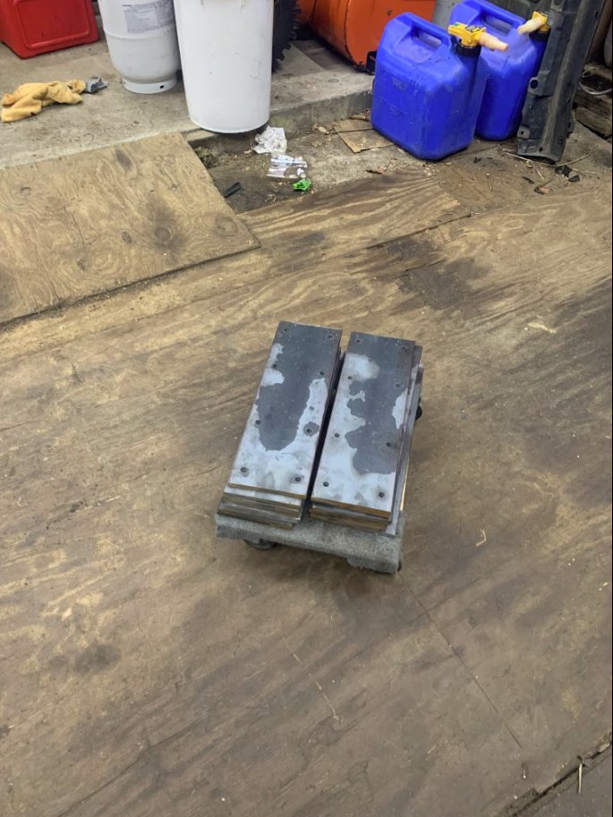

    Im not cool enough for plasmatable stuff yet but I am working on making a decent run of these brackets. Customer got delayed so he just said get them done before summer.
    Does removing mill scale with vinegar work well? I think thats my plan to prep before bending then welding.
