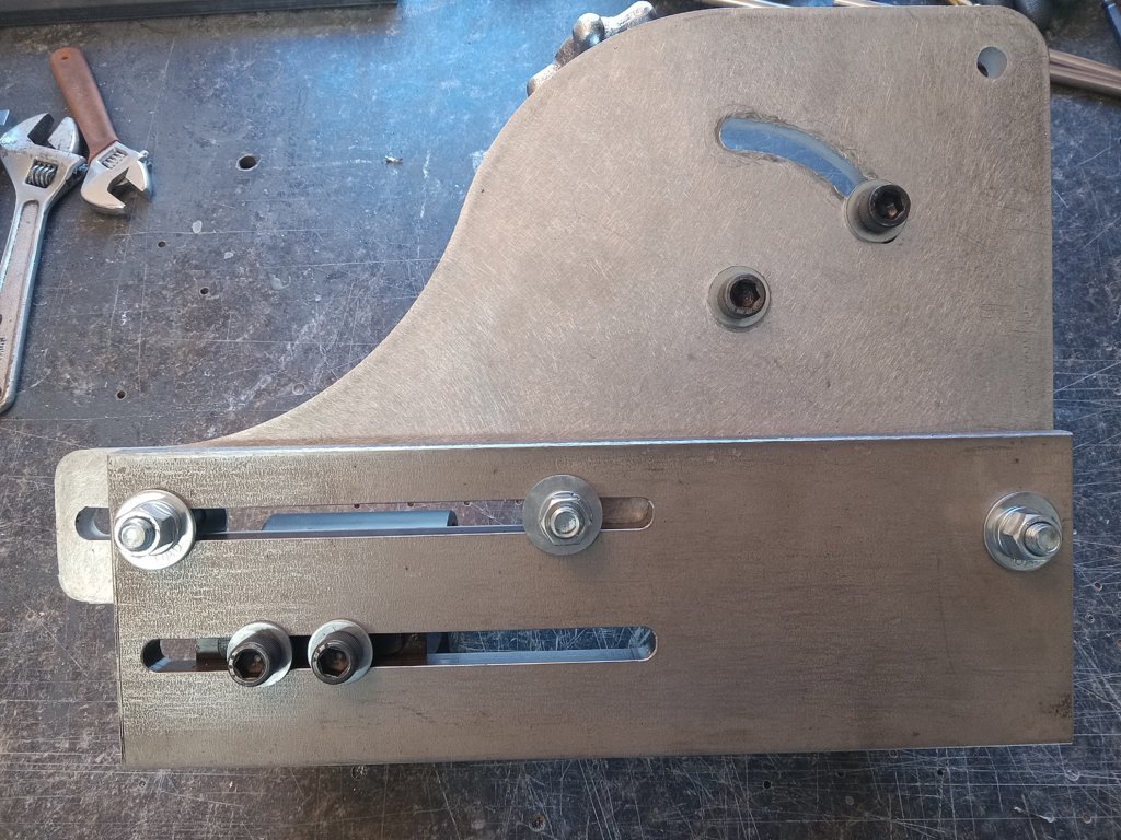

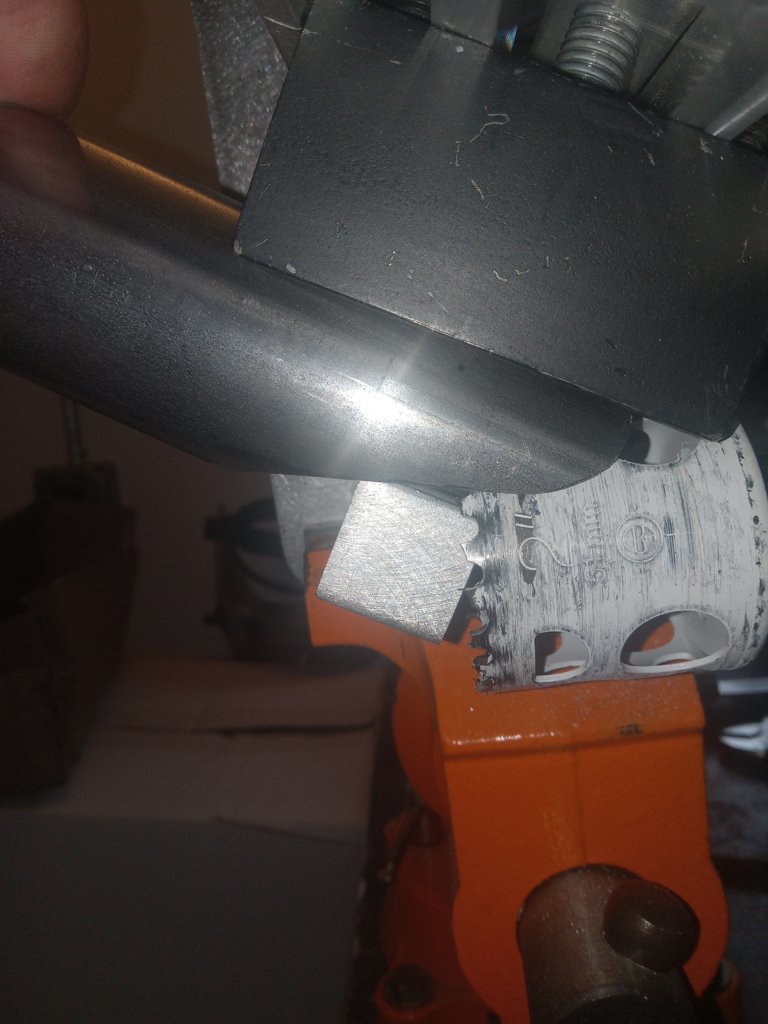

    Ran into an issue with my tubing notcher. Need to notch some tube at 60* to build my seat mounts. I can only go about halfway through then the teeth will hit the aluminum clamp. Guess I'm back to hand drawn and a grinder....
    Or should I pick up a piece of steel plate and make some modifications... Hmmmm.

    What tube notcher is that?
    Don't have one since I don't have a bender, but it helps people knowing what tools work (or have small issues).

    It is a Pro-Tools, I think the older 501i. They've changed the handle. It can do both straight and offset notches and can be mounted to a drill press, I just don't have one tall enough. It was honestly a good investment for me, it saved me a lot of time notching the roll cages for my car and tractor.
    I think I am going to get a 12"x6" of 1/2" steel plate and extend it to clear the clamp. Since the clamp can be offset, it won't be an issue getting it aligned. Extending it will also give me more clamping area on the vise.

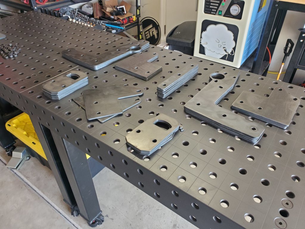

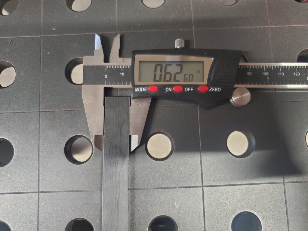

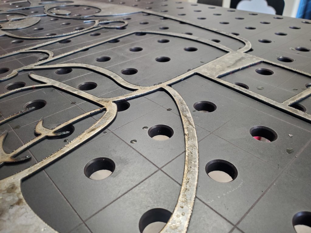

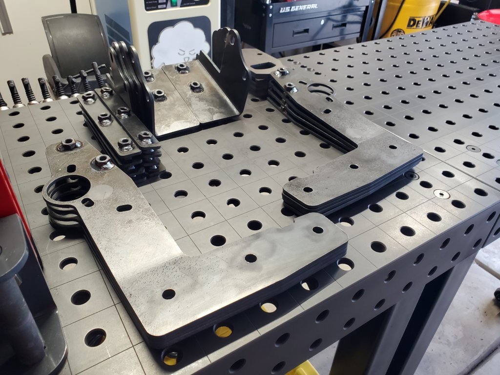

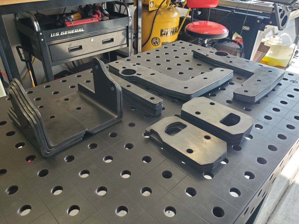

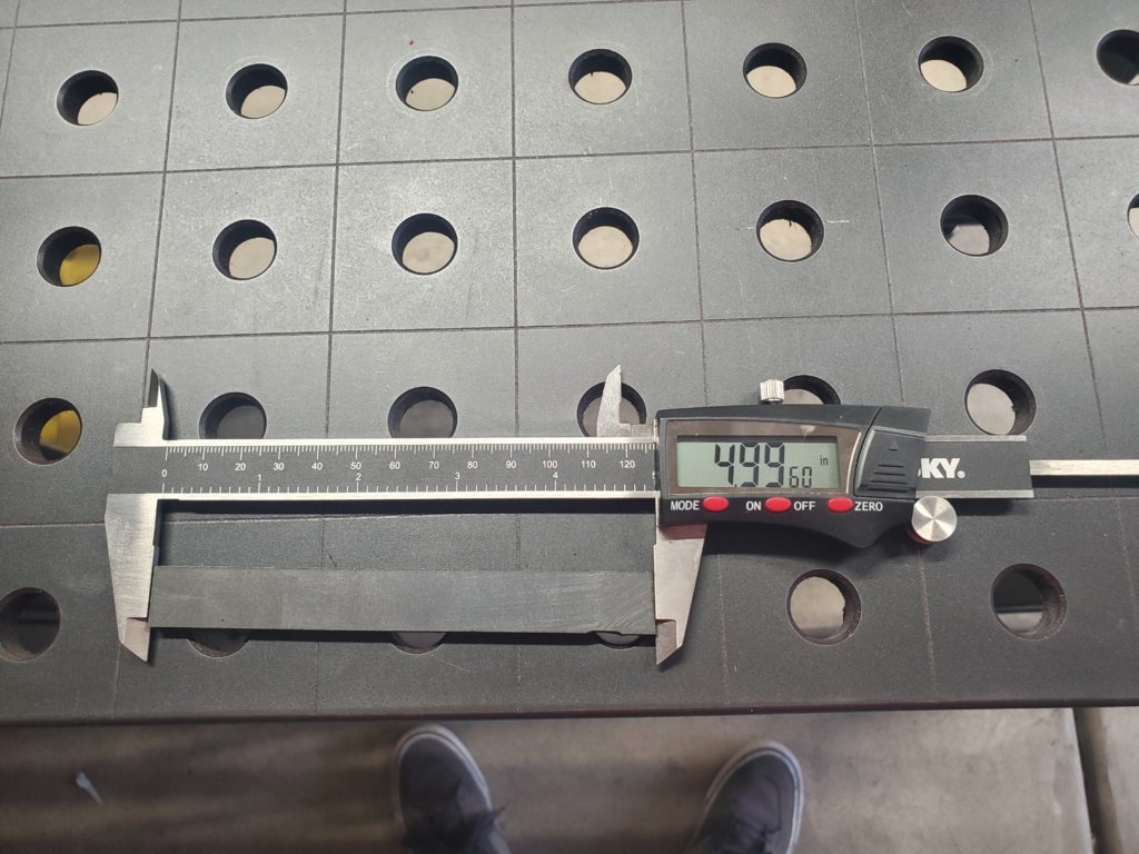

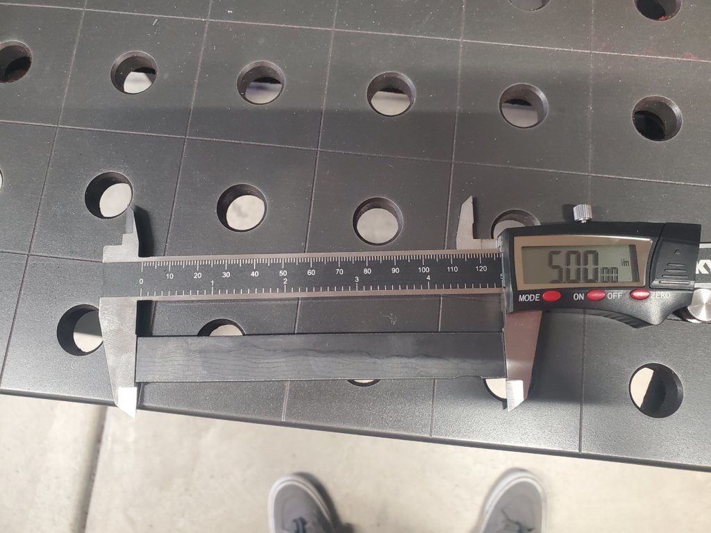

    Was asked to make a few parts and weld them together for tomorrow. When one of the dimensions provided was listed as 5 1/16" I figured I should make some test cuts.
    Since switching from PrimeWeld to Hypertherm, I never bothered to change my kerf value until earlier today. I had left it at the same value as I had on my other machine these past few months.
    First test cut with the slightly incorrect kerf using a 5" x 0.625" geometry -
    Second attempt with my correction -
    Customer says it's significantly more precise than it needs to be :rofl:

    Went with 4"x1/2"x12" stainless. 2 slots and 1 hole to mount and lower the cutter. Now, it can cut 60* without cutting the clamp.

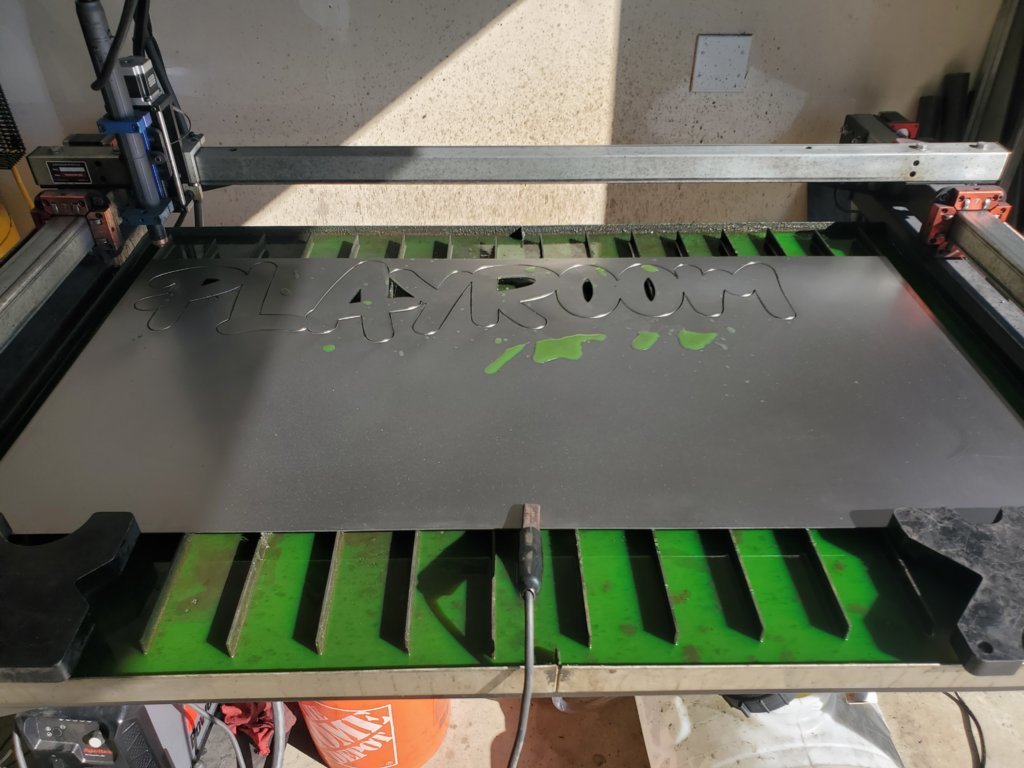

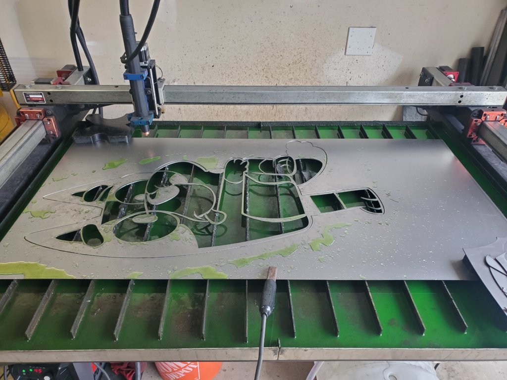

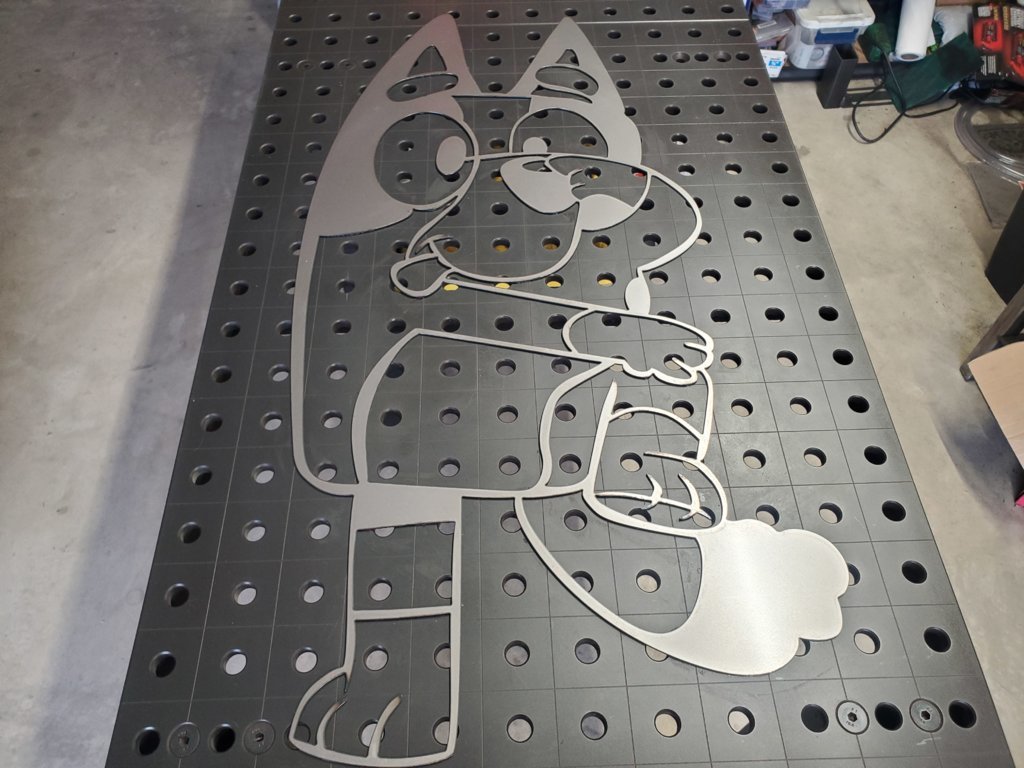

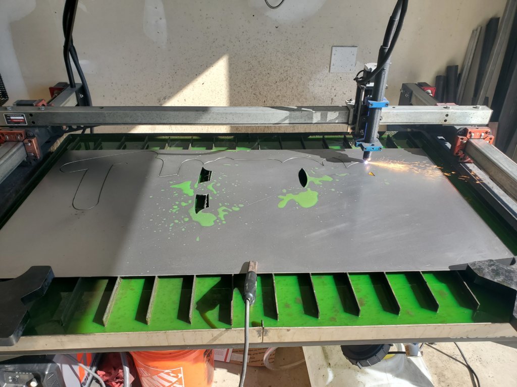

    Whether it's the first, or hundredth, there's something oddly satisfying about having a new sheet of cold rolled steel on the table
    Had the idea last night to use up some wall space in the kid's playroom

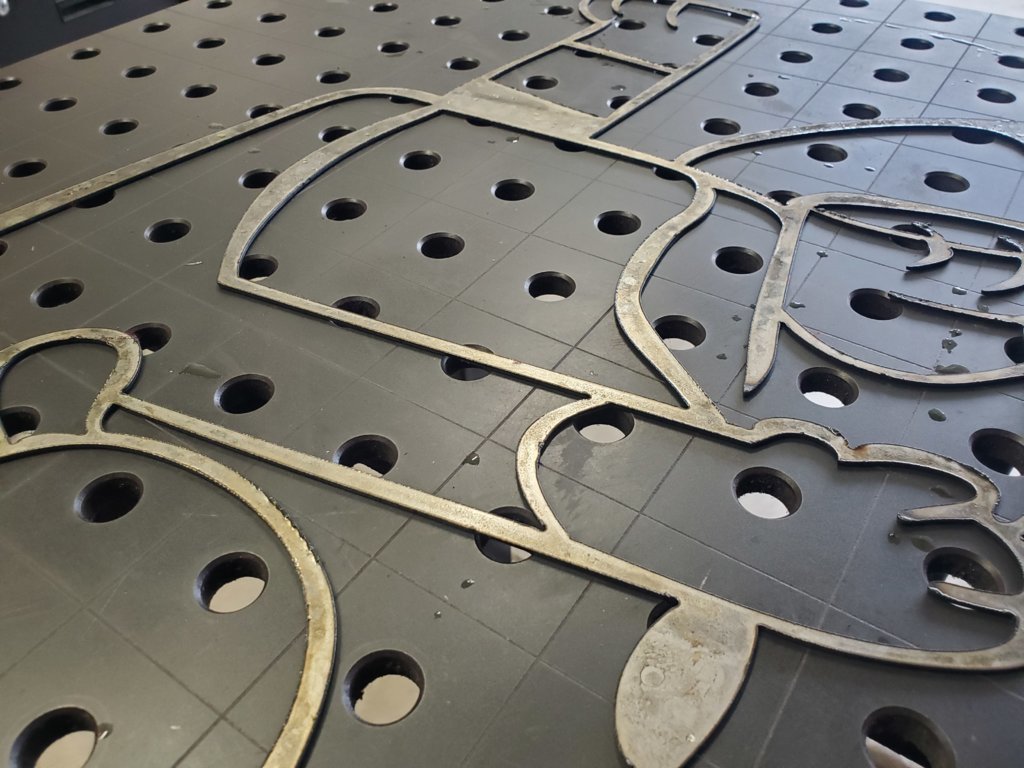

    Right off the table, I always love how to clean the cuts are
    Here's the worst part of the dross (almost none at all)

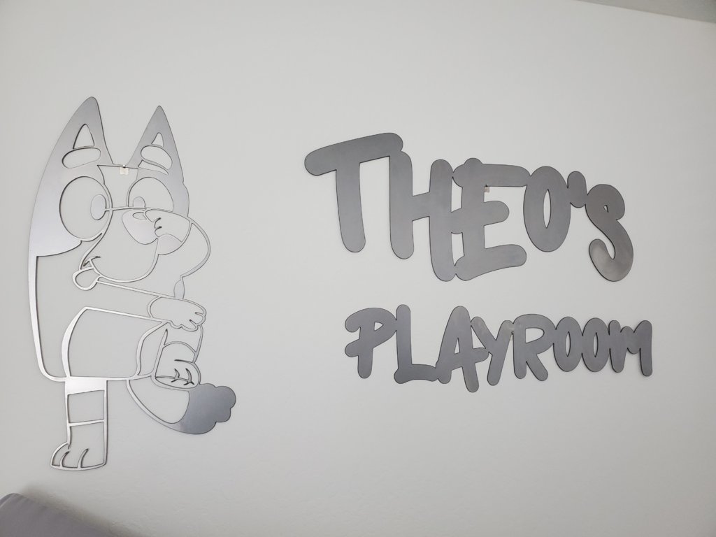

    The kid loves it and that's all that matters
