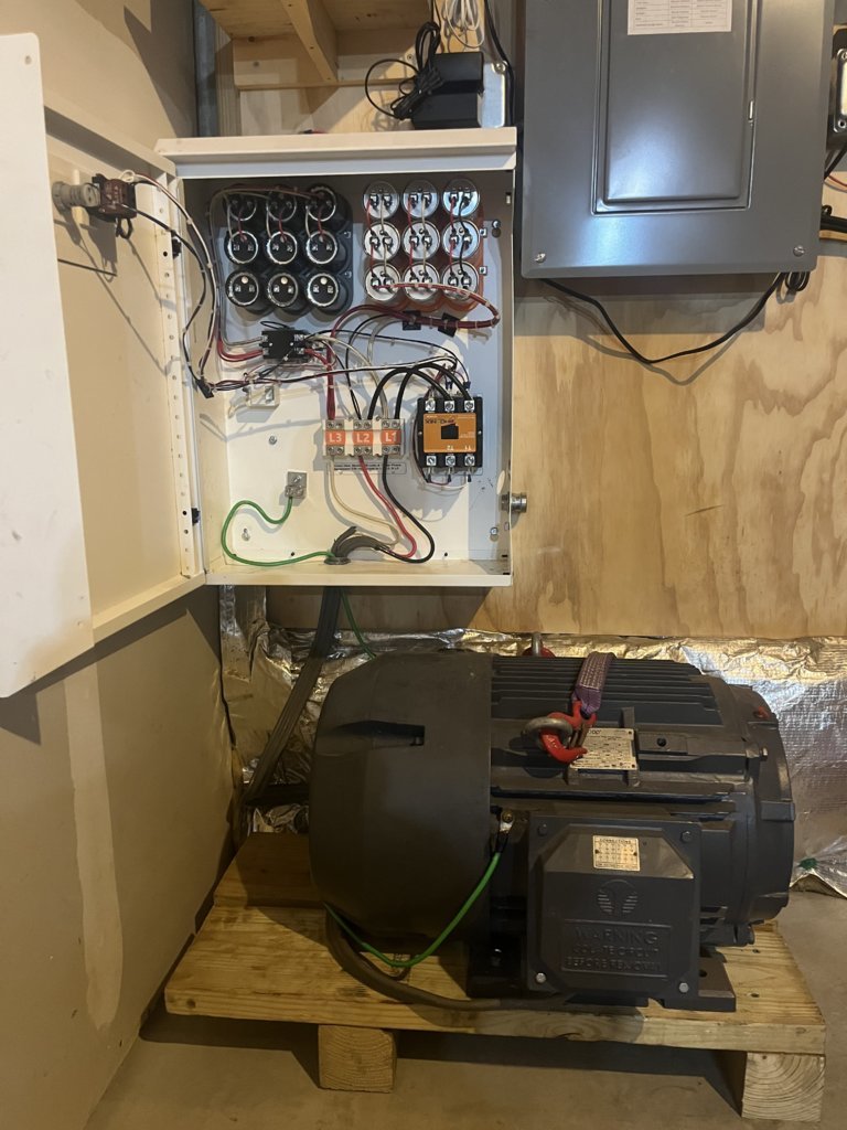

    Still gotta tied it into the box and run another line across the shop but finally 3 phase POWAAAA.
    Found this 25HP idler from a sign shop closing down in Queens.

    What are you running on 3 phase?
    Drainbung likes this.

    Eventually a mill also

    All I had on hand was a small 2HP VFD. I bought this from a tech school swapping out systems. The instructor told me they are sensitive to spikes, mainly the digital readout. I figured with the rotary converter setup it would be a little more efficient and balanced for the machines. The idler is large enough to split duties between a couple or even three machines. I don’t think I will be able to get a mill until I build a shop. I’m pretty much out of room.
