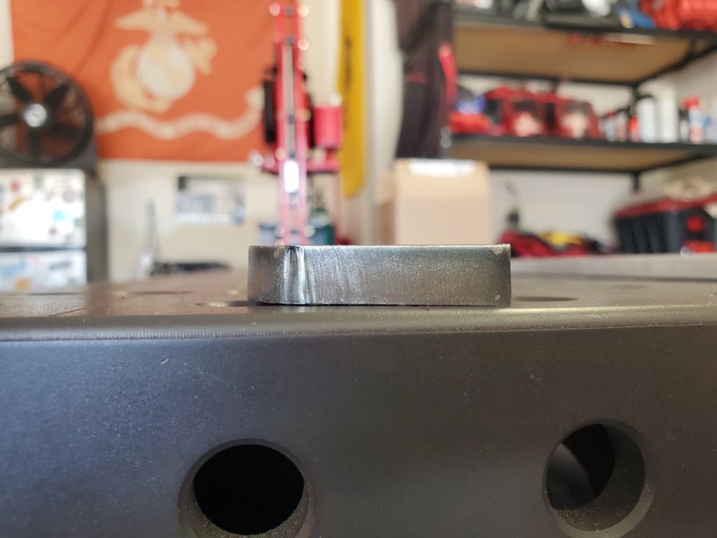

    To summarize what I shared on the Langmuir forum, I had to alter my cut height on all my program files from now on.
    And here's a great example of that. My stool I posted in another thread? Well, I've already sold two "kits" and someone else wanted a set too.
    Rather than run the same file I already have (prior to the update), I opted to post process it again at an even lower cut height (lowered by .02") and cut it out today.
    I don't know what it is that Firecontrol version 21 ran all my files as expected, but running the same exact file cut them with dross and beveling. Now that I altered the cut height, you can see they are perfectly square all the way around.
    Even opted to cut a different material thickness and it cut as expected (with the newly revised height).
    So it seems, version 24 is altering my heights for some damn reason.

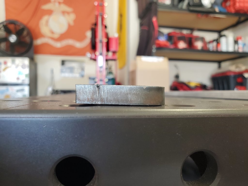

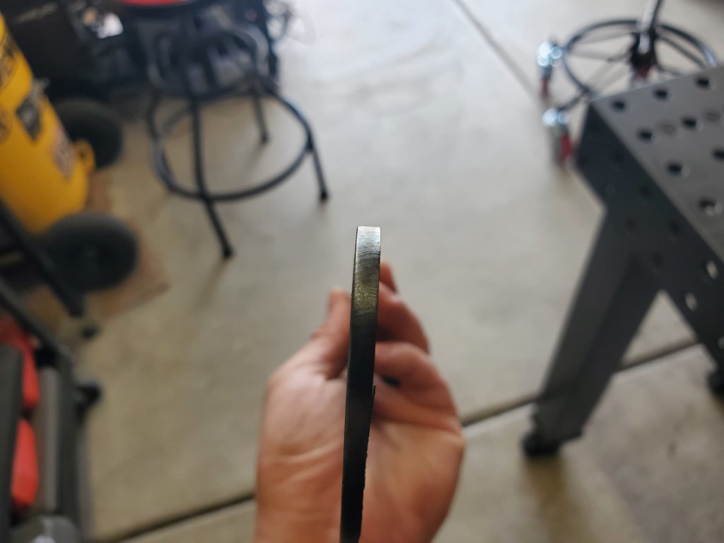

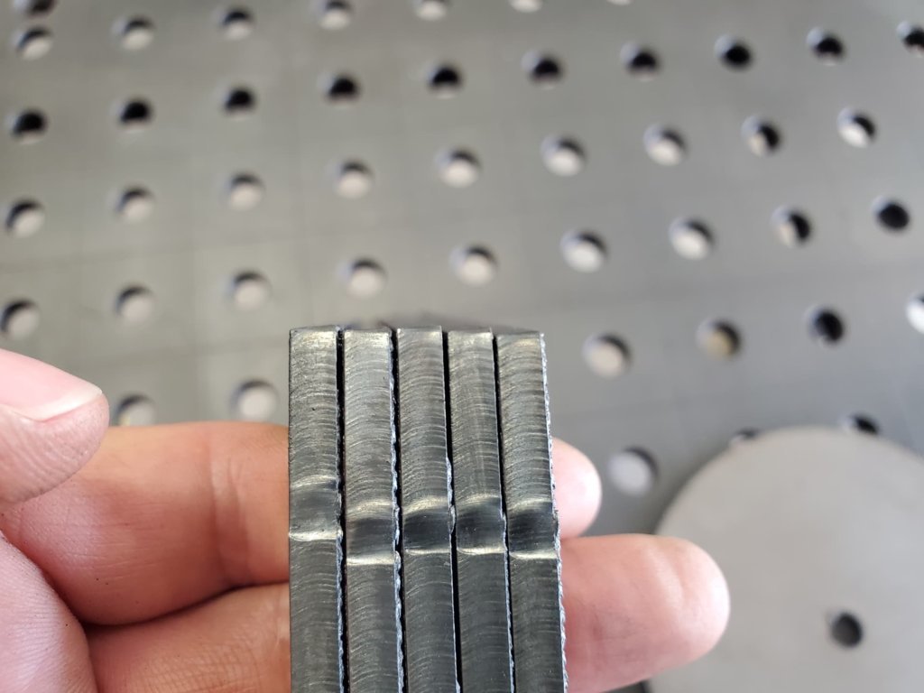

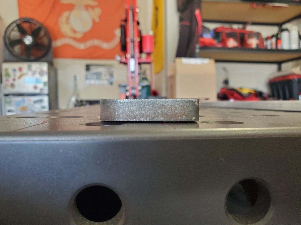

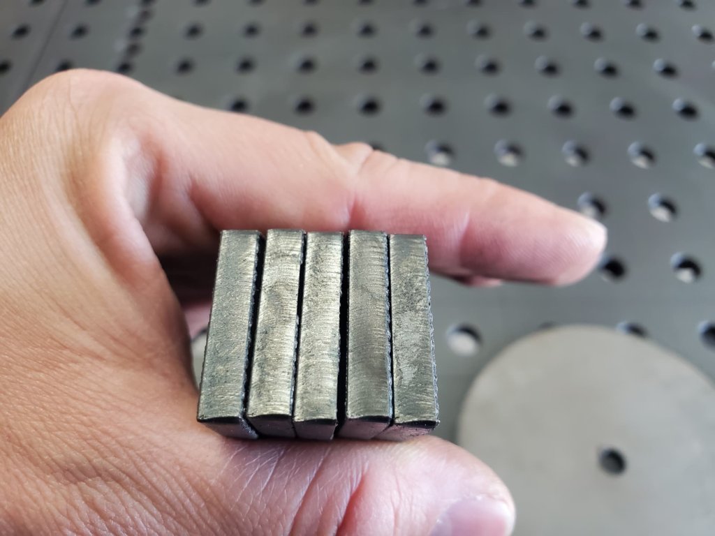

    Cut some 3/8" for the first time on the Hypertherm. Thing is, the scrap is super small so there's very little testing to actually do.
    Here's a clip.
    https://youtu.be/RcjBvBxxNzs?si=77ZsX8tLsTdlMfYY

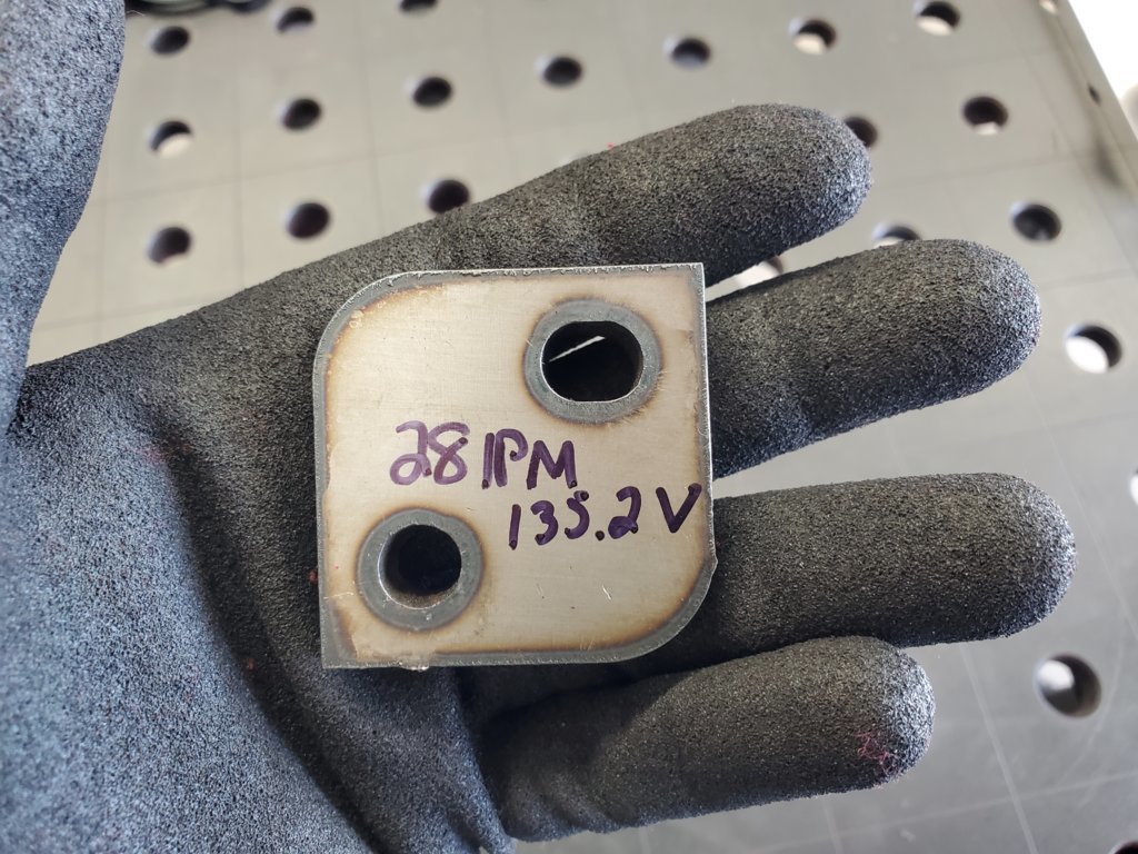

    Now, I did get some responses that basically took my thorough assessment and troubleshooting as if "I'm new to this shit" (this is regarding the Langmuir forum, not here) :duh:
    But nope, the results here are plain and simple. Only by having adjusted my programmed cut height (due to the forced change in software) is my table cutting material properly.
    I understand a lot of newbies ask dumb questions on the forum, but some know me as a regular there posting clean and accurately cut parts.
    So when a suggestion like "are you sure you measured height correctly" or "what nominal voltage are you using" when my initial statement stated - using smartvoltage, and using the same programmed cut height as always. Same computer, same table, etc.
    The book speed for 3/8" mild is 33ipm. I ran this at 28ipm, and smartvoltage captured an average of 135.2v which is damn close to what book says it should be. Book is 136v

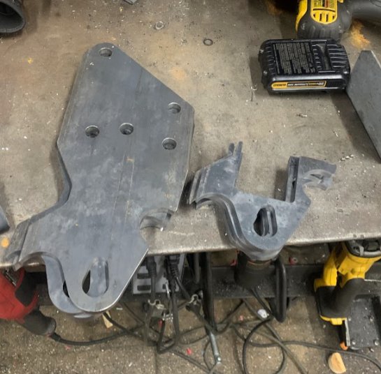

    Thats hot, I use 3/8 for the mounting brackets for my rear bumper. In your opinion think your old PW plasma could do that?
    Machining them sucks....

    Shit man, machining is the BEES fucking KNEES.

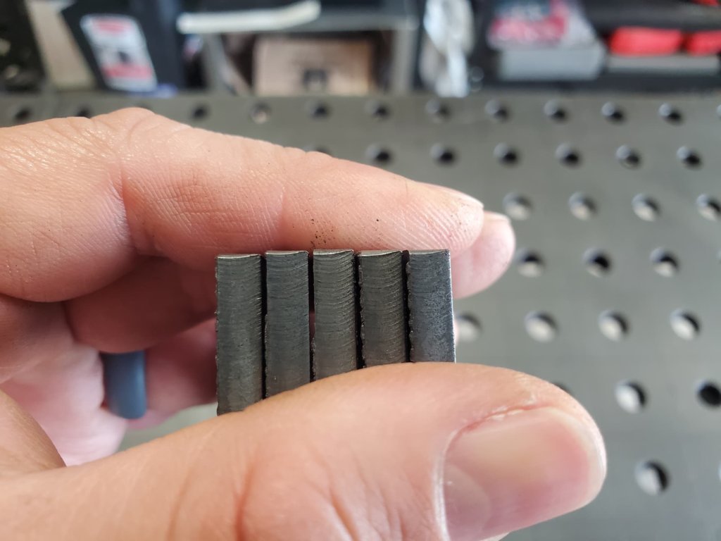

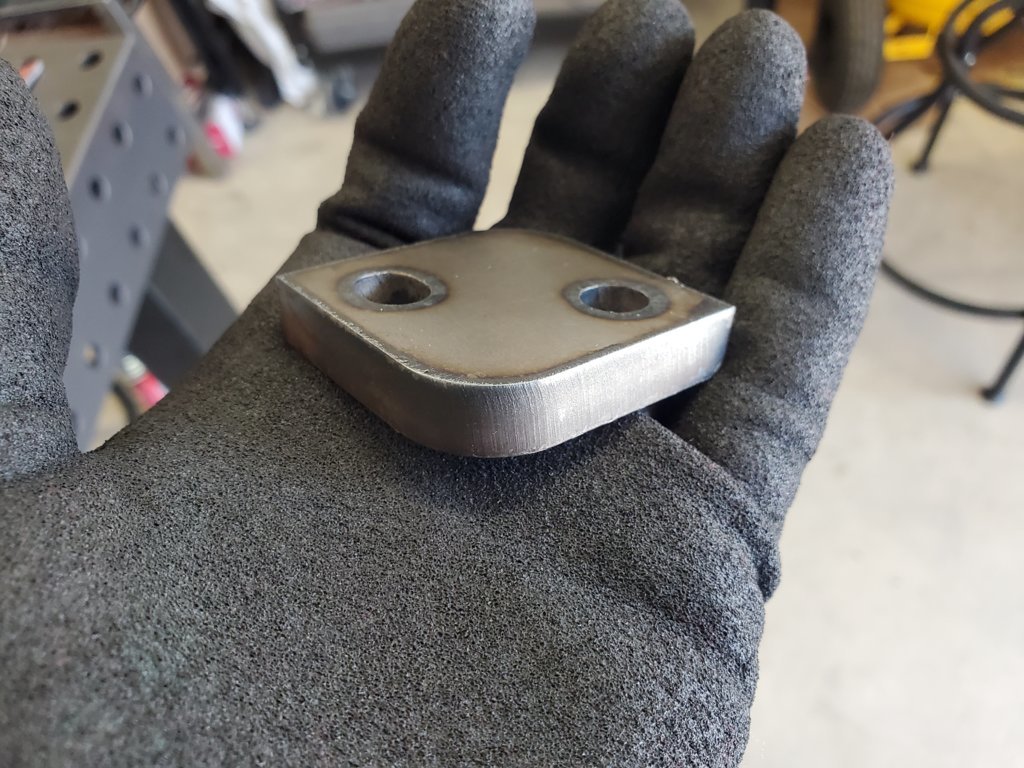

    But yes the PrimeWeld could absolutely handle it. Although, I never did try 3/8" with the PTM-60 torch, just a few times with the UPM-105 and it cut really well.
    Downfall is that consumables got wrecked easily, and there would be a bit of taper on a radius edge.
    Where the Hypertherm stands out is how I'm able to run a short pierce delay (only .7 seconds) and still penetrate the steel really well, get a crisp square edge on a rounded corner, and get crazy smooth cut edges.
    The reason for the little divot at the bottom is due to the slag on top from cutting the tiny 0.35" hole. If you watch the video you'll see where the torch literally raises the torch as it adjusts its cutting height due to the build up of material on the surface.
    One should not cut a hole smaller than the thickness of the material, but I did it cause...
    Zebinator, Drainbung and zippsub9 like this.
