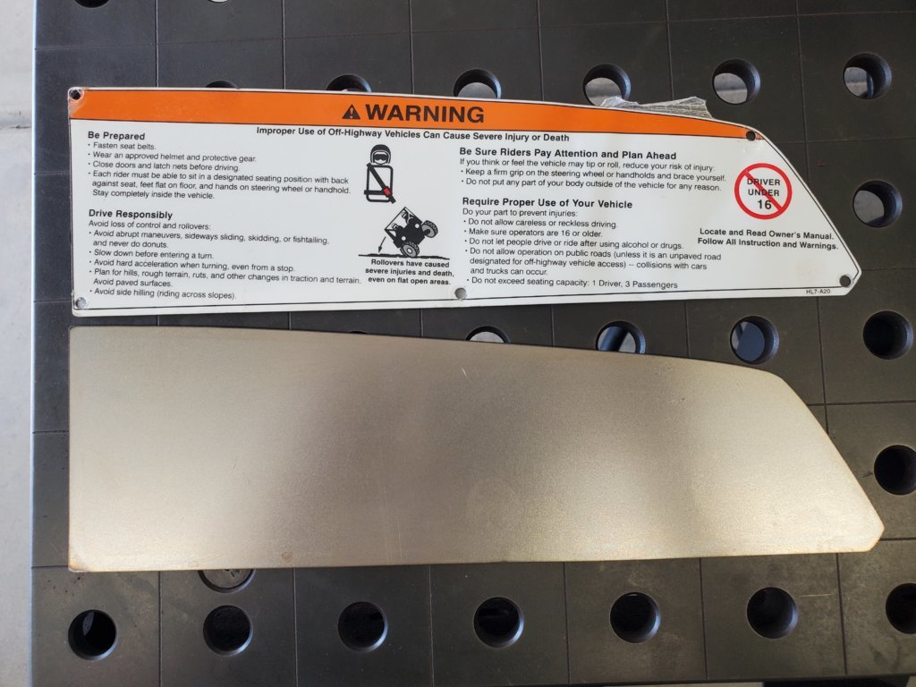

    And it's installed, thanks @Kwikvette. Painted it with Steel-It, nice stuff to work with but stinks like hell while curing. Much better than the OEM placard.

    Shiiiiiit looks perfect

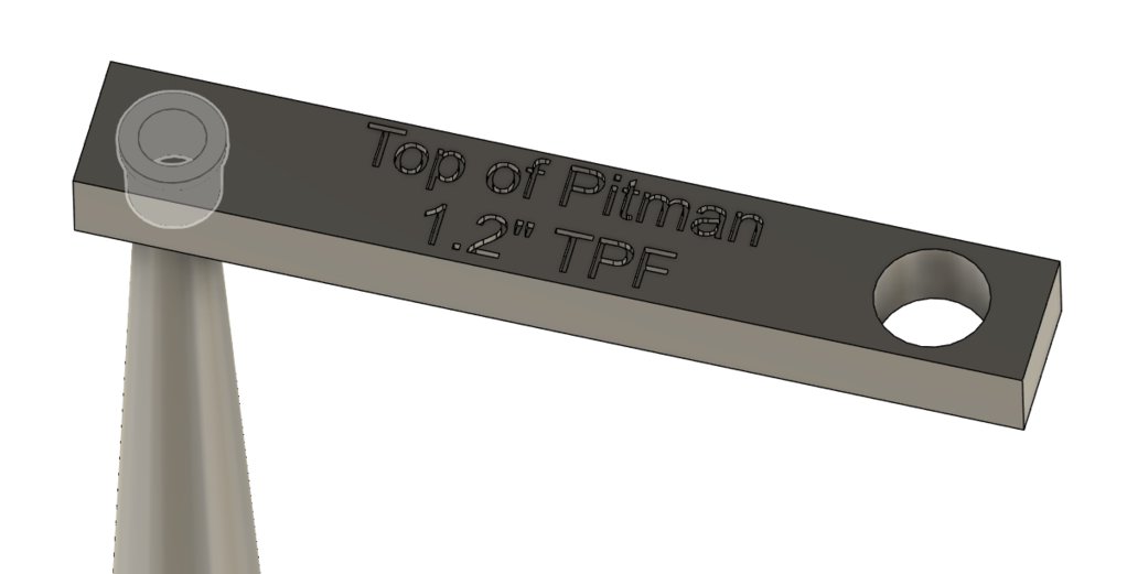

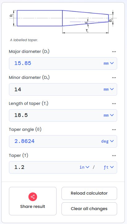

    Let me know what you think/what you might change. With this iteration the plan would be to drill out the factory taper to 3/4", drill a step for the flange on the bushing, then weld the flange to the pitman arm. I've included a STEP and F3D file made in Fusion360
    Reference: https://www.omnicalculator.com/construction/taper

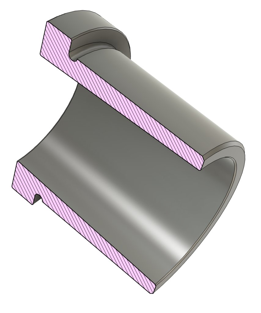

    So, FWIW, I'm a self taught machinist.. does that make me a machinist? I dunno. At least I have machines. LOL. I have no idea what kind of tolerance you would need on the taper, but I'm guessing in this application in 1020 steel it doesn't have to be bananas. Can you find a reamer for that size? that would help, but I'm guessing no and you'd just cut the taper on the compound which requires a little set up but is not hard.
    A couple design considerations - that internal corner on the flange will have a small radius on it - so if it's going in a hole with a sharp edge, you'd need a little relief, which I modeled. (looks like that part someone linked had one) If it's going in a hole with a chamfer, best to call out how big a radius is ok. For instance, I think my turn/facing tools have a .8mm radius (or so). I'd also call out chamfers/edge break as that will just help the part go in easier, and if you don't call it out a machinist may leave it sharp or do what they think is right. If you care about the size of a chamfer model it.
    I'm crazy busy until mid may but if you are still looking for this remind me and maybe I can turn a couple for you! it's been a long time since I cut a taper w/o a taper attachment so I'm kinda curious if I can pull this off! lol.

    I'm by far less of a machinist/engineer than any of you. I don't have machines but I can make something resemble something that I want in CAD, and print it on my 3d printer.
    There is a 1.2" TPF taper available from a couple places but I think it's out of my price range.
    I vaguely understand the need/want for a radius from the flange to the bushing wall, sharp edges crack easier(?), I don't know what a good radius would be. The hole will have the step for the flange cut with a drill bit by hand so whatever chamfer that will leave. As far as breaking/chamering the other edges they can be square, no body but me is going to be fondling this piece then it's going to be stuffed between a ball joint.
