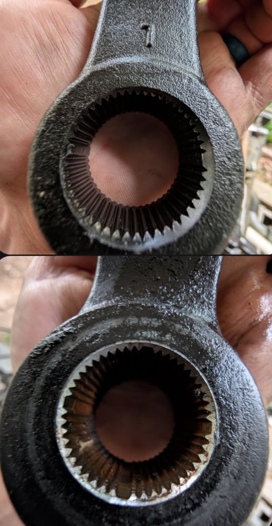

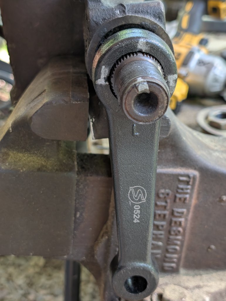

    I was able to find a pitman arm from a 2wd Toyota pickup that has the taper the way I needed. I just had to "machine" the Toyota master splines (2x inny) to work on the Nissan Xterra box (4x master splines outy).

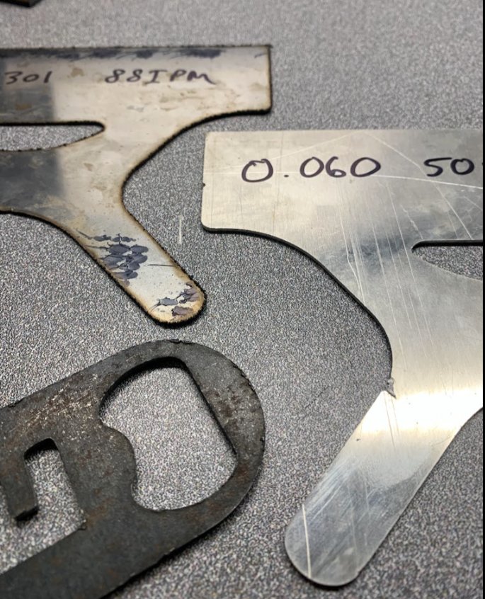

    The old guy in the machine shop was wondering how it would cut aluminum and stainless so I gave it a try.
    The stainless definitely has some what would be called sugaring in the welding world. Aluminum looks great. All of this was first cut using kind of book settings. Not dialed in by any means, I haven't done any of that just still playing with it.

    Definitely go faster on that mild and stainless, aluminum looks good

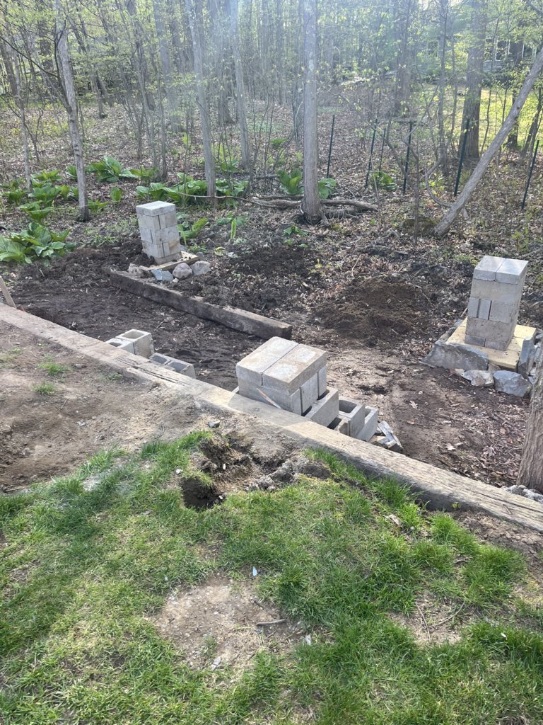

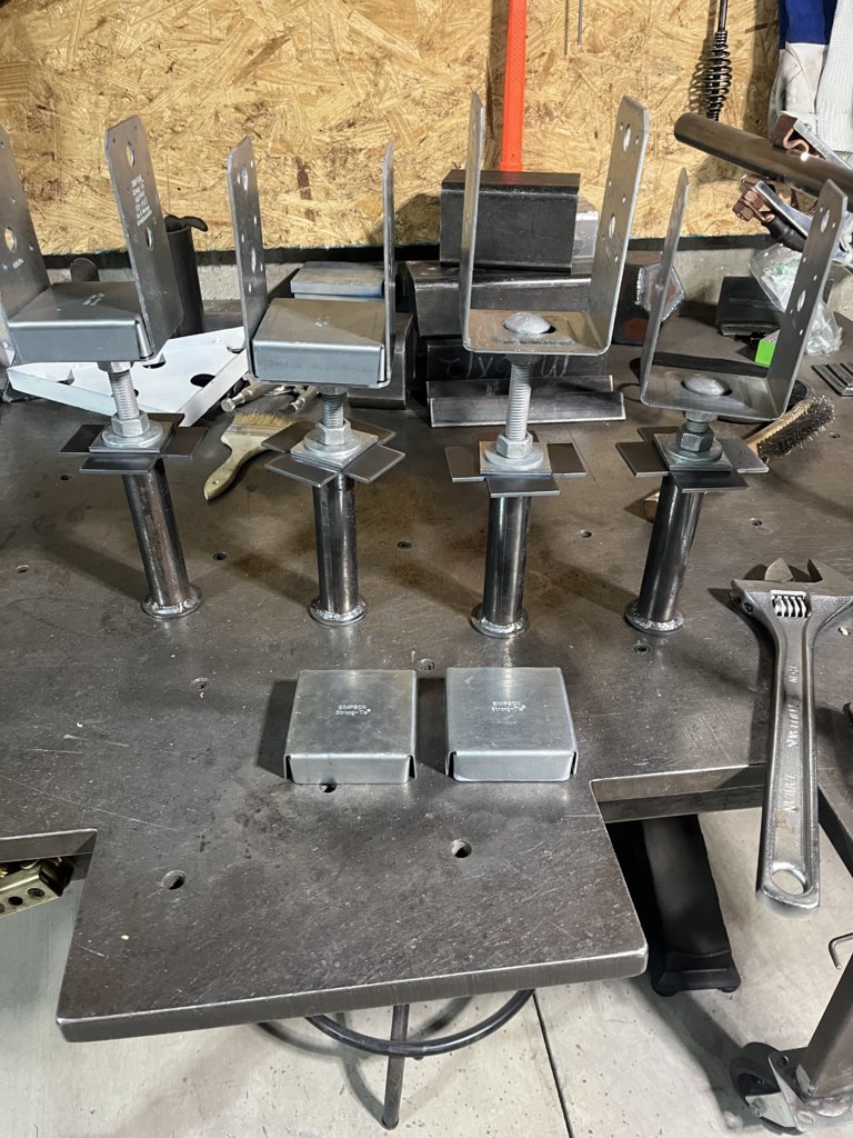

    Simple but very helpful for me. I made some fully adjustable floating foundation anchors for my shed setup. Now for concrete and rebar to set it all once it stops raining. It is a very wet location. I couldn’t dig below the frost line (48”) so I put in 2ft of crushed rock, some flat rock slabs about 4” thick, then railroad ties and 2x12 on top of that for the cinder block tower to rest. The adjustable anchors should allow me to fine tune level and account for any frost heave over the winter.

    Nice job on those adjustable anchors. Haven't seen anything quite like them for residential but they look like they'd work awesome.
